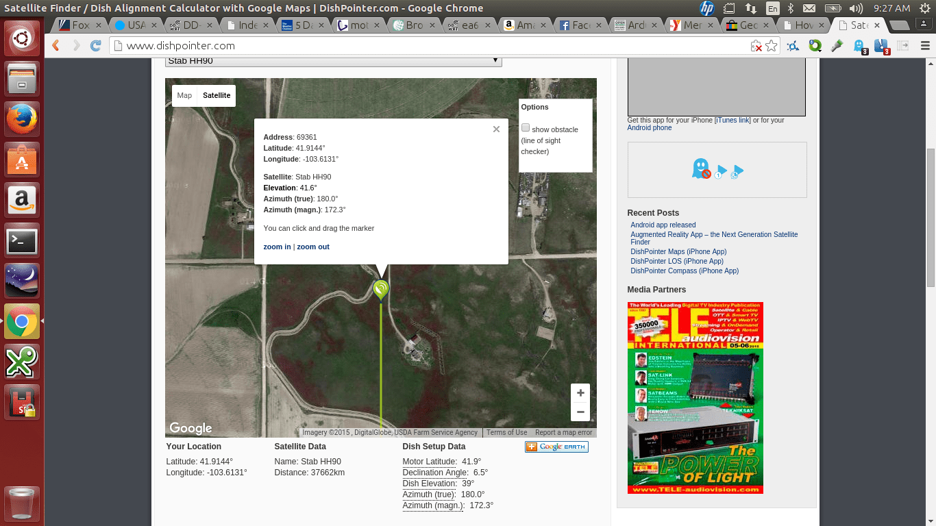

It's been awhile so I need to confirm the adjustments for an HH90 and WS9036 dish. The HH90 has the latitude adjustment and the WS9036 needs the elevation set? I take it that the offset dish doesn't need a declination adjustment? From what I've read, there is no declination adjustment. The declination adjustment must be for a prime focus antenna? The antenna has 2 windows with numbers in it. The numbers on each side don't match so I'm not sure of that adjustment.

I found that thread when looking for clarification on setting up this dish. I thought I had explained my problem clearly but I guess I didn't. I might have to go with your suggestion or experiment in getting the dish aligned. But, if a vendor is going to provide markings for setting up dish elevation they need to make it clear as to how to set the elevation. When you have markings on both sides of the dish that aren't the same, which one do you use for the initial setup? I don't have the original dish manual and can't find a copy on the web so I'm not sure of how to get it set up. To TRY to be clear: my problem is NOT the motor adjustment.
