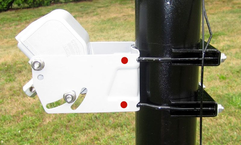

I have two existing C-band poles which are already cemented into the ground, so I wanted to mount my new 90cm dish onto one of them. However, as shipped, the max size pole the mount will fit is 68mm (2.67"). Here's what I did.
Qty=4, 1/4" x 4.5" bolts w/nuts & washers from Lowes.
Qty=2, 3.5" automotive exhaust clamps from Advance Auto.
Bend the bolts as shown. I used a vise and hammer.
I then painted the bolts and clamps exterior gloss black.
When I went to test fit them on the pole I discovered they needed one more small bend as show in the bottom photo.
Make sure the HH90 motor is in place in the bracket before tightening the clamps and don't over-tighten them.
c-band%20pole%20adap-1.jpg~original
90cm%20dish-21a.jpg~original
I really like this! Great Job!
After fine tuning it I found that tightening the clamps has an interesting affect on the mount. As you tighten individual nuts on the clamps it distorts the mounting bracket a tiny bit. Now in my case it worked out great because I found that by tightening or slightly loosening individual nuts on the clamps I could minutely affect the dish alignment and tweak it that last tiny bit. However, if that would be a concern you could eliminate that by drilling through the mount and adding 2 cross bolts to keep the mount from distorting as the clamps are tightened. They wouldn't need to be big bolts, a quarter inch should do.

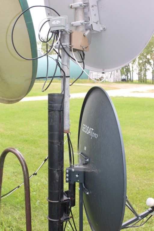

Nice job JeepGuy! I have a 3" pole I mounted the Stab HH120 (1m steel dish) and another stationary 90cm dish to. Since the pole was a bit short I extended it by adding a 2" galvenized water pipe about 2' long to the top and mounted the motor to that. Welded a bracket to the pole for the second stationary dish. Can't find pictures right now though for some reason... might have to take some! (just added one...)

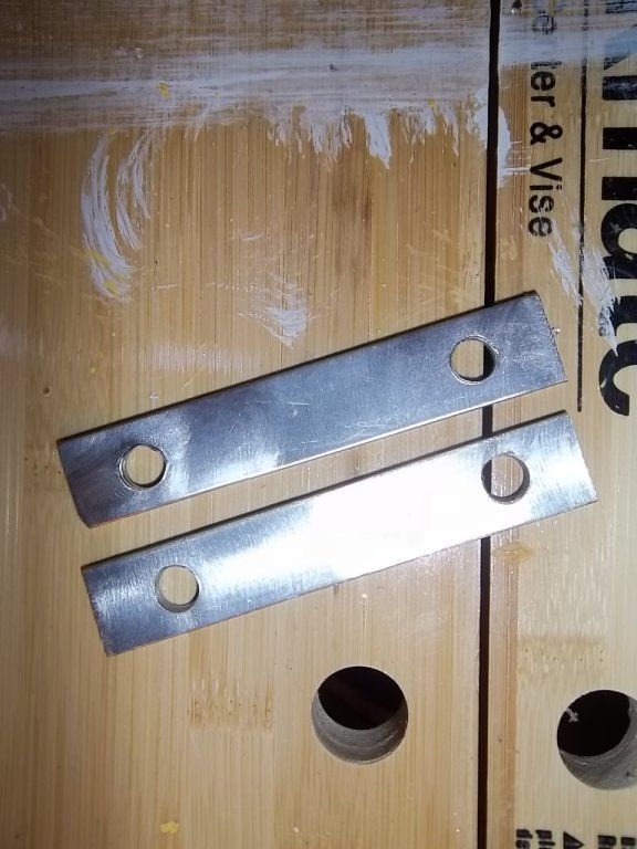

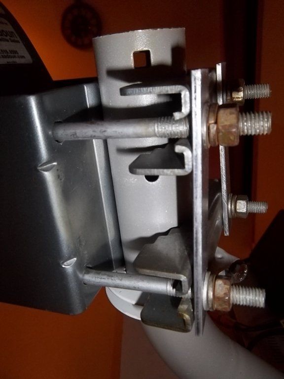

Not sure if it would help but I found by making these spacers, the individual U brackets tend to stay in alignment better.

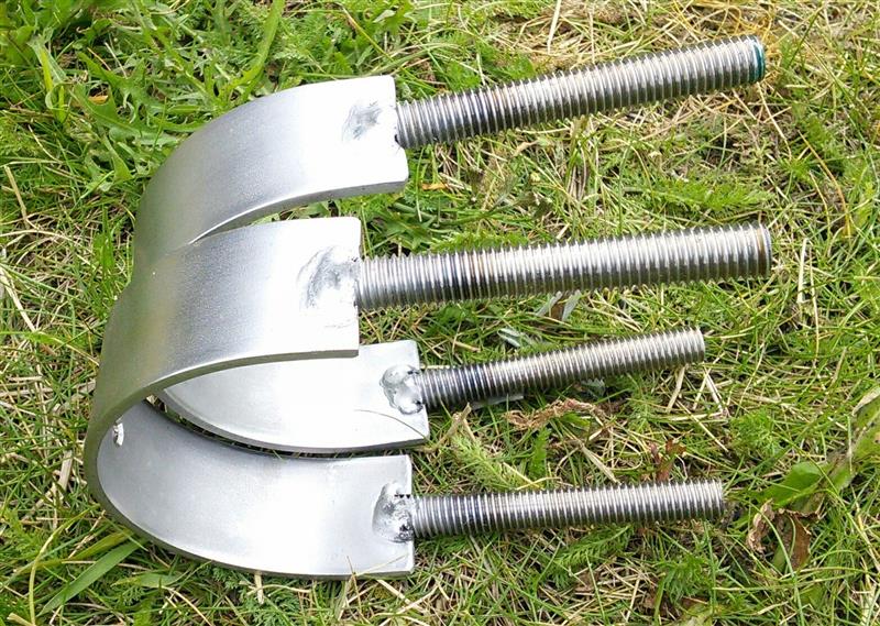

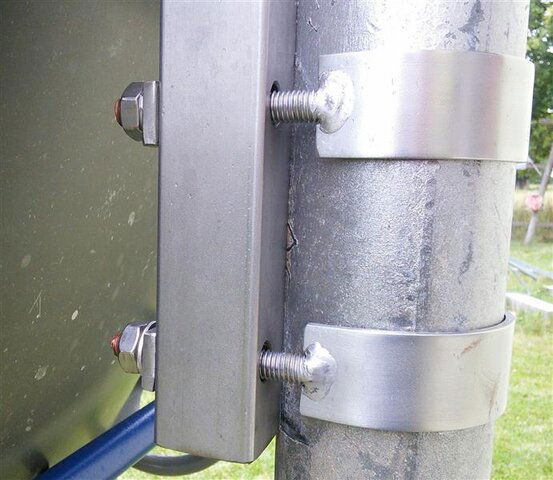

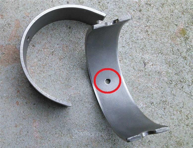

In reality, it is not too hard to make clamps yourselves. Those will not allow antenna turning around the pole. If needed, additional screw can go throw hole in the clamp (circled red) and the main pipe. And, yes, clamps will never rust, as material is INOX :)
IMG_20150728_145126 (Medium).jpg IMG_20150728_161021~2 (Medium).jpg IMG_20150728_162855~2 (Medium).jpg
