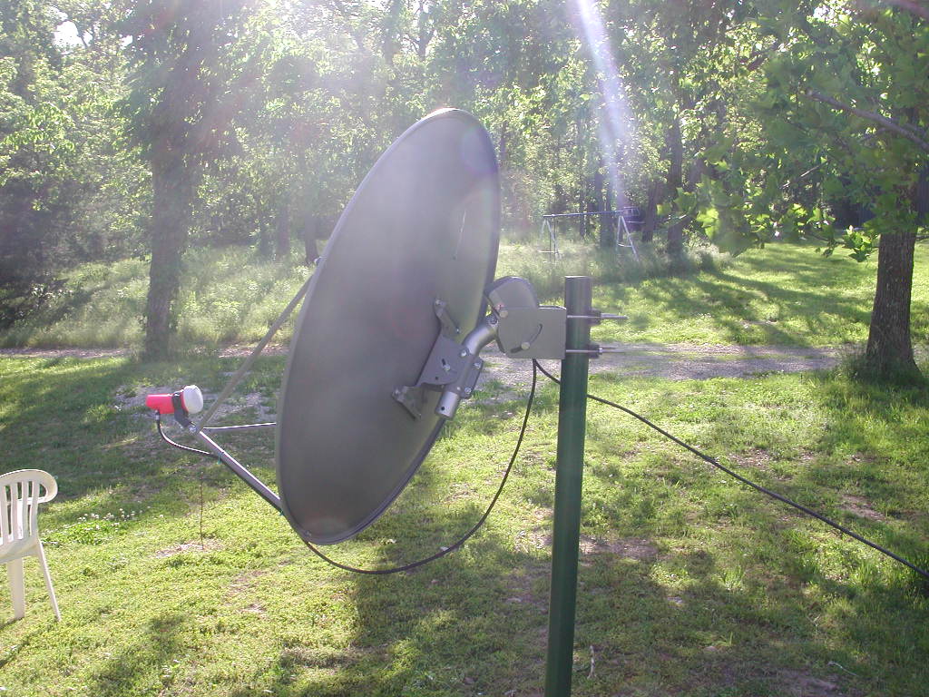

Here's a pic of mine:
nice pic! what size pipe you use? how many feet from ground level is pipe extended?

I believe my pipe is 2 3/8" O.D, 3' below ground, and the motor is mounted about 4' above ground level.

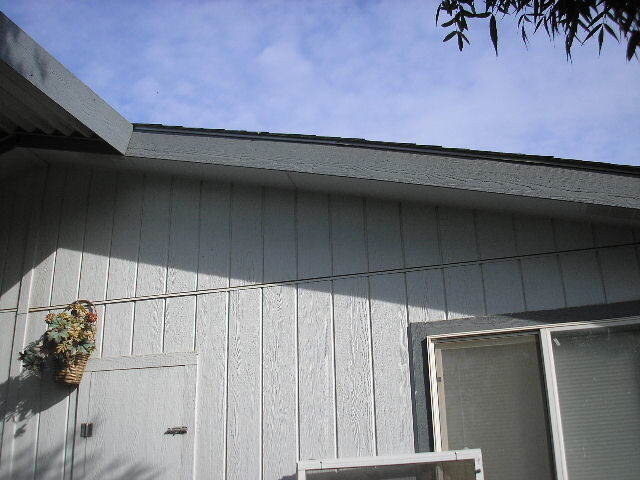

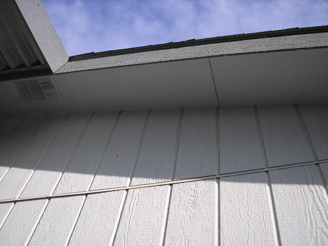

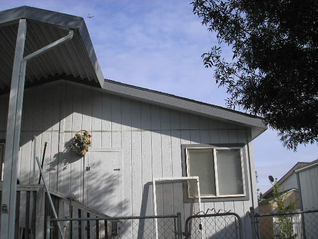

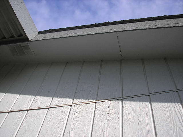

o.k. here are some pics of my mobile home, would like to install between the
water heater door and screen thats sitting side of house.
