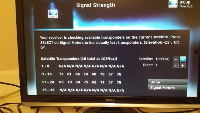

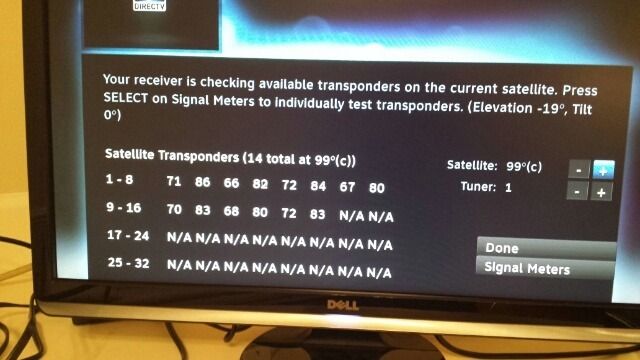

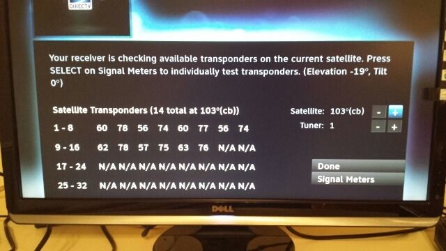

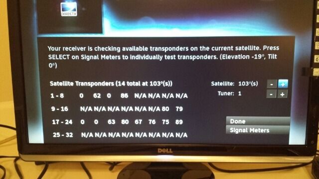

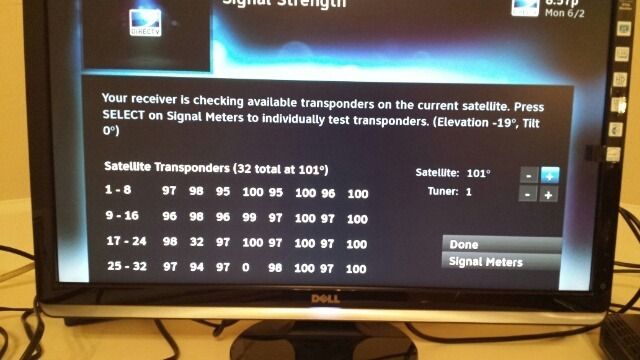

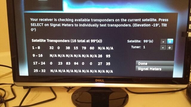

OK I set it all up and have it aligned decently. But my TN locals do not work. Since I would like the major networks how do I get local spots?
Your local sd channels are on 101 transponder 4. Your hd locals are on 99s t 18, 103s t 17 and 103s 18. What are your signal levels on those satellites? Actually, give us the signal levels on all of the satellites and transponders.
At least I must be close. Attached are screen shots of each one. This turned out to be more difficult than I had thought. Un-boxing a house isn't helping. I may have two in twice doing this on a phone is confusing
Good attempt but the dish is pretty far off by standards. If you wanna cheat the set a the Genie to sat 10 3a tp11 on signal meters and tweak that to 95. That should get you a lot closer to point. But without a meter you can't dither properly.
