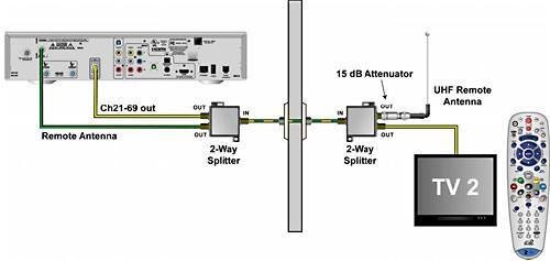

Make sure the splitter is installed properly (coax from wall to IN, antenna on 1 OUT, TV coax on the other.) Also, using an attenuator on the antenna can help to reduce interference.
Here's a diagram:
If you're using diplexers it will work as well. Just place the "IN" of each splitter on the "UHF" side of each diplexer.
