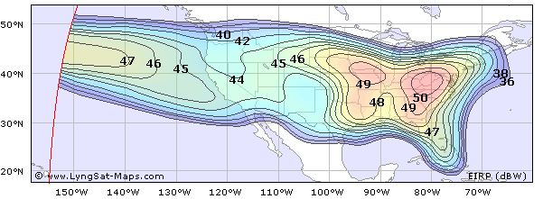

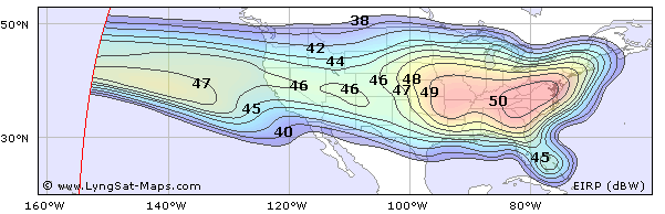

from the looks of the maps, yes it could be an issue for both of us.
1st pic is H polarity and 2nd is V...note the numbers. The lower the number the bigger the dish
The V here in Minnesota dang near cuts off at Minneapolis
