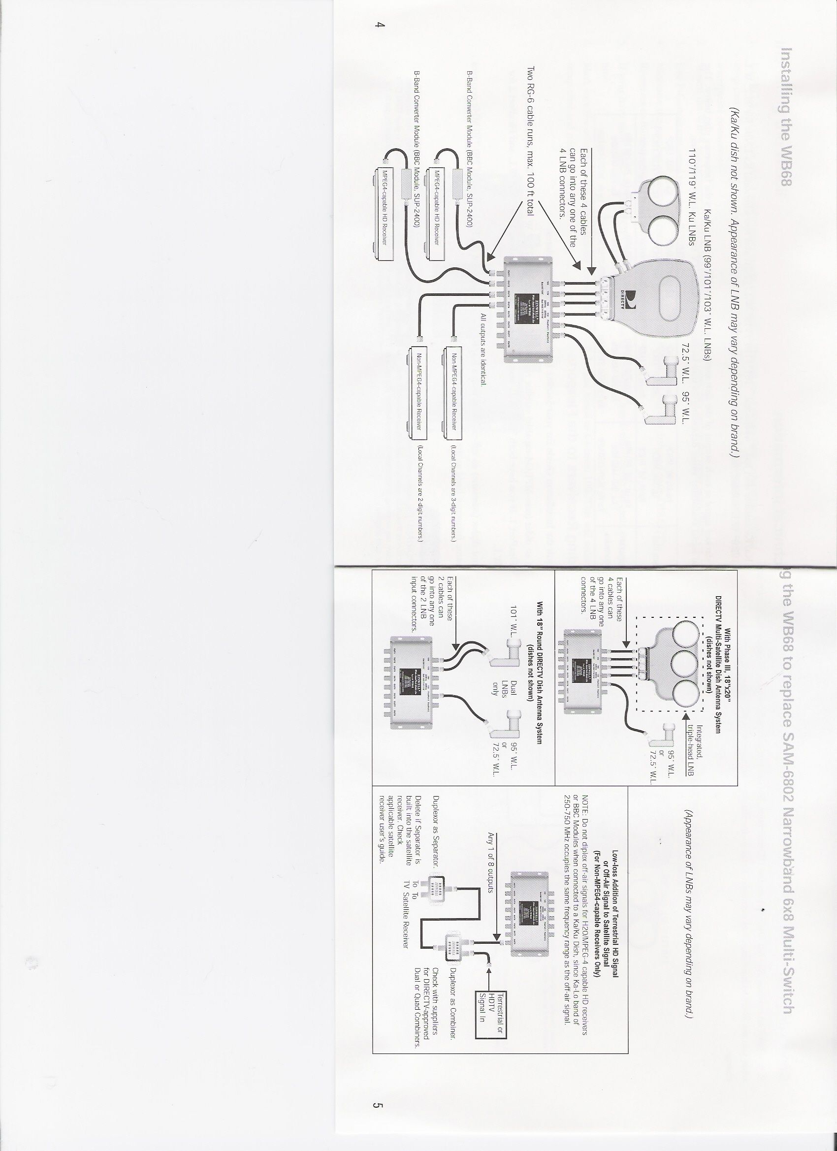

I install the zinwell 6x8 rated for the ka ku bandwith everyday. It does not need to have a power suppy hooked up. It has 6 inputs 4ports for 18 13 18 13 and two flex ports for the 95 and 72.5 sats. and 8 outputs. The four ports need to have lines from the oval3 or 5lnb dish going to them to work properly. the two flex ports don't need anything in them. just leave the plastic caps on. it can be installed outdoors but i wouldnt recommend it. if you do have to i would make sure to use some di-electric grease and tighten the fittings good. be careful not to over tighten because you can break the switch. I would say hand tight and a 1/4 turn of a wrench
Okay, I yield to the man with experience. But can you tell me why it has one if you don't need it?
it doent come wtih one maybe it is buit in and gets its power from the reciever. give me a few and ill go grab one and look into it
No, you're right, I'm wrong. I was looking at the wrong switch when I said that. The WB68 is powered by the receivers. Sorry for the confusion.
(I HATE when that happens):rolleyes:
here are some scans from the installation guide
Thanks, that clears up a couple of other questions I had in the back of my mind.
Appreciate your trouble.
no problem. ran out to my van for one and it made me realize what a nice day it is and that i shouldnt be wasting it inside
