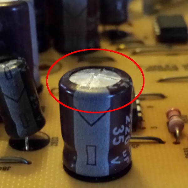

This is how they act when the capacitors start to go bad. If you open the lid, I bet you'll see some bulged caps.
