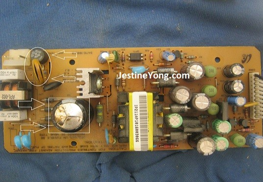

I can show how to find the exact bad caps, and teach you how to replace without removing the main board from the receiver I used to repair 5-10 C-band receivers a week and get them from all over the US it beat working outside 99% is common sense when its bad caps, which is 75% of repairs

I'm bad at doing it that way unless you open the receiver up and take very high-quality pictures of everything you see You're asking a doctor to operate on your body without seeing X-rays first, let's see what you have.
Don't do it as an attachment, use the insert image, go very high resolution
, with a flash, or take it outside in full sunlight, I must see discoloration of the parts heat marks on the board even dust, all are clues it's like looking at footprints, knowing what to look for.
DO YOU HAVE THIS BOARD IN YOURS?

Well, when your eyes can not see it, you use logic most caps near heat sources die first they dry out not always show signs of being bad.
So while the unit is under power and you see it dead or acting up by not doing what its supposed to do you trick it.
With heat and with cold,
if you don't have a good heat gun with a narrow tip use a hair dryer around the heat sink areas, about 3 seconds then wait another 15 seconds if needed unplug power reboot it may come back to life or the bad function work again for a minute then die as the device cools down
but that is with dry caps, what about shorted ones or even shorted transistors or chips well then the same trick can work on all parts with cold spray cheap cold spray can be made by taking dust cleaner turn the can upside down once you freeze the whole board wait 30 seconds if it comes back great also reboot great
now in either case if you got something working divide the board in half to find out which side has the issue, the divide again in the end you may need to even use a solder iron to heat the cap or a wand of cold spray to narrow down the exact part this trick works on cold solder joints too but there is one more trick
The trick is pressure if you have a bad solder joint use plastic or wood and press on the board if it comes back to life press less until you barley touch the part and it kicks back to life
I have fixed a lot of crap without knowing what is in it
another trick on a dead unit is to put a ohm meter on the power cord it should never read fully open or shorted open look for fuses, many times they don't look like fuses a short means a bad bad diode bridge or diode in the power supply check each diode one is shorted
Now how to replace a bad part with muti layer boards without unsoldering the part because the odds it will never work you must cut it apart and leave the wires from the part intack and solder a new part to what is left connected to the board
