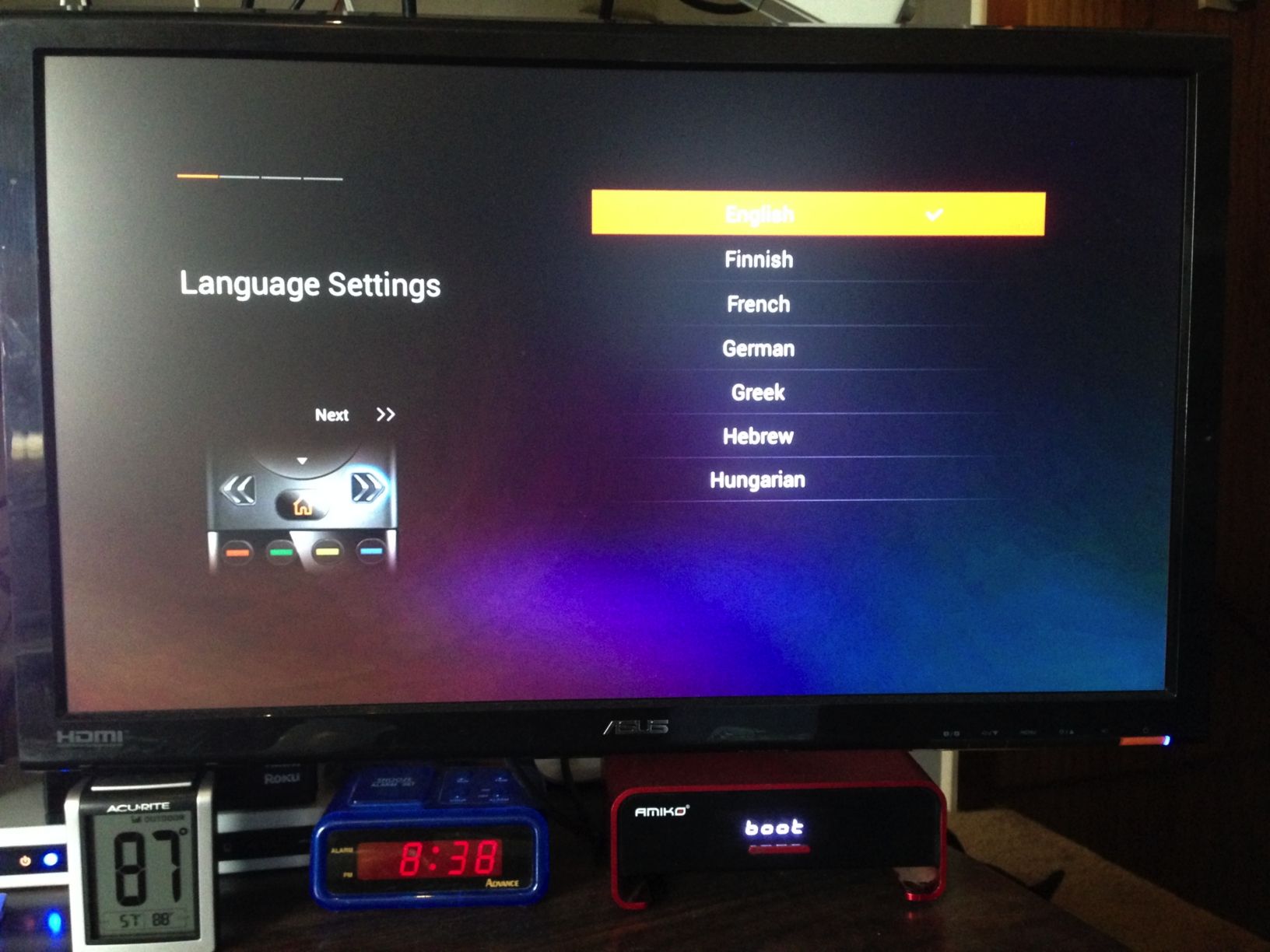

It's been flashing a message on screen for a few weeks that said something about an update, it was extremely poor grammar so obviously a non English speaking person had crafted the message.
I've just been ignoring it.
This morning I was trying to use a type up a grocery list on it and it was misbehaving in odd ways, menus weren't displaying properly things were overlapping, icons were massive, filling the screen like they were zoomed in to full screen.
So I used the remote to try and just do a reset but it didn't ask, it just powered down. As it powered down it kept flashing a message saying media had been removed, it flashed it on and off rapidly about 8-10 times. It took about a minute to power down, the LED display was off but the TV screen was still showing things on it.
When I powered it up it hung on the "boot" screen for about 10 minutes. I finally pulled the power cord because it was non-responsive. I waited 60 seconds and plugged it back in. Same thing again.
Pulled the power cord again. Waited. Plugged it back in. The TV went black for about 2 minutes then it started to show the boot screen and then it came up with the freaking setup screen.
Once again it has, all of it's own accord and without me doing ANYTHING to it, it has downloaded and installed the bloody European ROM update.
Now I am going to have to go back and do that whole complicated recovery process all over again.
The question I have now is this, how can I lock this stupid thing from self-updating and to NEVER, EVER go to the freaking European sites again?
What are the websites, server addresses, IP addresses, etc. that it contacts to get those European things?
If you can tell me what they are I can block them in my router so it can never contact those sites again.
This is extremely annoying. I've had quite a bit of rotten luck with the A3 and I'm growing quite weary of this.

Now that you are running the current firmware, download and run the EuroTrash app from the Dev app. All firmware updates now come from the one Europe source then run the EuroTrash app to make it North American region friendly.
Reinstall your satellite/channel list if needed.

The A3 does not auto update firmware. :)
Apps may auto update but you can turn that off, just like any other Android Device.
EuroTrash version V0.4: http://www.fridgefta.info/forums/showthread.php?tid=36101#axzz3YpPaaDMb
Many SatelliteGuys and FridgeFTA members like myself, own an A3. My my support email inbox would be full, Ebay and Amazon ratings destroyed and there would be a firestorm of forum posts if other A3 customers were having this reoccurring problem. I run two A3 24/7 and never have experienced an unapproved update. Not saying it doesn't happen, but we are not hearing of a reoccurring unapproved update issue from other owners. Maybe contact Amiko Americas for advice on setting-up your A3 in a unique way to ignore factory notices or disable the ability to IP update?
As mentioned to you several times before, if you feel that the unit has issues, RMA the unit to Amiko Americas. If you are frustrated with your A3 and don't want to deal with it, sell it. From the pages of complaints that you have written about your experiences, I would suggest that you should consider admitting defeat in trying to tame your A3, cut bait and run! :(
