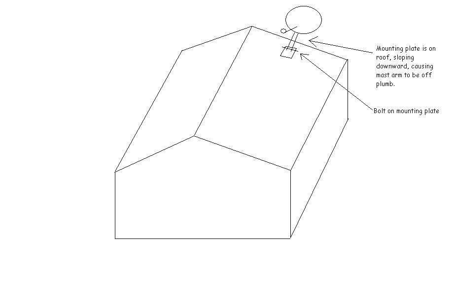

Dish 1000 Mast isn't plumb - need help!
It turns out the mast is NOT plumb. It was leaning to far forward in the direction the dish was pointing, which meant the elevation had to be increased to hit the bird. That was easy to fix as I loosened the bolt in the plate connecting to the roof and pushed it back. The more challenging problem is that it's leaning too far to the left (if you're looking from behind the dish). I am now plumb on the side that I could manipulate the mast backward & forward, but if I move the level 90 degrees around the mast, it is not plumb. The attached picture shows this. So, I attempted to work around this issue to see what happened. I tried and tried to get lock on 110 & 119, but couldn't even get those two at the same time. I tried following the advice above and peaked 119, then tried to slightly move (up/down, left/right, skew up/down) to catch 110, but I could only get one or the other, not both. I assume this is a skew issue since I can see each individually, but not together. I'd like to at least get the mast to plumb, then start over with a 119 peak.
I have 3 questions...
Should the skew be over or under stated to account for being off plumb? How do I calculate the amount of the over/under?
Is there any other way I can adjust the mast to compensate for the lean to the left? Should I unscrew the mounting plate and reposition it so that the longer side points the direction of the slope of the roof? The downsloping roof faces east, and the dish is facing south.
I was using transponder 13 to point - which transponder is the best for each Sat (my location is 43113)? Does it matter?
Thanks for any info!

If they did this when they installed the dish I would call them back.. but if you want to do it that is okay too. Do as ypou mentioned, reposition the Dish mount for it is sloping with the roof. Before you set any screws just take a second and make sure the the mast will go plumb level. Then set the dish back to the scew and elevation that was originally set andgo from there.

Tune off the 129, its your weakest signal, but if your 110 is that off then the skew is most likely wrong or there is an obstruction of the 110 path. Tuning through each lnbf is a rooky mistake and does very very little to make things better, it would only help if you had an individual dish for each satellite. As it is your install needs to be redone, there needs to be drip loops at the dish, the point of entry, at the ground block ( if there is even a ground block ) and slack at the receiver for obvious reasons.

Well, I finally got it figured out. I re-oriented the mounting plate to point with the elevation of the roof, and adjusted it to plumb. I re-dialed the dish to the prescribed skew and elevation, and sat it on the now plumb mast. I found 119 without too much trouble and peaked it out. I played with the elevation and even tweaked skew a bit to max it out at about 101. It was cloudy as storms have been moving through, so I think that is a pretty good signal. I played around a bit trying to find 110 until I realized I should have run a check switch. As soon as I ran the check switch, BINGO! All 3 birds were showing OK! I tweaked a bit more to bring 129 up from 59 to about 79. 110 is about the same now.

I did have one other question - When I tightened down the mounting clamp all the way, it pulled it slightly off plumb. I loosened one side slightly and that allowed it back into plumb. Is there a good way to "prop" up one side of the clamp? I was thinking maybe put a steel washer, or some other piece of something under that side so I can tighthen down the mast, but not pull it out of plumb.

Kelton, something like a steel washer should be okay. I've used door shims before. Just be sure that the screw or lag bolts are are setting good if you are backing them out and retightening them. Also be sure that you are using some type of sealant around the screws... After you get it plumb, that may help the 110.. you'll probably lose a little on the 129 but as VAN said your current 78 is very good but the 110 should be a tad higher

Normally when you tighten the satellite J mount it should not tilt left or right (horizontally). If you have that problem as someone said use washers between the screw and the mount and not the roof. The J mount you can move up and down to adjust for almost any angle on a roof. This has to be plumb.
