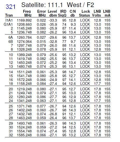

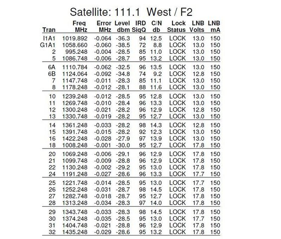

My SL1 PLL results thanks to the AI tubro S2

76cm WG dish
SL1
DMS 321
Nice! Interesting choice of Satellite.
Sweet meter! I am jealous! Need to upgrade my Super Buddy to the Ai Turbo!
What LNBF are you going to benchmark test?
