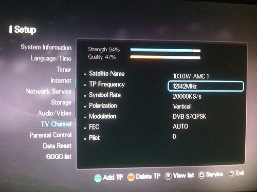

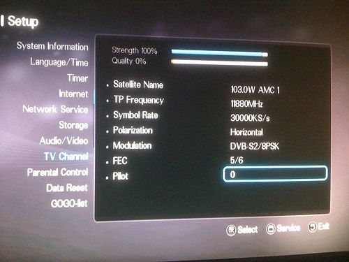

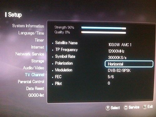

Below are pictures of my settings on the AZBOX.

When I tune those S2 signals, the signal strength is good, but the quality sort of rolls between very good and zero, a slow roll, where it will stay good for several seconds, then go to zero for a few seconds, slowly up, slowly down, up, down. I can receive most of the regular DVB-S transponders with the non-adjustable lnbf, but these S2 signals are severely affected by the skew.
Yup I am able to get some quality reading on it now of 52% however like you it keeps going to 0 then comes back on again.
