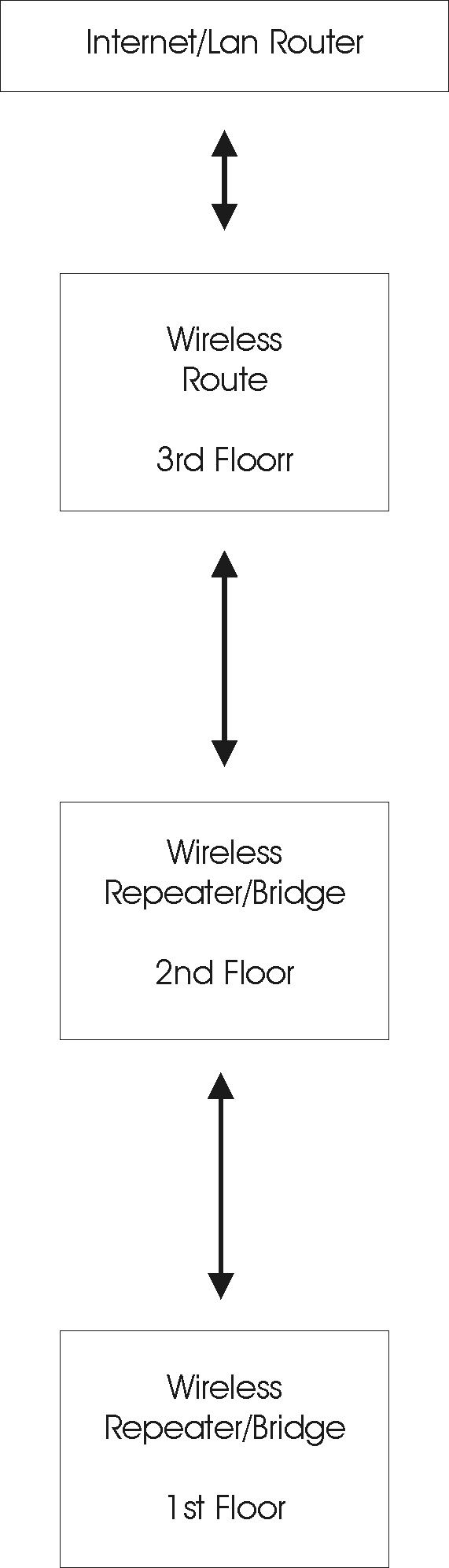

Looking to replace my current setup and am looking for recommendations. There are so many wireless routers our there now I'm not sure what might be the best solution. I'm looking for a dual-band N solution as my current G solution just can't handle any streaming. I'm in a 3 story townhouse with my internet connection coming in on the 3rd floor. I currently using Buffalo Wireless G routers and repeaters to pump a signal through all 3 floors (using WDS) as shown in the attached diagram. Any suggestions on the best replacement option for this setup? Thanks for any input anyone can give.

I would strongly recommend you pick up 2 or 3 AirPort Extremes. There are a couple of other threads on here about them. My wireless speeds went up 10x when I switched.
+2 on the Airport Extreme Solution.
I have a 3200 sq ft house, on three levels, with the cable modem and network junction box in the basement (surrounded by basement like cement walls). I have the main Airport extreme there, powering the wired network, and the wireless network. On the main floor, I have a second Airport Extreme in Wireless Extend Network mode (its not even connected to ethernet, it picks up the network and sends it out again). That reaches the rest of the house, and does so in a way where I have pretty much full bandwidth. I can get as much as 30-35MB downloads on speedtest connected to the network on the main floor. I could never do that before.
If you want more - and don't care about 5GHz connections, throw in an Airport express somewhere in the house. I actually keep my second extreme in my entertainment center, right next to my Apple TV and Dish DVR.
IF you go this route, the key is to manually set the channel on the main extreme, and then replicate that exact setting on the second one. IF they are on auto, you will end up with the same SSID splitting channels, and I found that I would sporadically lost connectivity (there is a thread about this buried somewhere from last summer). With them both on manual settings, its one seamless network, and has not had a dropped connection in oh, I guess the 6 or 7 months since I set it up. Its NOT a cheap network, but it works extremely well, it is fast, and for people like me who just don't want to worry about my network, and don't want to do the equivalent of putting a custom rom on it, its a great solution.
I also run a wireless utility called Air Radar on my mac. It shows me that I am currently seeing 11 other Wi-Fi networks from my living room. Six of which are on 2.4Ghz channel 6, a handful on 11 and a handful on 10. I have mine set to channel 4 and channel 153; and its the only one on that channel. Indeed, Air Radar sees version copies of my SSID, one for each Airport, and one on each channel. I basically blanket the house with these. And it works great. The program shows my signal strength as a % of max, and on the main floor Airport, I see 80%. It drops to under 50% for the main router, with the 2.4GHz stronger. To be honest I pretty much never run this program any more, as I don't need to - the network is flawless.

WDS is cutting your bandwidth in half every time it is used. So if you are using it twice then you are really killing it.
Here's a nice AP I use. I don't use it as router but it looks like it can be used as one. The range of this thing slaughters any other router out there. But one thing you do have to keep in mind is you can have a crazy strong 1000mw router upstairs but if your laptop isn't strong enough to penetrate up to the third floor then the AP will not be able to "hear" your laptop. Is there any way to run a wire downstairs to directly connect to another AP?
Amazon.com: Ubiquiti Ultra-Long Range WiFi Router PowerAPN: Electronics
I can tell you this router is probably the most powerful residential router I've used. I believe it pumps out 600mw due to US regs. Compare that to your regular Linksys, Netgear, Buffalo, etc that pump out between 40-60mw.
