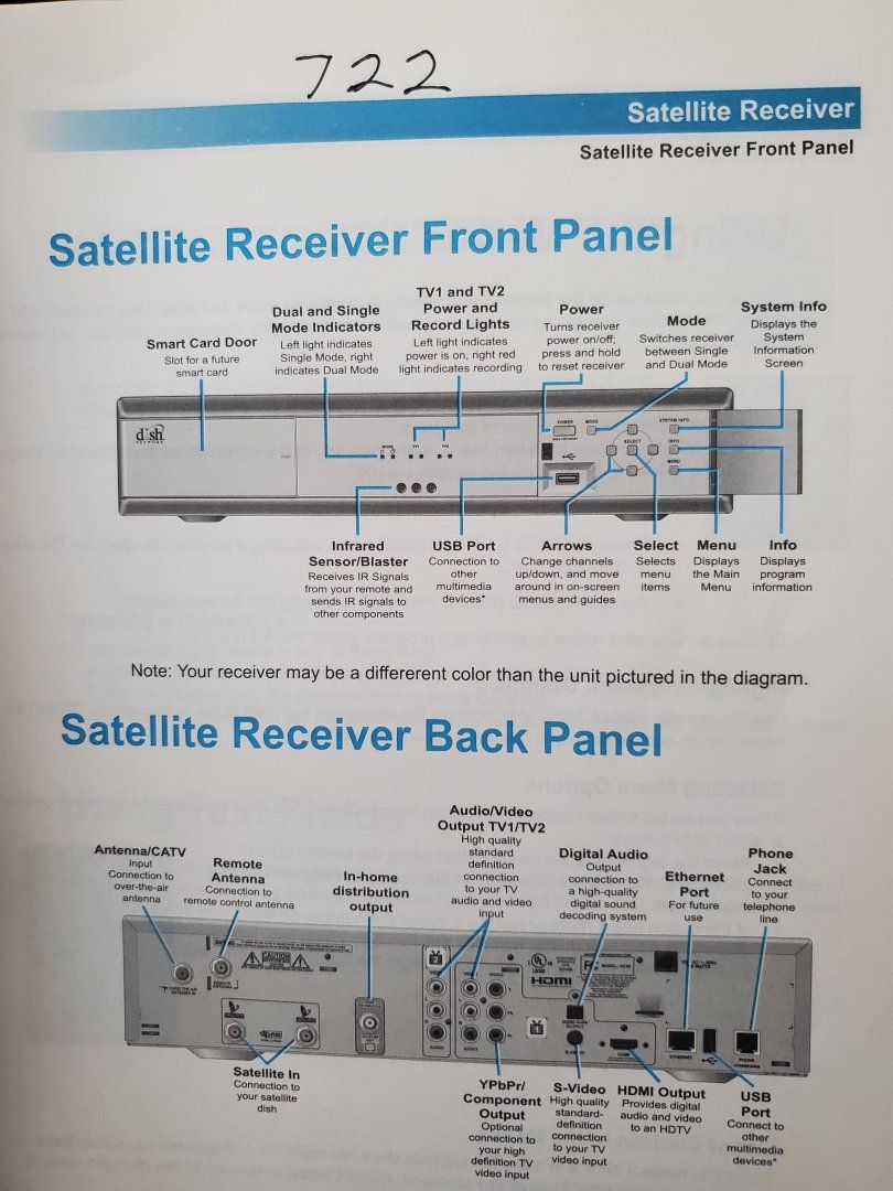

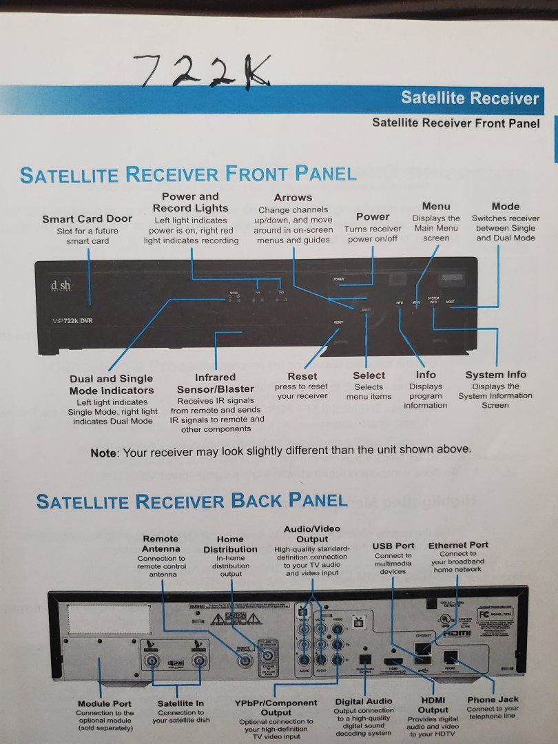

TheKrell I don't recall 722s having a channel 3 output. Both 722 and 722k have a Home Distribution coax out port. With the MT2 OTA Module added to the 722k provides an OTA coax input and a TV1 CH 3-4 coax out port.
You appear to be right. It took me awhile but I found this:
TV1/TV2 stereo Agile modulated output (channels 21-69 (Air) or 73-125 (Cable)).
And to make matters worse, I never saw a good picture (at least not up two floors) on that so-called home distribution output. Noisy as hell.
