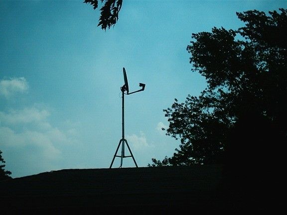

I just want to understand if there are "creative" solutions out there that can help my situation. The fact that you have a installed a 8 foot pole mounted in a tripod gives me some hope. Do you have any pictures that you can share of how it is installed and the exact placement of the tripod? Do you think installation with a pole can go higher than 8 feet? 10 feet?
Well, that's where it gets problematic. At this point, most tripod installs are considered custom work...and as such, are custom pay situations. A lot of DNS installers won't touch them. My recommendation is to call up a local retailer. For starters, he can probably get to you much faster for the initial install; not to mention most handle custom work.
I'll have to dig around on my spare (AKA, my son's) computer to find a picture of an install I did with a 6 foot pole on a tripod...mounted at the peak of a roof. Granted, it may not give you the full representation of what you're asking for, but it does show there are "creative solutions.
Good luck...!
EDIT!! Not the best picture...but definitely one of a 6 footer on a tripod
