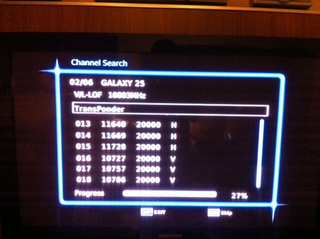

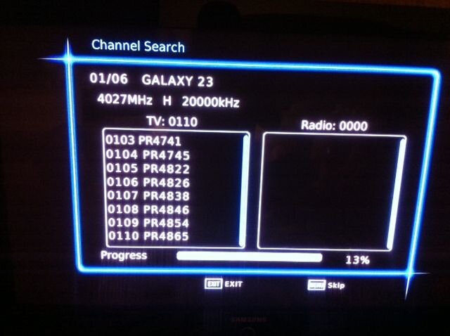

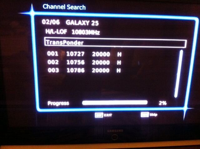

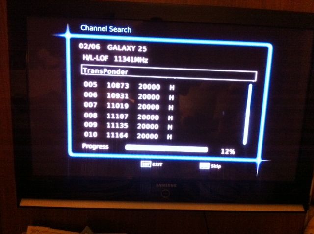

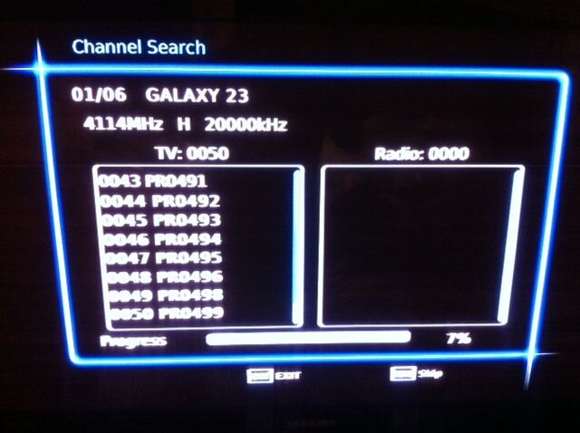

see some screen shots from last night receiver search. it shows the transponders and channels. last was 3432 channels and no radio. i could not view the channels though? not because they are scrambled or anything, but simply the scanned channels has no signals? is that possible?
I will give that receiver another shot this weekend ad if it does not cooperate :) i will just let me in-laws take it back since it would work back home for them.

If a DP LNBF is scanned using the wrong setting in the receiver's installation menu, this will be the result. The receiver has scanned the same channels 4 times. All scanned channels are from an encrypted satellite, probably Dish Network.
You don't need to buy a new receiver. Yours will work just fine for receiving 97w. Just need the correct settings in the menus and a larger dish with your LNBF and aimed correctly.
1. How did you determine that the dish is properly aimed at Galaxy 19 satellite? If you just hooked-up and scanned, the dish was likely properly aimed for the Dish Network satellites and not for G19.
2. What is the LNB LO setting? It looks like it is not correctly set to be used with a DP LNBF. I guess that the setting in the installation menu is set to Universal 9750/10600? Try 11250 instead and only scan the horizontal polarity.
3. How is the correct LNBF selected from the three units mounted on the DP dish? The receiver installation menu has a DiSEqC switch setting menu. Off the top of my head, I don't remember the correct setting for selecting each of the three LNBFs. Maybe another member could suggest the correct DiSEqC setting for this dish.
Bottom line.... The receiver is working. Get a 75 -90cm dish with your universal LNBF and you will soon be watching Galaxy 19. :D

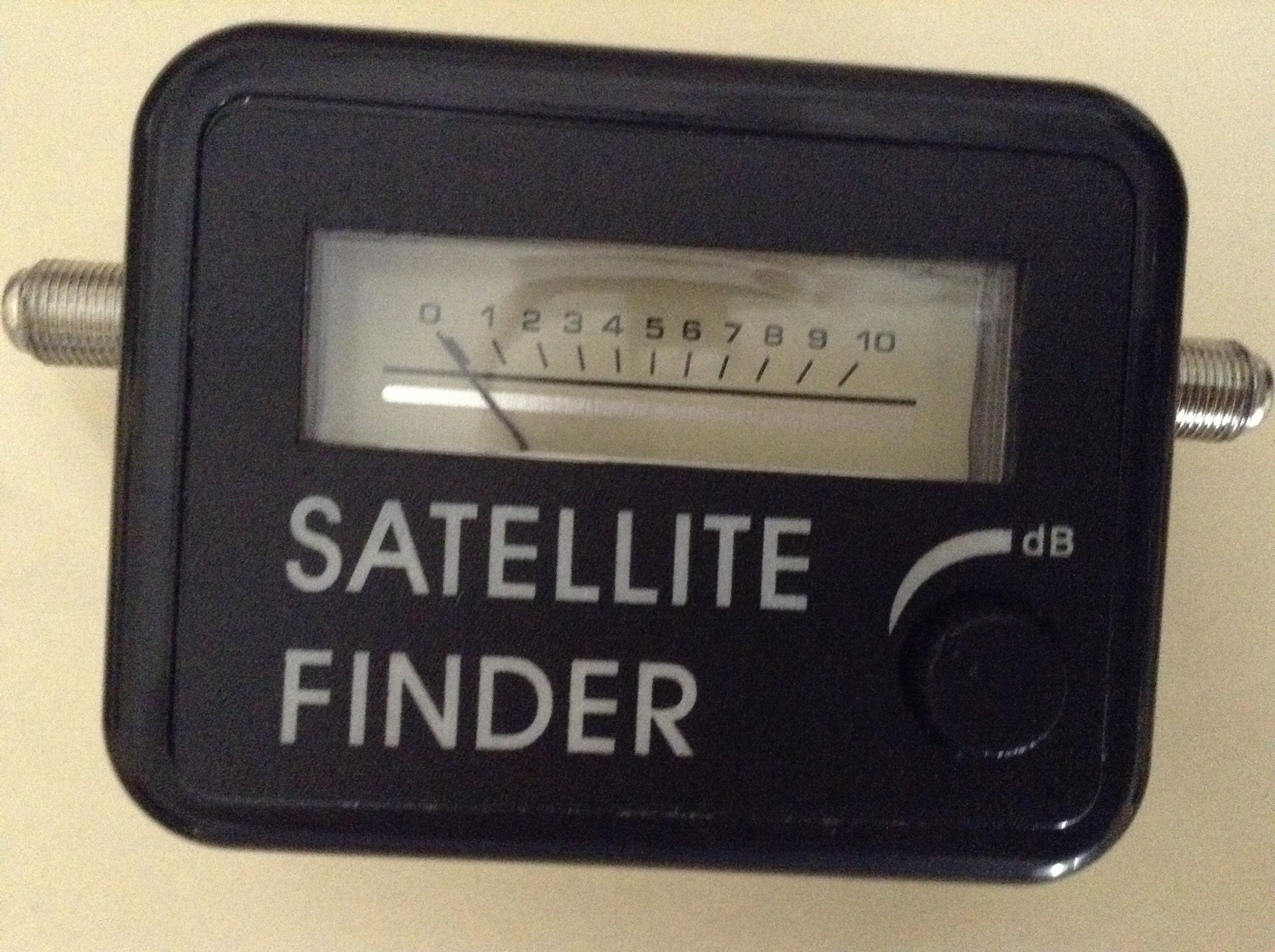

What satellite meter are you using?

The meter i used is a cheap one like i have seen on the net, see below.

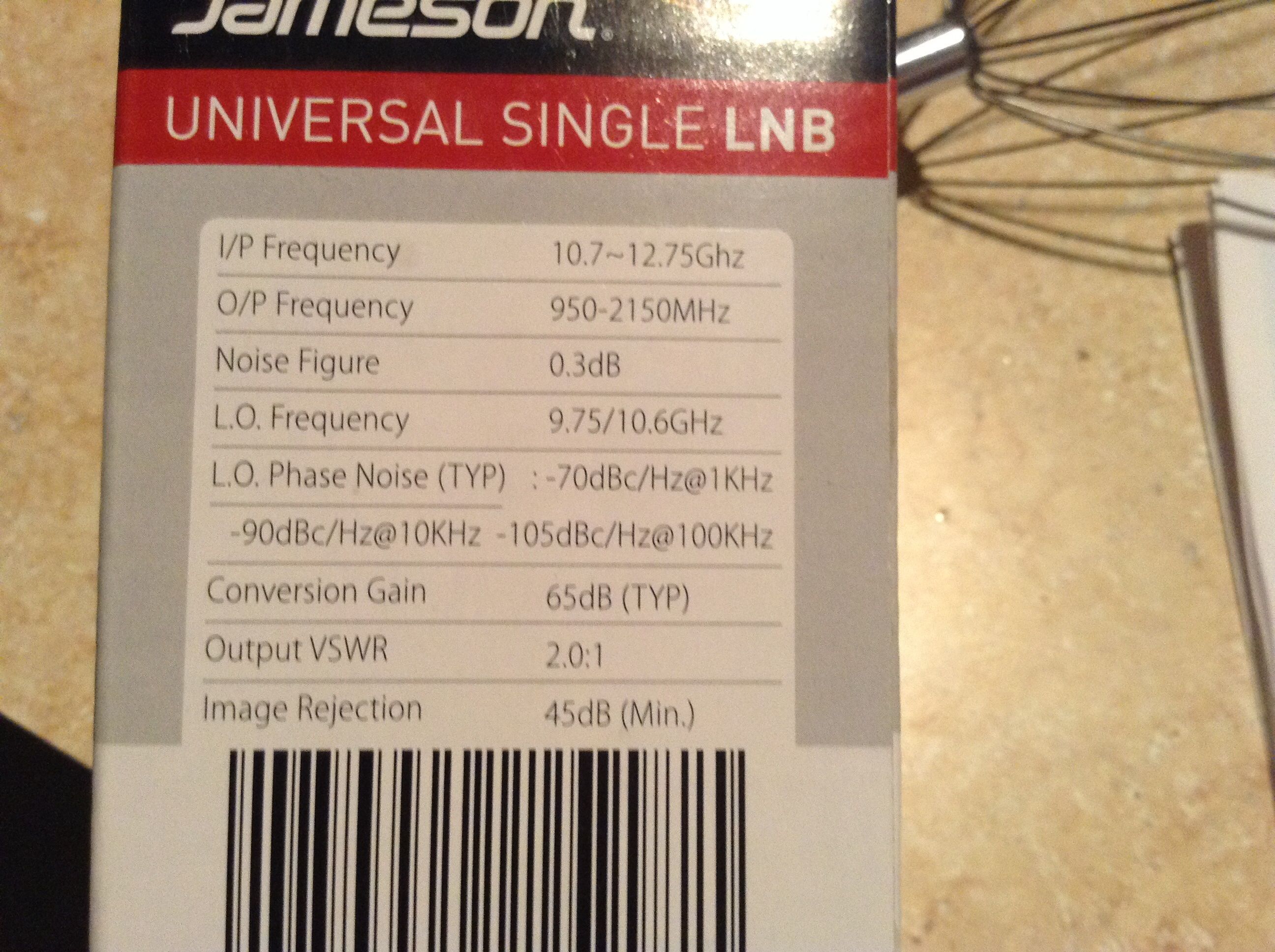

Any satellite will provide a signal on that meter. A signal reading on that meter only indicates that you are aimed at something that produces RF. This could be a satellite or even a light bulb!
To identify the satellite, an active transponder must entered into the receiver and the correct LNB LO frequency selected (matching the connected LNBF). A Signal Quality reading on the receiver will usually indicate that the dish is aimed at the correct satellite.
