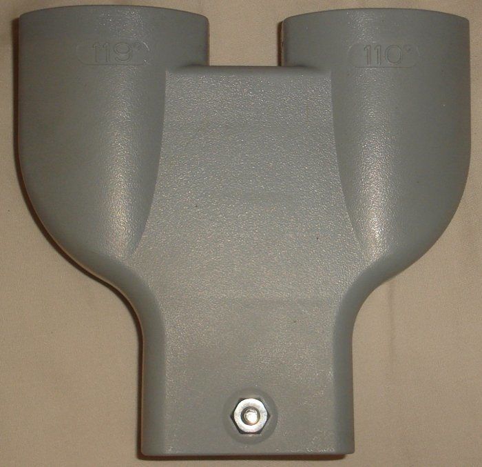

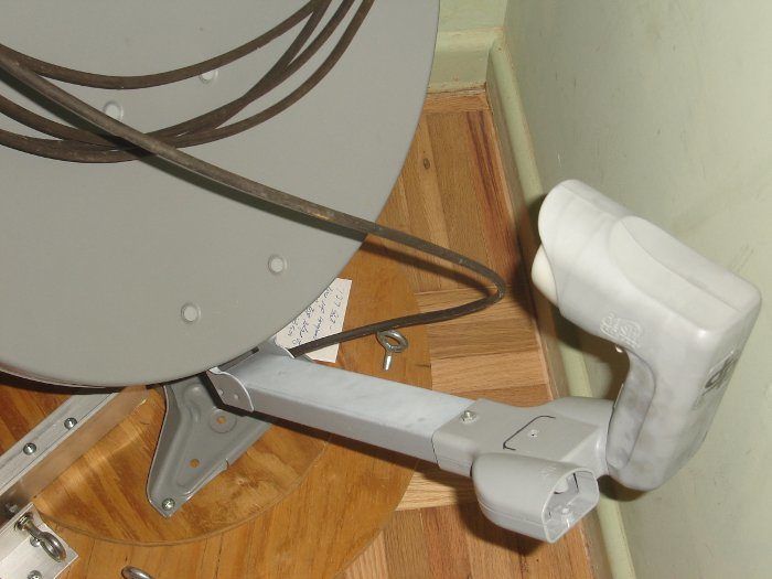

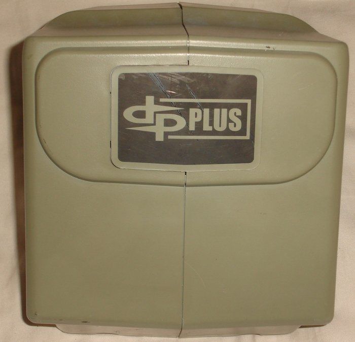

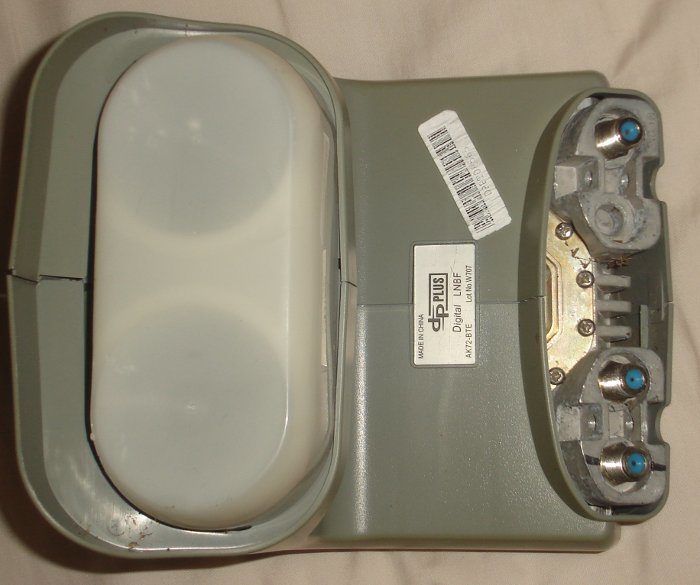

Hi, here are some pictures to help you see what is needed to receive two satellites from one dish. Boba, are two cables needed on the 722 if only one TV is going to be used at the cabin? I do not have a 722 but when I had a VIP 222 I found it would work with just one cable. The second receiver would not - unless I hooked up a splitter. Then both would work with just one cable. Anyhow for portable operations I like to keep things simple. I just use my Dish 500 with the single DPPro LNB as shown in the picture. I set it up on 72.7W and get all my HD but I only have the AT 120 HD package. Other packages may have some of the HD on 61.5. Just check thelist link at the top of the page to find out. Hope this helps, DC Edit - I do not get my locals when I use the single LNB, they are on 61.5.
