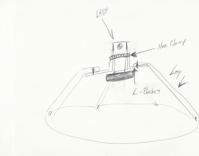

>Four "L" brackets and a hose clamp?
Im not sure I follow you.

Here is a quick hand drawing showing L brackets mounted on the 4 LNBF arms with a hose clamp securing the LNBF feedhorn to the L brackets.
Make any sense?
Sorry about the rough sketch, but no good drawing programs on my Linux OS computer.
