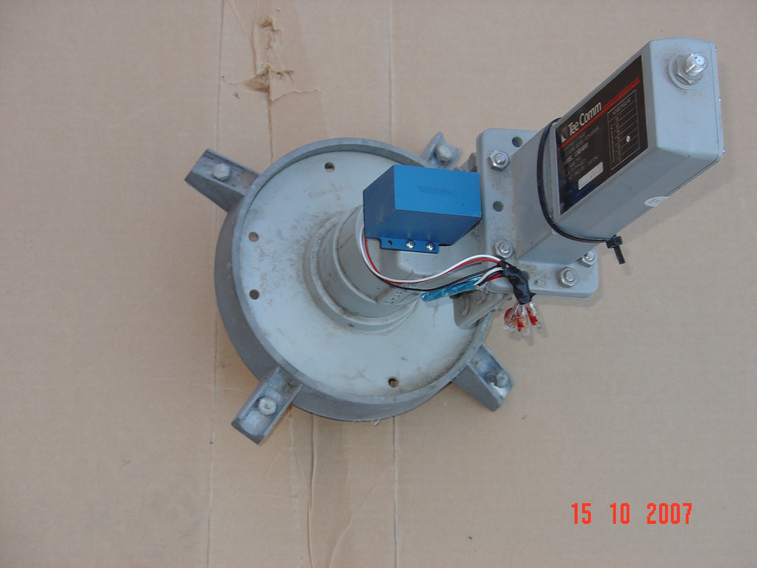

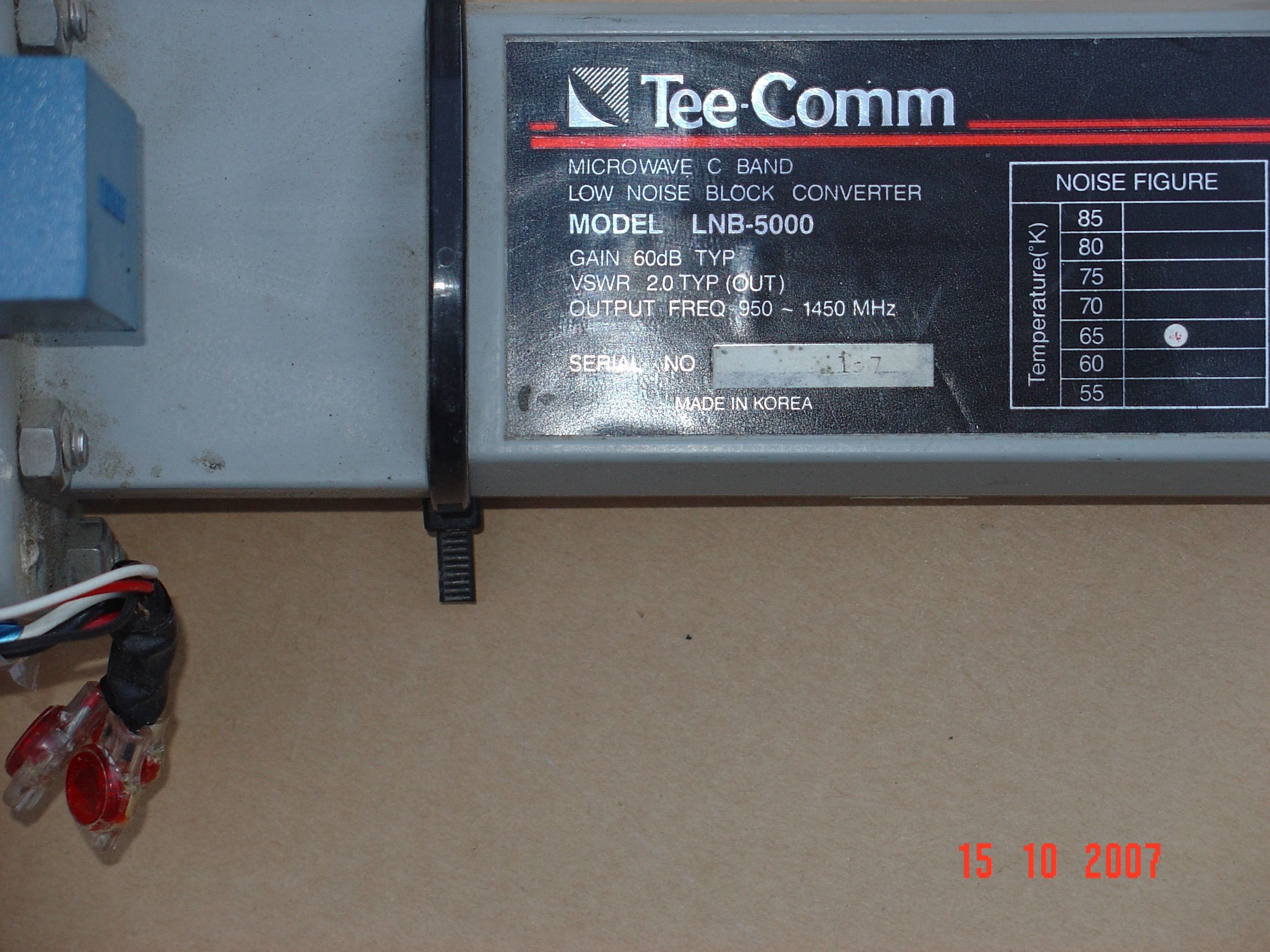

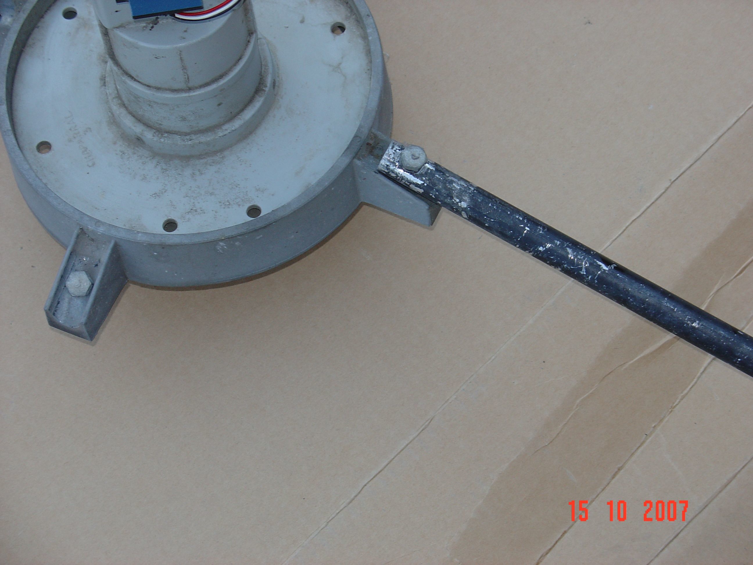

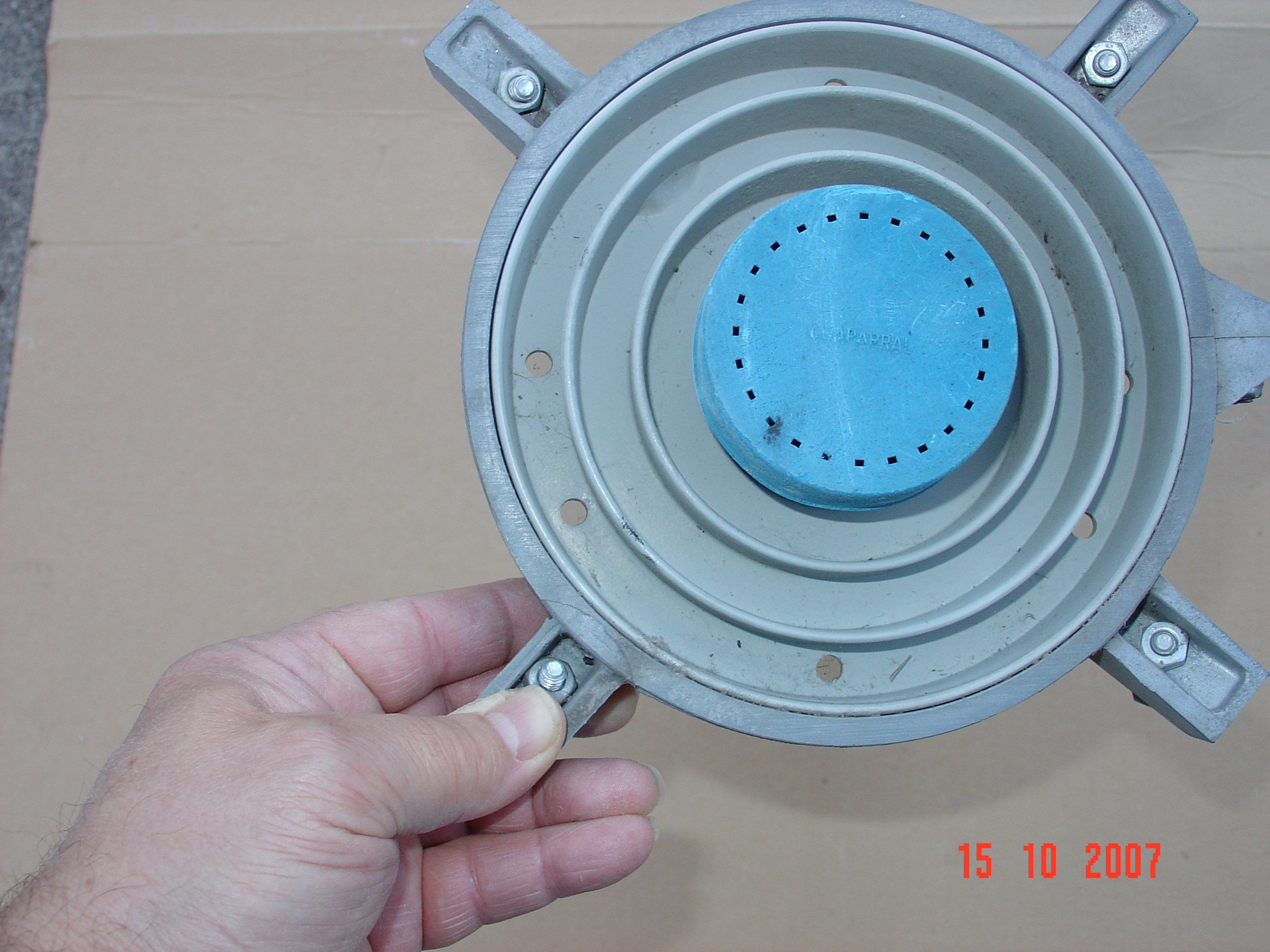

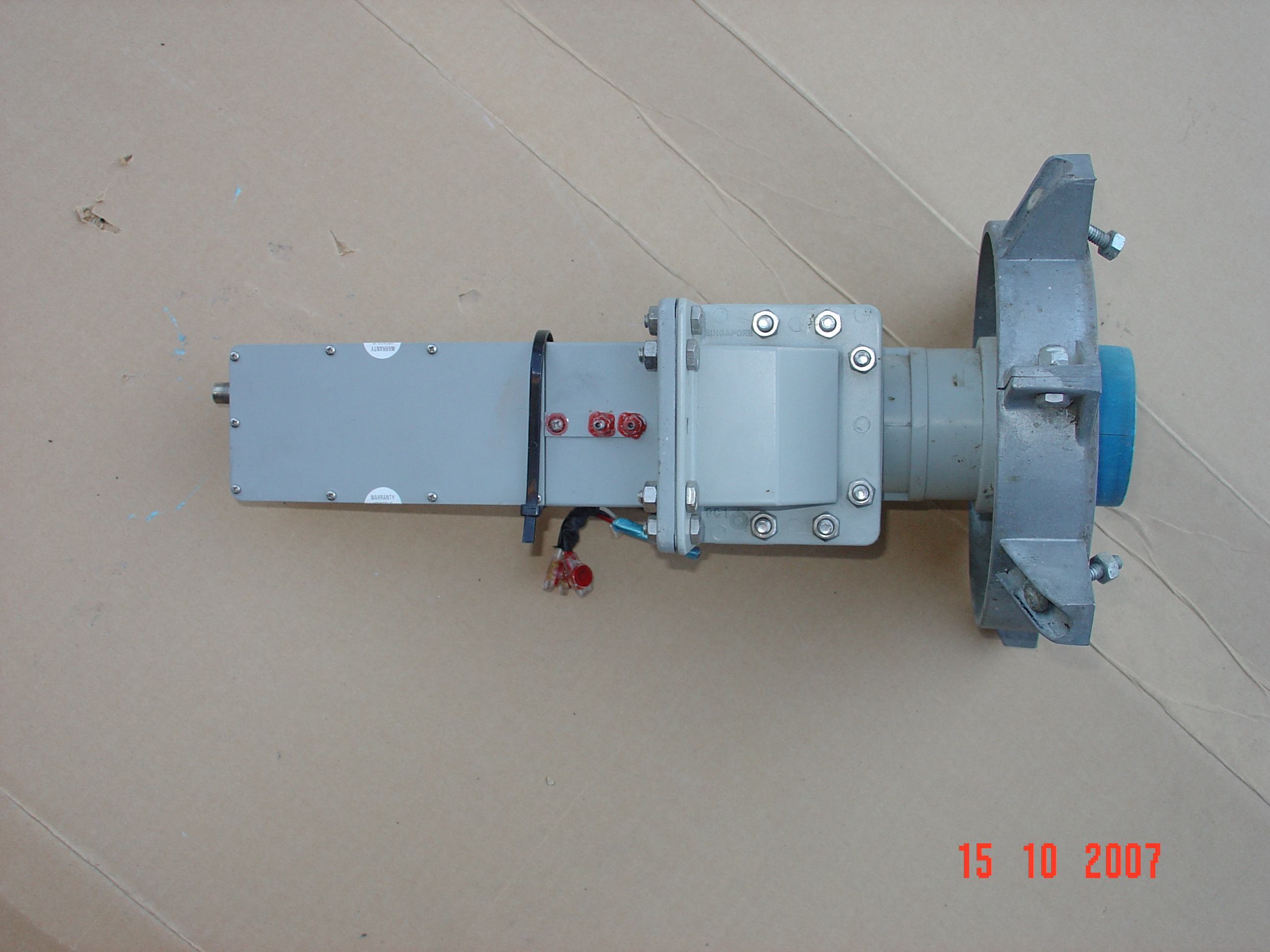

Well as per gabshere's suggestions finally got the pictures of the LNB and Scaler? Looks like lumpkin666 may be right - I'm not so sure that my setup will fit the BSC 621 -2 or any of the new LNB's!
Please see attached with T Com LNB Top and Bottom views. Pic # 3 shows the only way I figure how the Pole Mounts to the LNB. The 4th Pic shows the existing Tee-Comm LNB which I guess is of no use now? The Last pic shows the back view of the LNB.
Do these pics limit my LNB setup to the Corotor II plus? Can the Corotor II plus be adapted to my setup?? Or what LNB can I use because of my Poles -which are NOT Flat at the end for the LNB??

Can you take the LNB out of the scaler rings and measure the hole? I know my 621 and old LNB need a bigger hole to fit inside the scaler rings than my ASC421
Those arms to hold the lNB should still work fine. You might need some different screws to hold it together or when in doubt just drill new ones :)
Thanks very much for the reply Iceberg. Yes there is a Bolt and Screw that is locking together the clamp / frame that holds the existing Chaparal unit with Tee-Com LNB. Looks like if I undo this Clamp the whole unit will fall out. Chaparal is stamped on the unit and underneath there is a plastic like Blue Cap that comes off and inside is a shaft with a kind of a hook at the end. The Frame is approx 6.5 inches in diameter.
Does this mean a Corotor II or BSC621 will work with this Frame for my existing Dish Poles?? Then I can get an LNB for this setup??
IceBerg, undid the 7/16 inch Bolt and Screw- (you can see it in my last pic) and the whole Chaparal & Tee-Com LNB unit fell out. Great stuff! That collar (which fits my Dish Poles) is 7 inches in diameter while the Chaparal & Tee-Com LNB unit are about 6.75 inches in diameter. Wonder what kind of options are available here? Can the Tee-Comm LNB Be replaced with another LNB: ie Norsat, Corotor II, or BSC621-2C?
