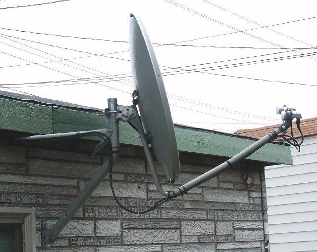

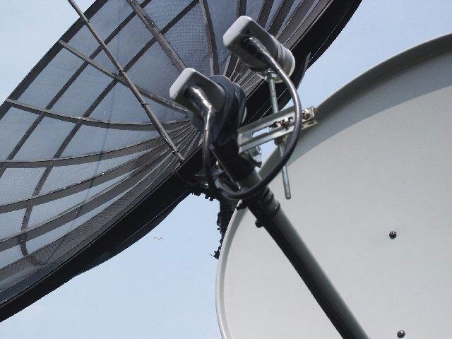

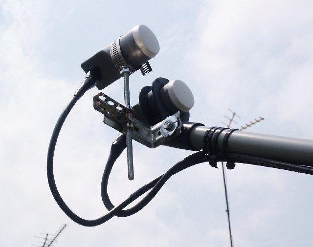

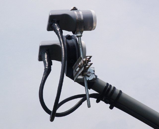

Pictures Of Finished Job
Here is the finished product.:D The center LNB is on G-10R the one to the side is G-27.

Very nice fabrication and modifcation. Has all possible adjustments covered very well.
Thanks for the photos.
You have to have all the angles covered, it's the only way to fly.
Thanks's to all for all there input and support.:)
