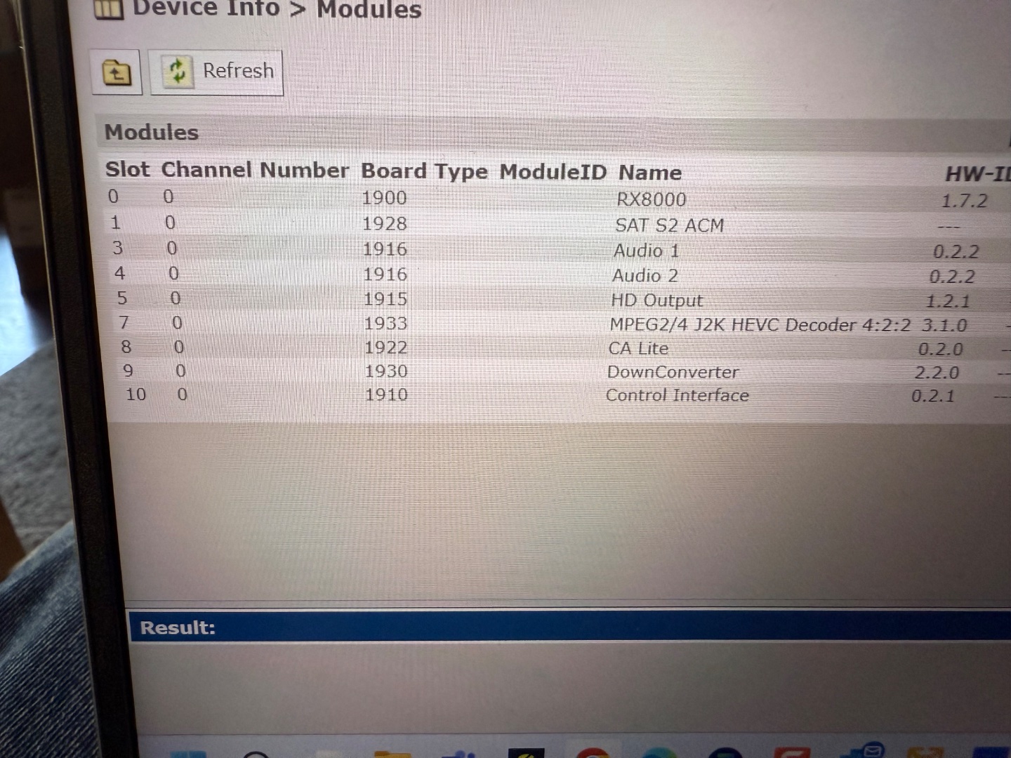

The swapped-out RX-8200 arrived today. It's playing the HEVC 4:2:2 CBS muxes on 93 and 97 just fine, but not ABC on 99. Is there something funky about ABC on 99?
You need a special Sat S2X video board to lock DVB-S2X signals. A majority of the ones on eBay that have the licenses for it have the wrong board.
Page 5 will show you how to check.
Well crap, we have a license but don't even have the board. Is it possible to buy the board somewhere?

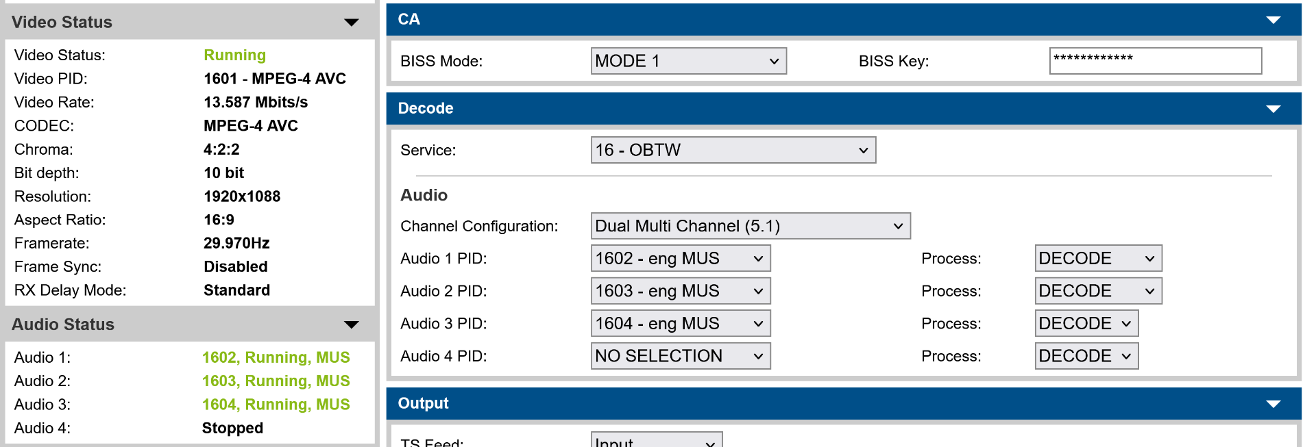

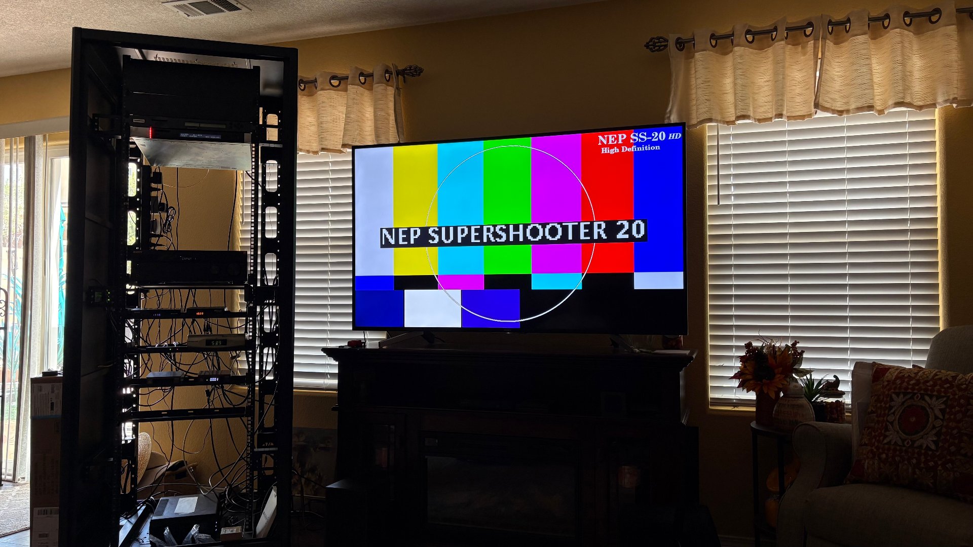

Quick update on the 4:2:2 front. We acquired an Ericsson RX8200 from Ebay. It can directly display 4:2:2 on the TV using SDI output, fed into a cheap HDMI converter from Amazon.
Currently it's licensed for MPEG-2 and h.264 MPEG-4 only, but it is capable of HEVC h.265 4:2:2 decoding. It is fun to be able to display 4:2:2 "on the big screen!"

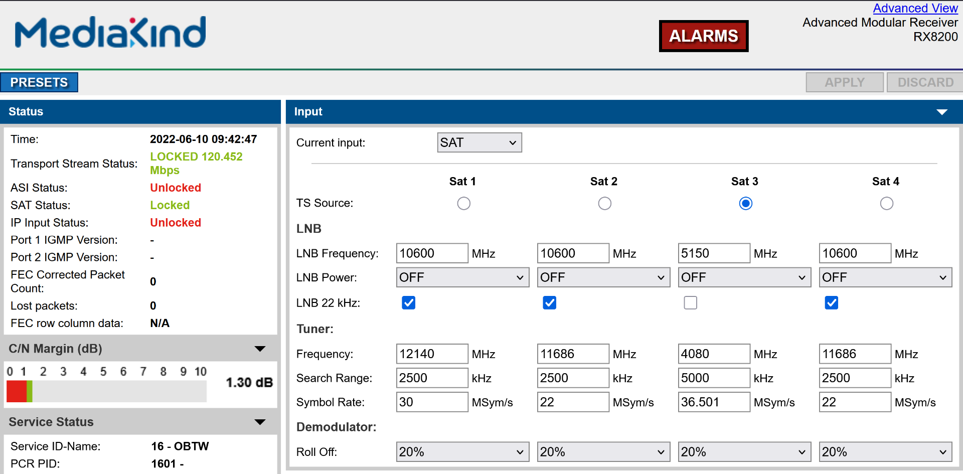

There are endless options on this receiver. Here are screenshots of the dashboard and photos of the receiver displaying the women's golf tournament from Portland. Source is two 16APSK muxes on 89 C-band.
The receiver has 4 inputs, so you can have KU and C-band side-by side.
Email all the sellers of this receiver on Ebay, and ask them to check the receiver they are selling for the board. If they have a receiver with one, buy it. You can always sell your present receiver.

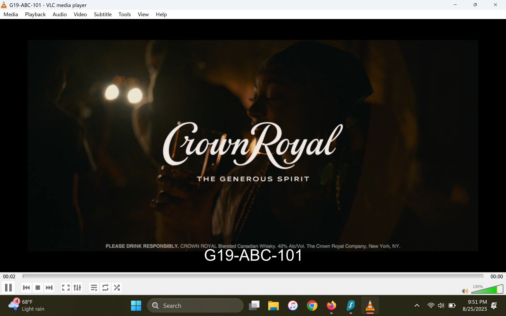

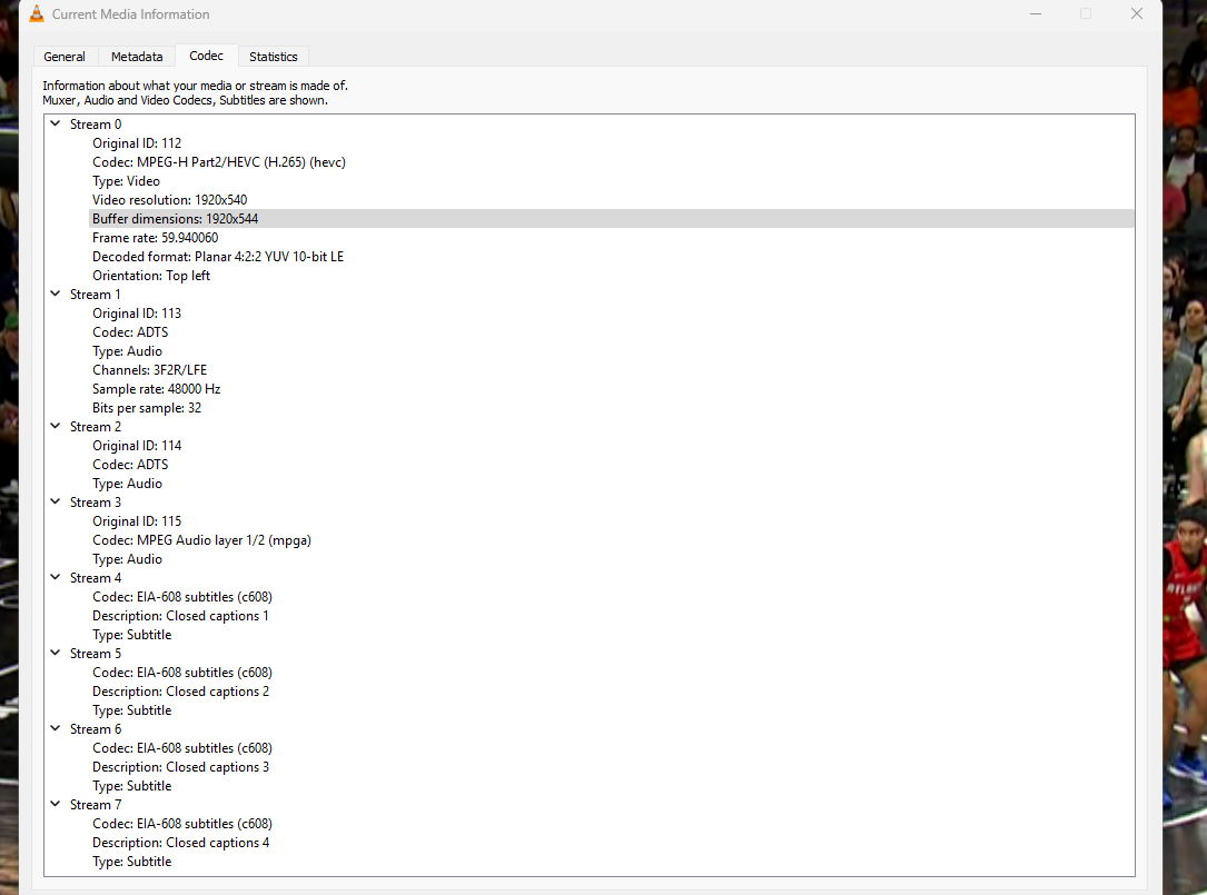

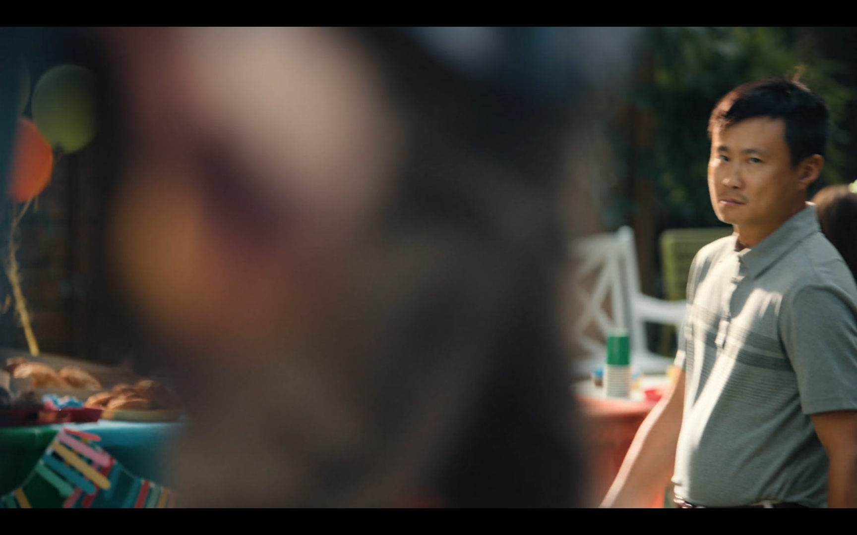

Last night I used my Edision OS Mini 4K to stream the ABC 4:2:2 DVB-S2X HEVC muxes to my laptop connected to TV via HDMI. The picture quality is quite lossy even when hardwired to the switch, but it's watchable.
...The picture quality is quite lossy even when hardwired to the switch, but it's watchable.
Does the video play smoothly? I've not noticed anything negative when playing 4:2:2 this way, but I don't think I've actually tried this using the ABC channels. The result of playing 4:2:2 this way just looks clear as a bell to me.
output the video from your laptop to your TV and see if the image still appears grainy or normal

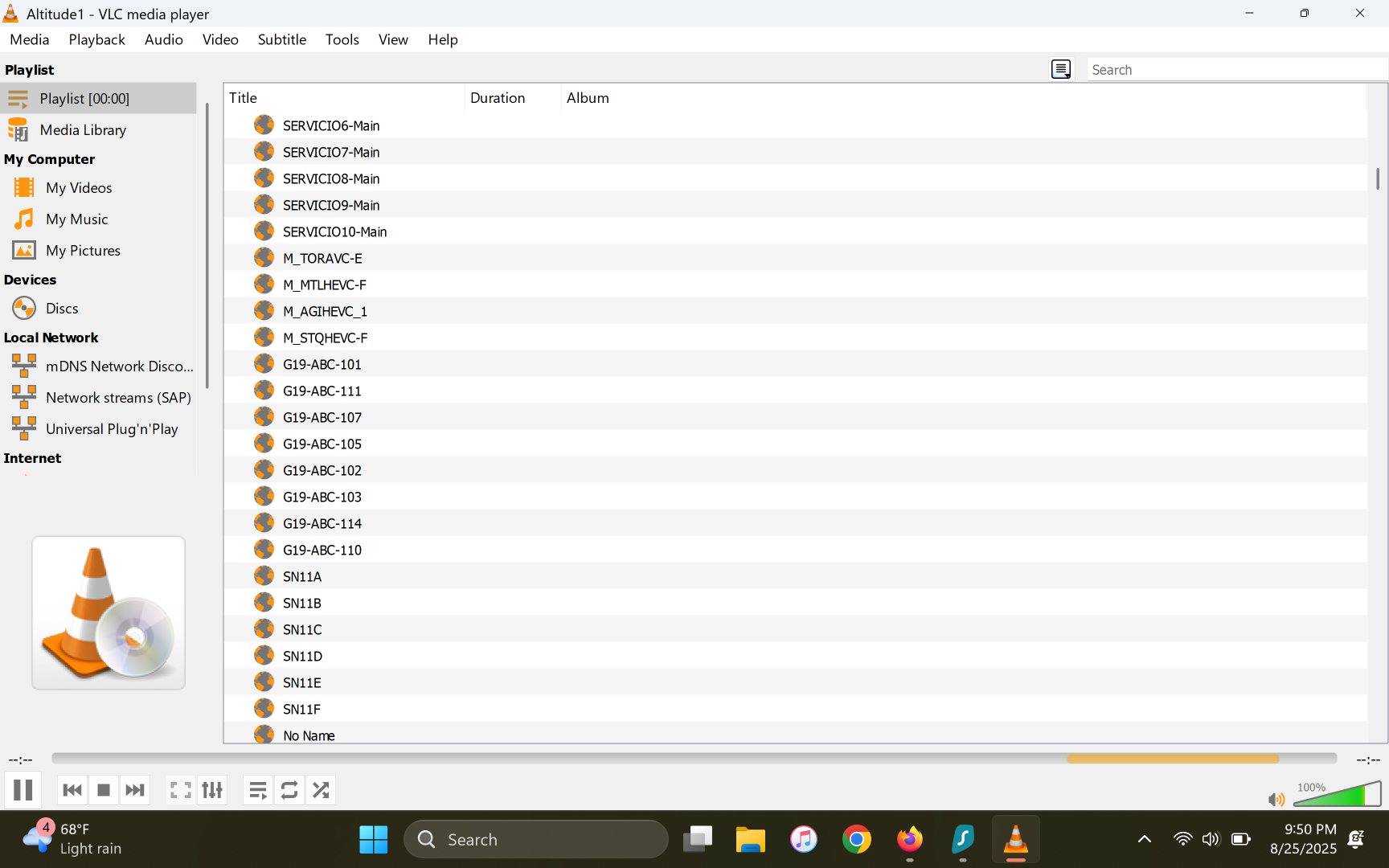

mr3p has discovered a way to stream from the V9 Prime directly to PC. This method may also work with a streamer connected to TV (such as Chromecast or Roku) but I have not tested it yet. So far this is WAY better than using that goofy GTShare app on your phone.
Go to Menu on the receiver. Scroll to User Data. Scroll to Data Export. Export a playlist to M3U to a flash drive (I exported my entire C-band playlist, over 600 channels).
Copy the M3U playlist to your desktop on your PC, and open in VLC. You will see all your channels there.
Click one (make sure you're on the correct satellite), then the channel should stream.
This is confirmed working with the DVB-S2X 4:2:2 ABC mux on 97 C-band.
