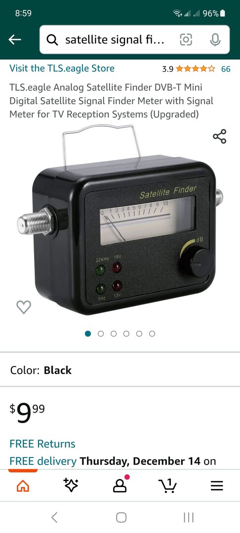

Thanks for all the responses, my setup is a metal base and frame with about 6 concrete 1/2 blocks to hold it in place. I would simply remove the blocks and mark the base but all marks would be lost as the roof will be a total replacement and there will be no reference marks I could take advantage of. I guess I could call dish and ask what they would charge, if its more then a signal meter then I would just purchase one, I guess I need to find out what one costs and where to get it.
I believe what you used before looked like this..I've been using a couple of these for 20yrs camping..It gets you close and then you can peak having someone watch the signal on the tv..

Yup, its flat alright, that's about all they have in NM. Moving it around won't be the problem at all. I will give Dish a call on Monday and see what they have to say, I won't have an issue at $50. but they usually tell me its $100. minimum for any kind of service call even if it's their stuff that crapped out. I guess I could also go with the mtc. plan and cancel it after a month but that's kinda sucky.
