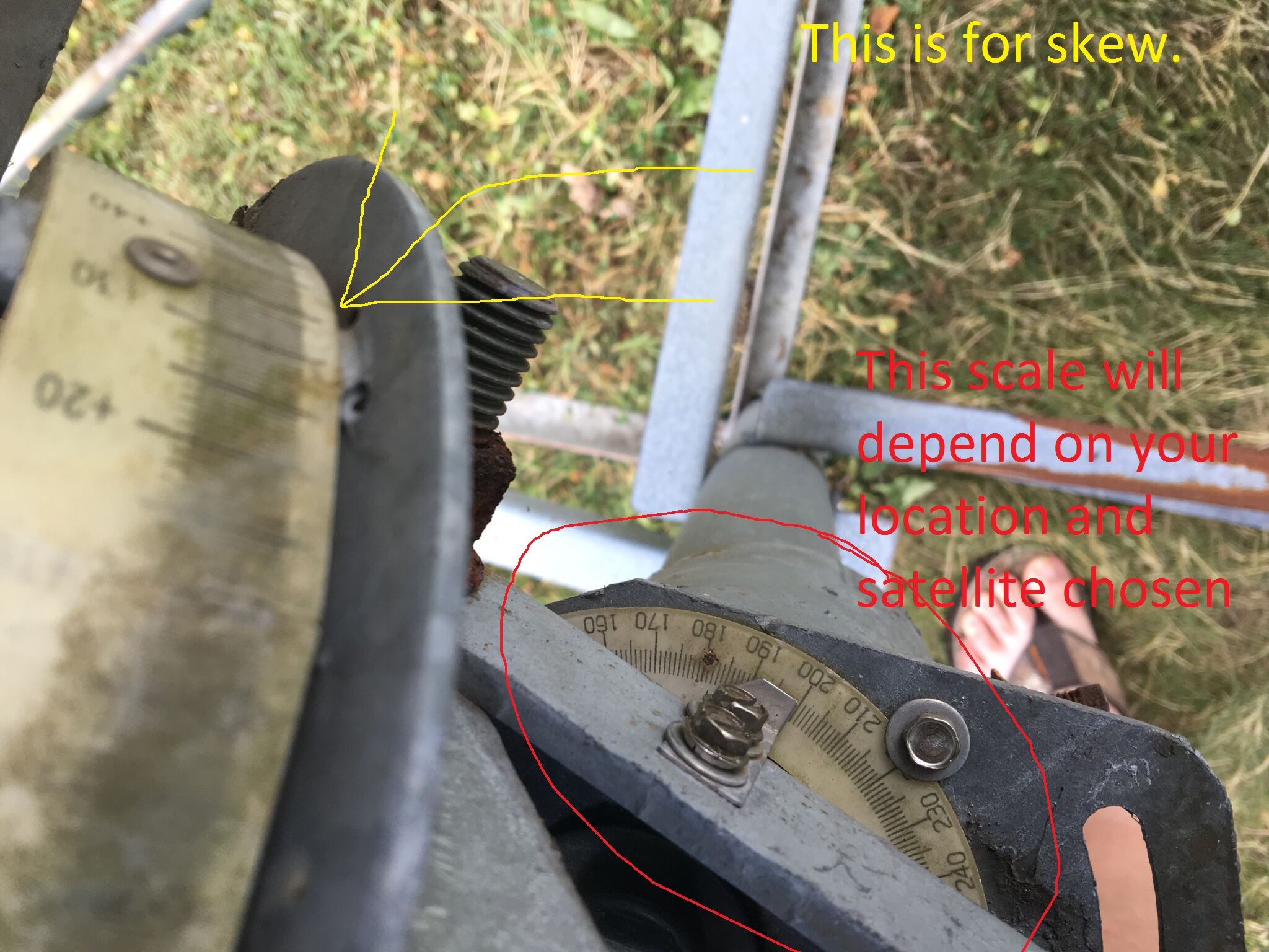

Also on the base where the degree wheel is would I align 0 degrees with true north or magnetic north or none of the above?

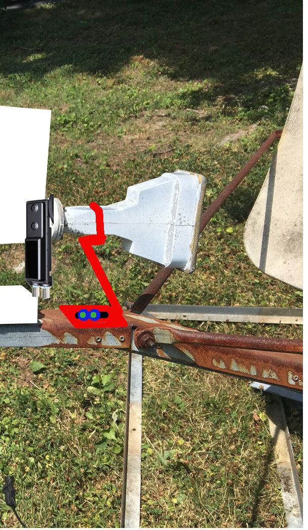

Is this the photo you are referring to?
YKM1vEiirAclCMleV1DN4H_jo4ZS8eZAALo2W2GvE10
Look at this photo I marked up.
Like Titanium said 97W is a good start. Go to dishpointer.com and enter your address and then choose 97W.
It will tell you the skew, elevation that is photo above, etc.
No this one is for elevation this is the one Im referring to perhaps it may be calls the turret?
