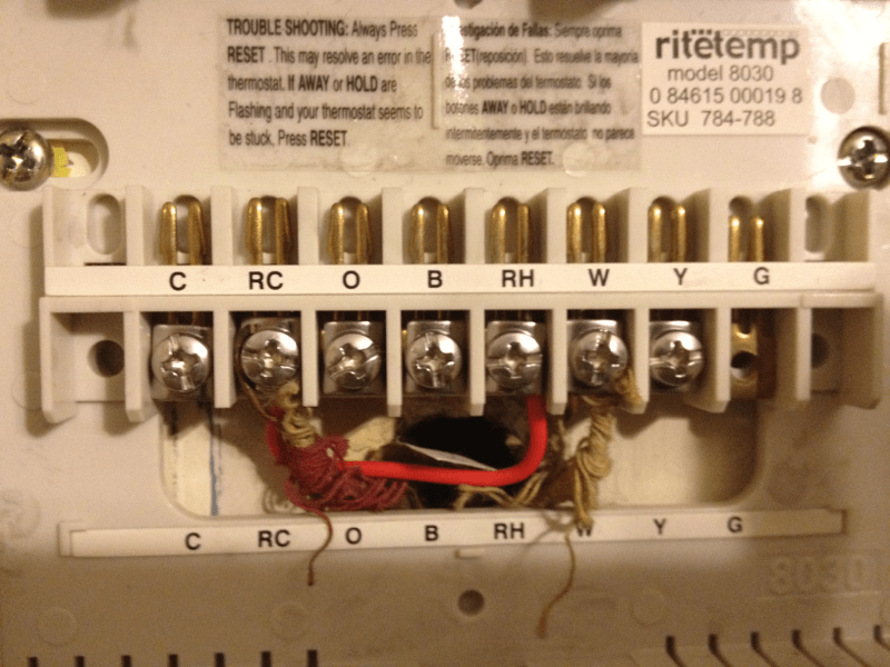

My furnace is origional from 1938 we have no cooling in the house. I replace the thermostat a few years ago, but can't remember how many wires it had, it was 2 or 3.

The other thing you can do is just run a 24v transformer (like for a sprinkler system) to it. I happen to have a closet behind my thermostat downstairs, so if I didn't have the extra wire, I planned just putting in a transformer in the closet and poking a hole through the Sheetrock to the thermostat.
Nope don't have it.

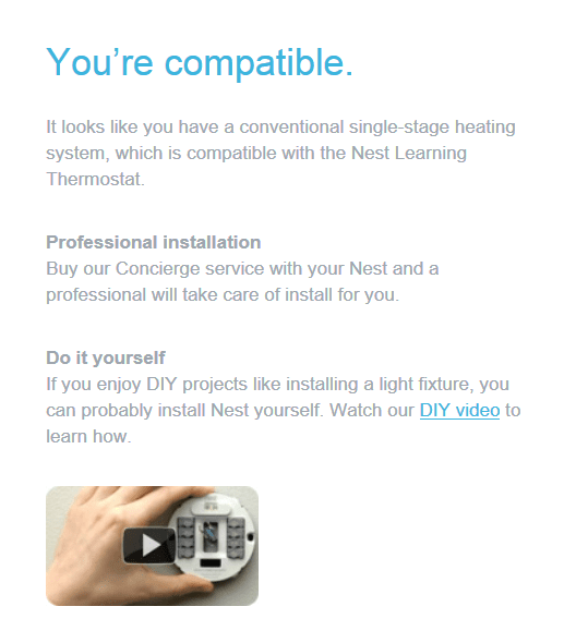

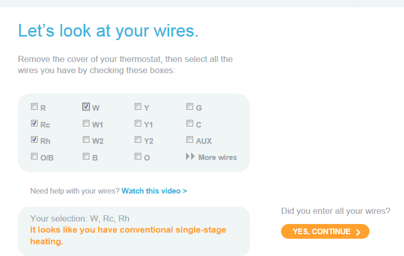

I have a heat pump with gas. The only option I will loose is "emergency". I have only had to use it 2 times in th 5 years I have lived in my house. I wont miss it. Pop the cover off of your thermostat and compare your connected wires using the compatability section on the Nest site. You can even take a picture of you connections and email it to Nest and they'll let you know if you are compatable.
