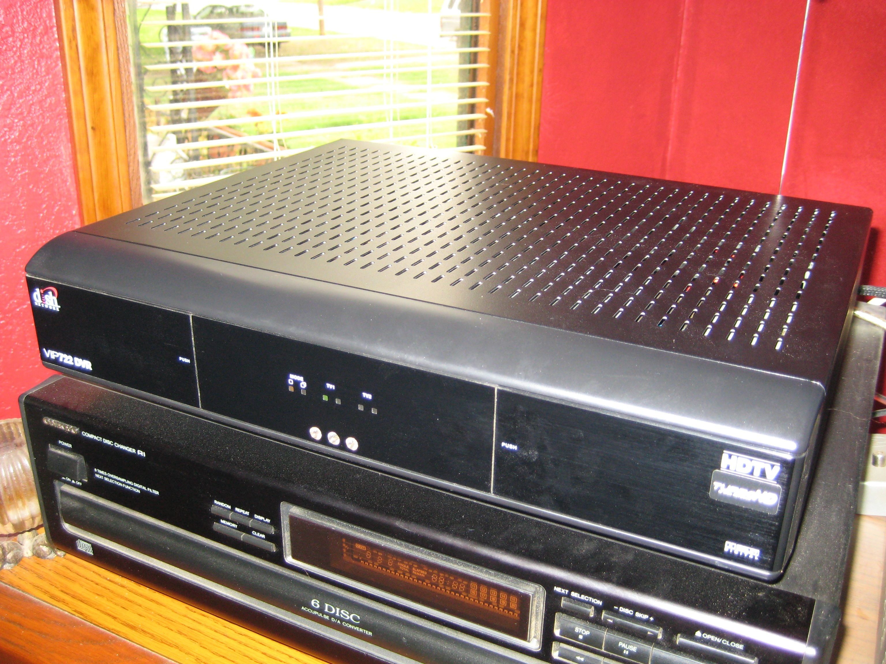

Check this out: A ViP722 with a ViP222k top cover. The louvers already make it feel cooler to the touch. I wouldn't be surprised if the logged temps drop over time.

The HD low temp dropped from 116F to 109F. These 7 degrees was worth the swap already. I got the cover from the 722 on the 222k now, which isn't hooked up anyways. I have no use for it. It's stowed away in it's box. It is way beyond my imagination, why NON-DVR receivers get the vented covers, and the ones with DVR are almost competely closed. This is completely stupid. Unless I am missing something here, like a proven reason, why it's done like that. I couldn't think of anything.

Mine is sitting on top of everything else with plenty of space around it. See photo. My average is 125, high 138, low now 109 - was 116. I keep the house at 77 degrees all year around. I had the external HD on top of it with the old cover, located on the far right and all the way back. This caused the fan to run at an elevated speed, and the cover was very warm to the touch underneath the external HD. I relocated the external HD and the top cooled off again. The fan slowed down again after a few hours. Then I replaced the top cover with the 222k cover and the low temp dropped 7 degrees. It also feels nice and cool to the touch now, except the area around the power supply, which is always VERY hot to the touch. I think I am going to reset the NVRAM to reset the logged temps and see what happens.
