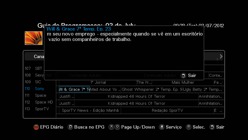

My friends have tested version 5400 and 5402 and found that the summaries are not working.
Example, this image is from 5309, is broken (incomplete), old error:
But in 5400 and 5402 is empty.
tnks.
