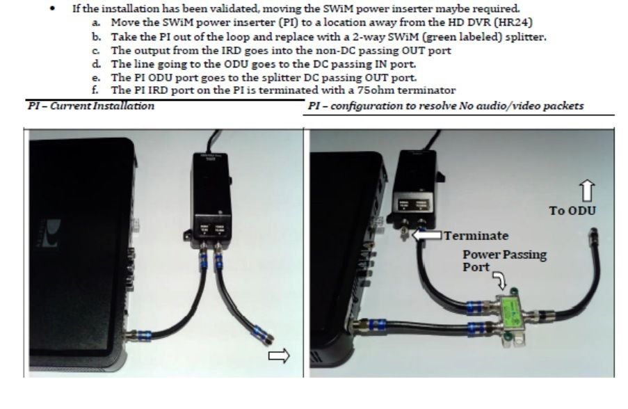

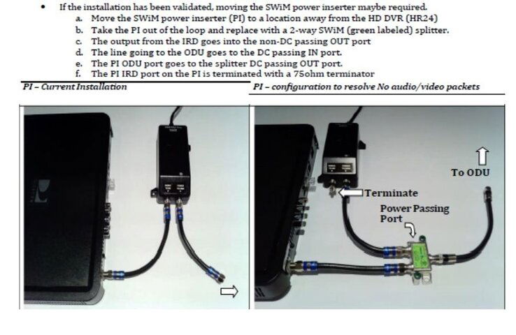

Got my new system installed monday (hr 34 and two h 25's) everything works great except dvr playback from both h 25's. its gives me the no audio/video packets message then next time it will start then just freeze. D* is suppose to send the tech back because he didnt install the cinema kit. But also the PI is inline between the 34 and the dish. Isnt it supposed to be somewhere else like closer to a 25 to help with this issue? Plus he didnt install a swm 16 box, instead i have the one wire from the dish being split with a green label 2 way swm.One of them runs into the 34 wiring setup with the PI and the other runs to another of the same splitters which splits to the 25s. Is this right?
