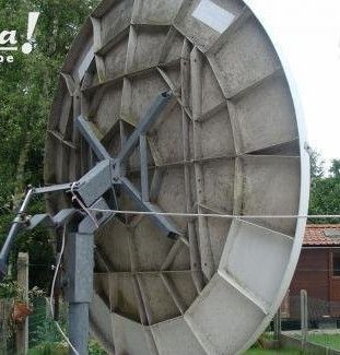

Hi!

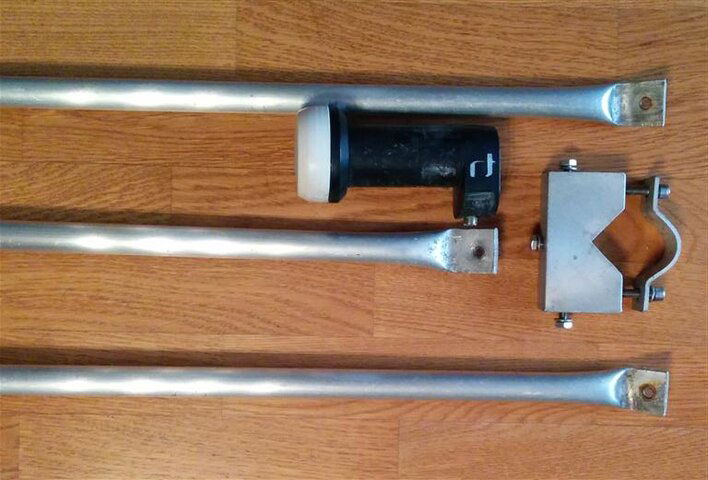

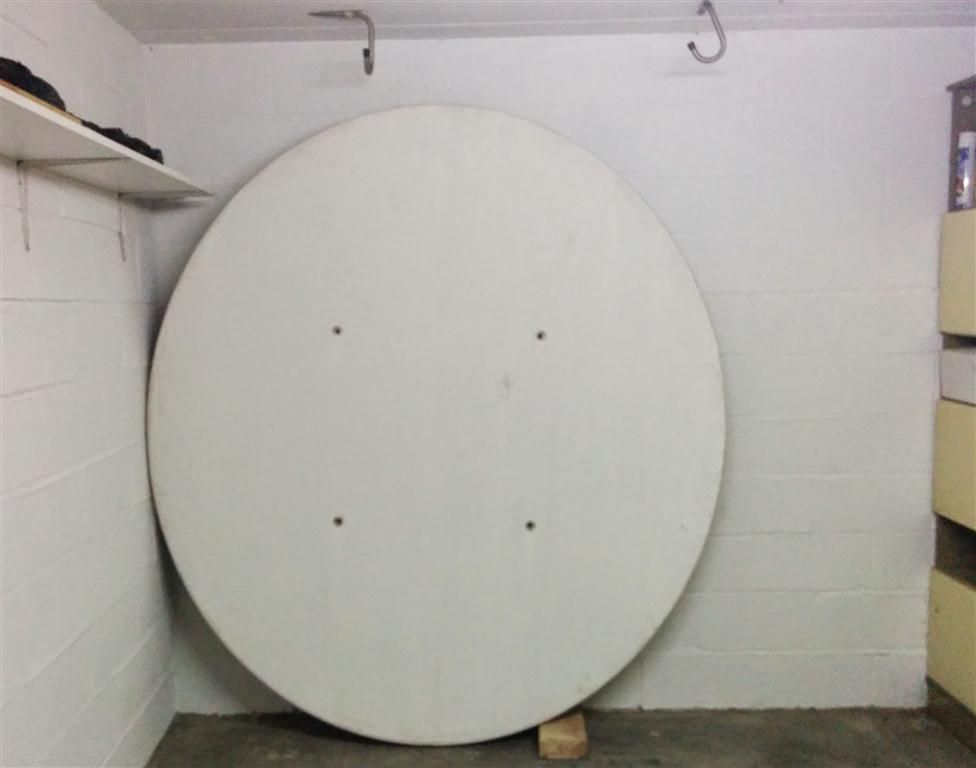

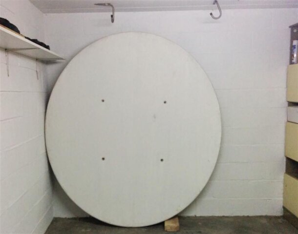

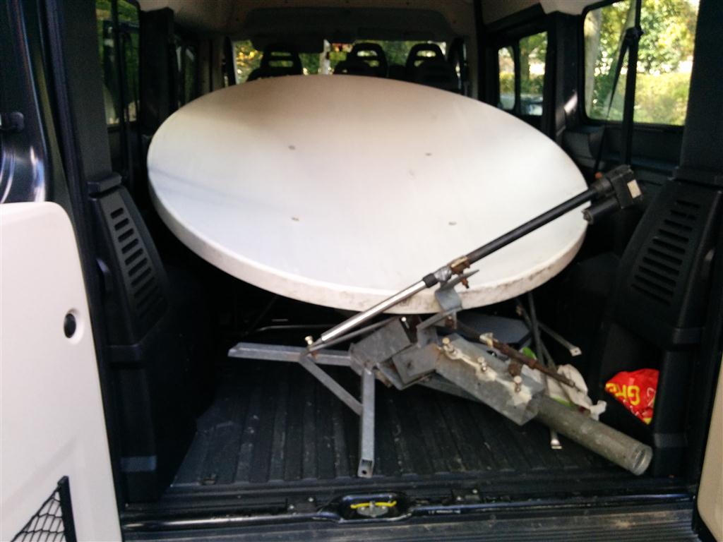

Some time ago I laid my hands on another 1,8m Prodelin, as I was told it is Series 3180 Ka-band one. It came on polar-mount and with aluminum LNB-holder holding IBU in it (do not know whether this holder is original).
This dish slightly bigger then Series 1183 with working area 14mm wider and 85mm taller. And it has F/D ratio 0.5.
So, my project would probably be like:
- washing
- changing all nuts&bolts to INOX
- strengthening polar-mount
- changing feedarms to new ones
- perhaps also converting to dual-reflection system.
Will not have possibility to install this antenna, so, by now I would like to collect more information about it.

Yes, I've seen this datasheet. But then I discovered this (attachment) drawing. And discovered that back of dish is similar, but front is completely different (on mine working area goes all around about 15 mm from the edge) and also dimensions are different, mine is 1800 x 2015 mm, and one from drawing has 1810 x 1896 mm. So, I am still not sure about brand :coco
None of those antennas have similar measurements. I put all data in small table where 1 and 2 antennas from datasheet and #3 (yellow) is mine antenna.

OMG I would love to have one like that! I have a 1.8m Prodelin but it's a fixed mount.
From everything I've ever read, polar mount of this dish is pretty scarce..
Polar mounts for Prodelin dishes maybe seldom, but I am not sure dish I have is Prodelin.
