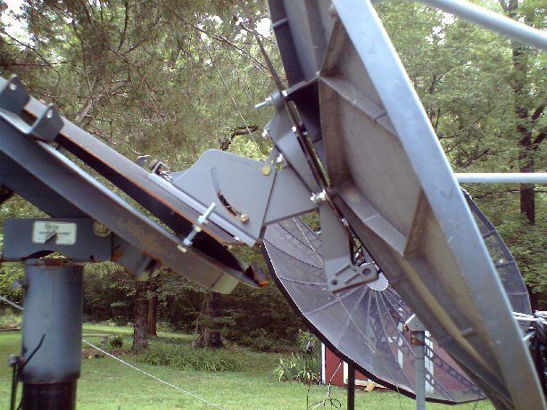

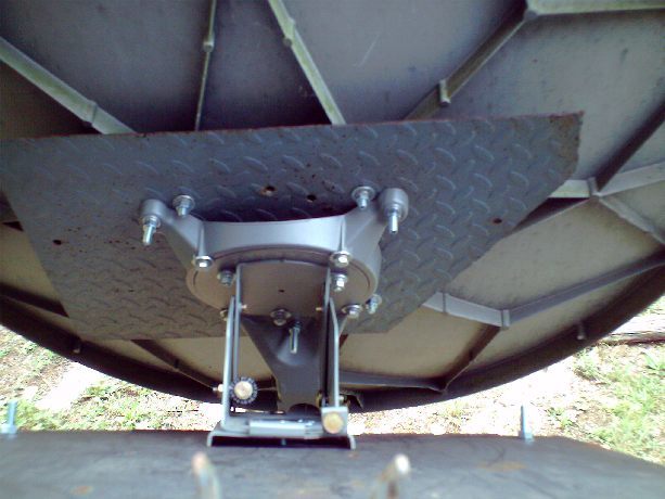

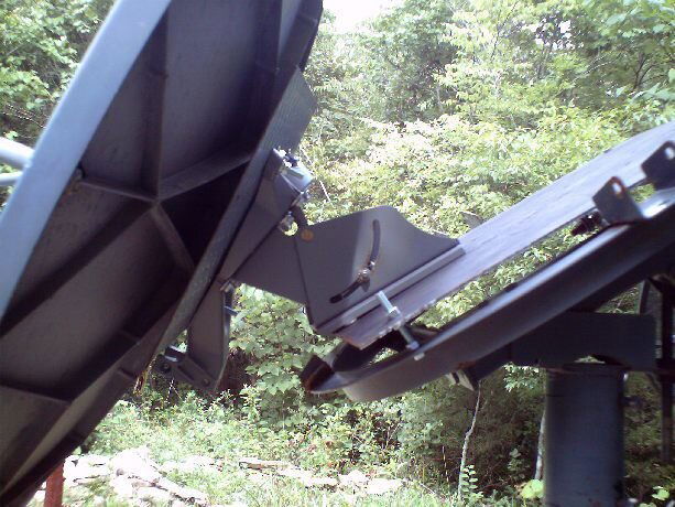

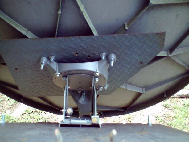

some pics
I think my engineering comes out better than my digital photography-but here's a few of the final product. Dang it DOES need some paint lol, I hate bare metal.
There's a guy wire running thru one but maybe you can see the general idea.
A piece of skid-plate I had lying around attached to the dish, dish/plate bolted to the AT9 -swivel mount, and all that bolted to 1/4" flat steel which bolted to existing holes in the polar mount. Average ol 18"superjack that I stole off my prime-focus dish (until I can get another one) It tracks from AMC6 to G10 and that's all I need to see in the sky.
Haven't ordered the invacom yet, I want to try this direcpc-lnbf out first since I don't need a 3x4 switch for that and it's prob a better lnbf than the orig round primestar.
Has been a fun project though.
Had to raise the bottom of the big plate on the c-band ring though, due to the way the AT9 mount is made I had way too much declination
available, all in the wrong direction. So I improvised with some 3" bolts. With the angle-meter I figured out the right adjustments to hit the tracking, while leaving the c-band ring at its orig elevation.

Nice pictures Turbo! That reminds me of a dish I spotted on US341 south, between Roberta,Ga. and Fort Valley,Ga. There is/was a 10' fiberglass with a D* dish mounted on the buttonhook in the middle of the 10' dish. Strange to say the least? I recently went by there and the 10' dish is gone, with the D* dish now fastened to the former pole of the 10' dish. I wish I had taken a picture of it, it looked really wierd? Yours looks wierd too, but it's the results that count. Whatever it takes, Good Job!
Al
That certainly leaves me speechless ! :eek:
It's a great example of what sort of reverse offset one needs , when putting an offset dish on a polar mount.
Congrats on getting it working so well.
Keep us informed on the DirectPC LNB, and the paint-job.
You made pretty short work of everything, especially considering the weather.
Hope the lizards didn't drown :)
It was a trick to figure out a way to get the right elevation with what I had. I wanted an easy way to skew the dish, and when this AT9 fell in my lap I decided it was excellent due to its very heavy construction. It was easy as setting a dishnetwork dish's skew with that thing. But it had more than enough declination and was maxed out on its elevation low-side. So, only thing to do was pick something UP. I did learn that 1/4" steel will flex a little, right in the middle where the mount is bolted on-I could goof up the pictures on the fta box by pushing/pulling up or down right in the middle, at the bottom of the plate. So far though it doesnt seem to be moving now that the rec is moved indoors, or if it does, it stops as soon as the dish stops moving. I can brace it if it become noticeable later though. Educational ordeal , haha.
