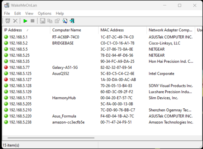

Not to butt in. Web. Would you please download and install this application. It will show every device on your network. If your receiver is connected to the router, it should show in the list.
It will also the MAC address of your receiver if it's listed in the discovery list.

Look here. Get the right version for your PC. Its under Feedback.

Then if you are getting network connection lights. Install and run wakemeonlan.
You'll get a list of something like this.
Patience, Grasshoppa'.
Arlo, installed the app and did get a list like you show. Shows MAC as 28-57-67-8B-A5-36 green light is on. Then the next line is Dish again with slightly different IP address and unknown computer name and different Mac address.

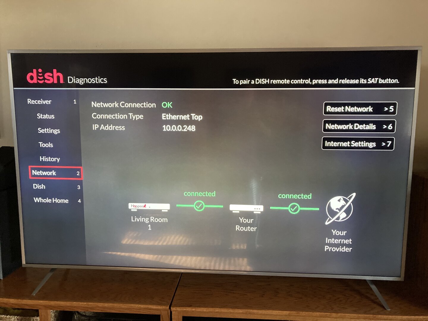

Just for jeepers, Web, what does your Network look like on the Hopper. To see this, press Home 3 times on your remote and then go down to Network or press 2. You should get a screen that looks something like this:
If you don't see a 'connected' between your Hopper and router press 5 to Reset Network. Try this and see what happens. Also if you can please take a picture of the Diagnostics screen and post it here.
