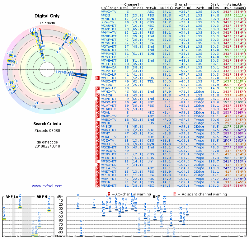

Ron: What's your zip code?
If you know what to look for, yeah. A good friend of mine feeds his $4000 Samsung 58" plasma with DirecTV, and I see the same problems on his screen that I see on my $800 4-year-old 37" LCD. His picture engine and display itself are vastly superior to mine, but compression and resolution artifacts only get louder as those two technologies improve and the display size grows.
08080 why?
Looks like all of your TV towers are 14-21 miles away, but the transmitters are HOT. Rabbit ears might not be the final answer for OTA reception for you, but you're far too close to use an "amplified" antenna. Hint: Most antenna "amplifiers" hurt reception more than they help. If you ever decide to put the third tuner on a Dish VIP receiver to good use, I can help with that.
I tried with and wihout the amp on the two indoor antennas i tried. I don't recall much of a change either way.
