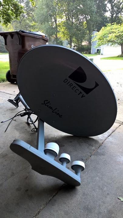

Direct tv slimline not sure on the with of it but here is pic
