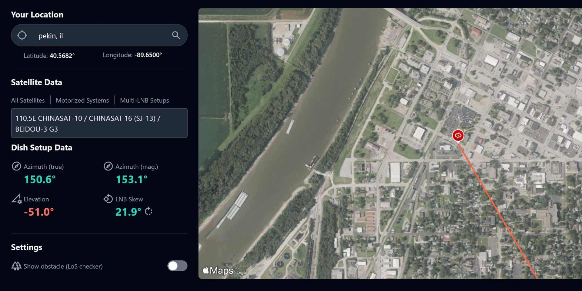

Huh... You're not wrong. I put in my city and the only sats that show up to choose from are Asian.
North here is straight up on the map

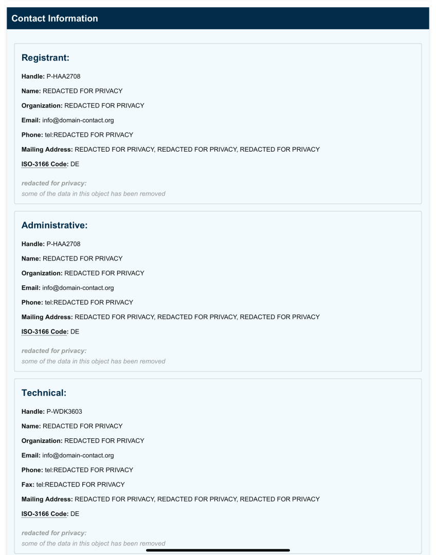

The dishpointer.com domain isn't based in the USA now, it appears to be owned by some entity in Germany.
They're not volunteering much info.

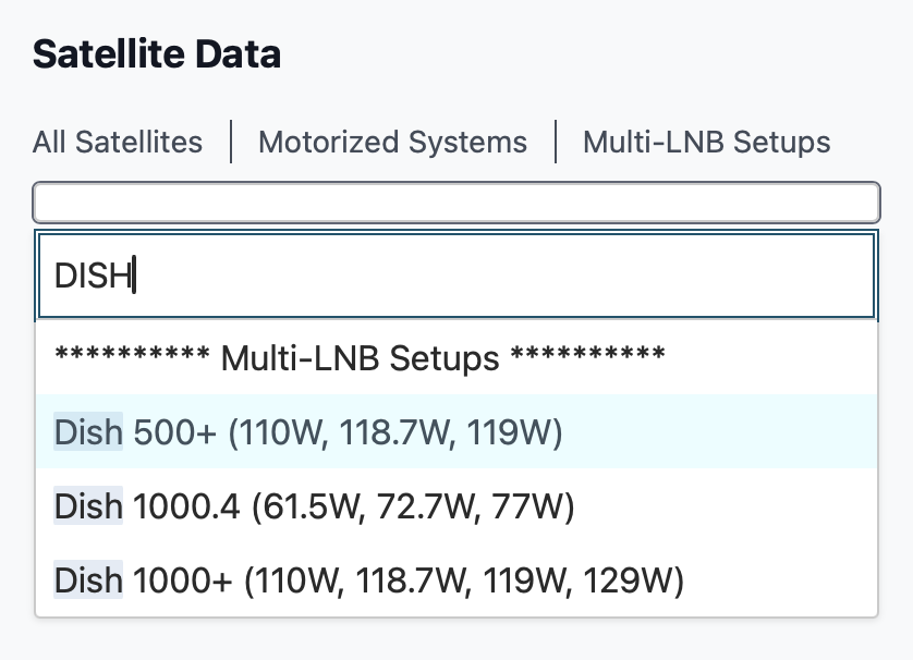

Did you click on "Multi-LNB Setups" and then in the sat box to see the list? And clicking on "All Satellites" and then scrolling down the list finds all of the individual sats listed from east to west. The Dish and DTV sats are quite a ways down.
After you enter your location, you must click on the satellite data box and scroll down to the satellites that are "W" west. Satellites are listed by latitude beginning at 180 degrees east to 180 degrees west, so USA visible satellites are quite far down in the list. So, 61.5 is about 2/3 of the way down the list110 and 119 are more than 3/4 of the way down.
If you zero in on an Asian satellite you are looking down through the earth.
This new site is actually easier to find Dish satellites by using the Multi-lnb setups , whereas before you had to dig through all of the satellites.
