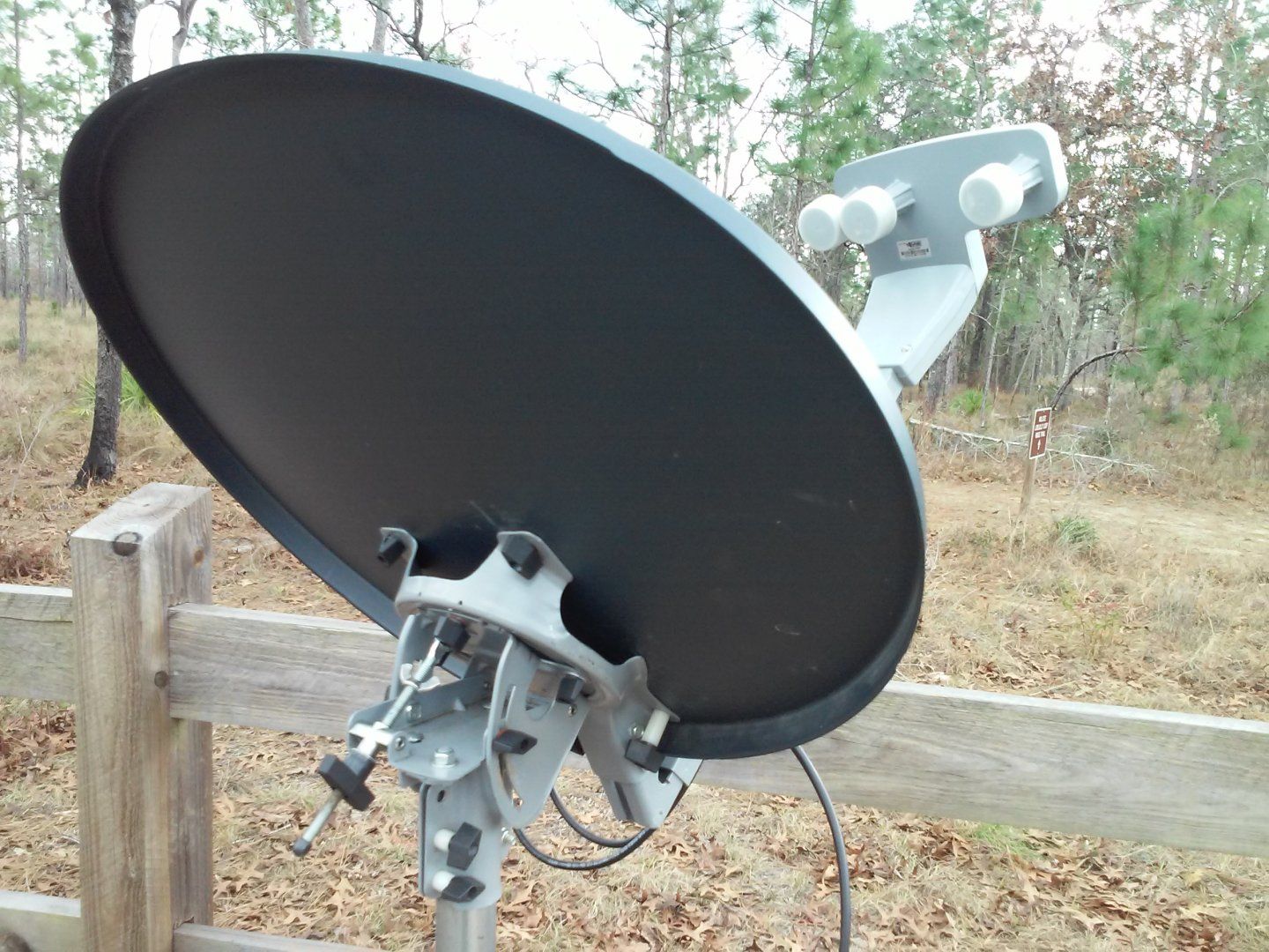

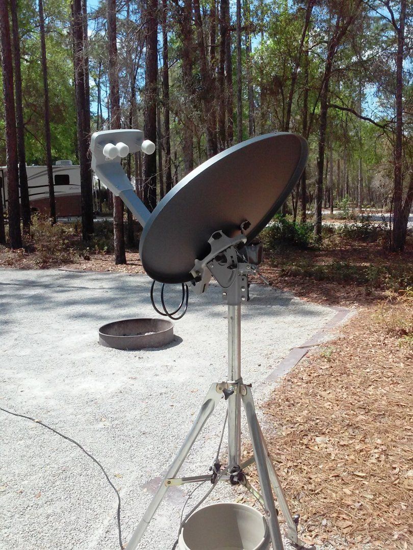

We're full time RV'ers and have been using a tripod mounted Dish 1000.4 dish with either a western or eastern arc triple LNB as needed for about the past 10 years. I currently use a free Winegard app to spot the tripod with the clearest sat view, getting the exact elevation and skew settings from Dishpointer.com. I use a ~$50 meter to dial in the dish, but I haven't seen one available for quite some time now. It typically takes me 15 minutes or less to set up the dish and dial it in. Our tripod is a modified roof mount tripod that cost under $50 including the hardware for the mods, and the dish has also been modified so no tools are needed to set it up except a small screwdriver if an LNB swap is needed.
