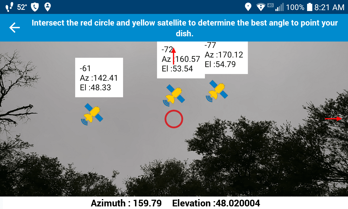

I must have missed something. What is DNS? When setting up to point my open dish 1000.2 I get calculated numbers of Alt: 45 Skew: 124 Azi: 215. It can make a really big difference on the azimuth setting if that angle is magnetic or true or Grid North? As an example, On the west coast of the United States, the compass direction lies between 10 and 16 degrees east of true north. In locations on the east coast, the magnetic declination is about 10 degrees west (-10°). Cities like New Orleans and Minneapolis are situated very close to an agonic line, meaning that the magnetic declination is close to 0, so a compass actually shows true north there. I know when looking at geo-stationary sats, they only drift slightly from their RA & Dec in the sky. So finding them in a telescope can be very easy and you do not need a tracking motor to keep them centered in the field of view. But when using a compass to locate them, do I use just the reading of the compass?
The aiming listings at DishPointer - Align your satellite dish give you both the true and magnetic azimuth directions. With a compass, use the magnetic numbers of course.
Thanks NYDutch. That's a slick app. Is it the one that is $19.99? There seems to be a number of them on the app store
DishPointer.com does have an app that works well, albeit a bit pricey. Winegard has a free app that can be used for both OTA and satellite setups that also works well. Both apps have an augmented reality feature that overlays the satellite locations on the camera view for easily finding a clear spot for the dish. I have both apps, and I currently prefer the one from Winegard.

Hey dutch, I've tried several of the apps mentioned and non of them seem to be telling me what skew setting to input into the 1000.2. They all agree on the azimuth and altitude. And the apps work with only a gps signal and compass in the phone. I do see on dishpointer.com on my pc down at the bottom the skew angle shown. I just have not seen any of the android apps that show that - just alt & azi. As long as my phone has a good internet connection, I can use the dishpointer.com web site. Thanks for the info.
The DishPointer app at $19.95 shows the skew on the AR view screen. For Dish, you have to add 90 to the number shown though, to match the dish mount skew scale. The app uses a vertical zero reference, while Dish uses a horizontal zero reference. The website on the other hand also uses the horizontal zero reference so the number is used as listed.
