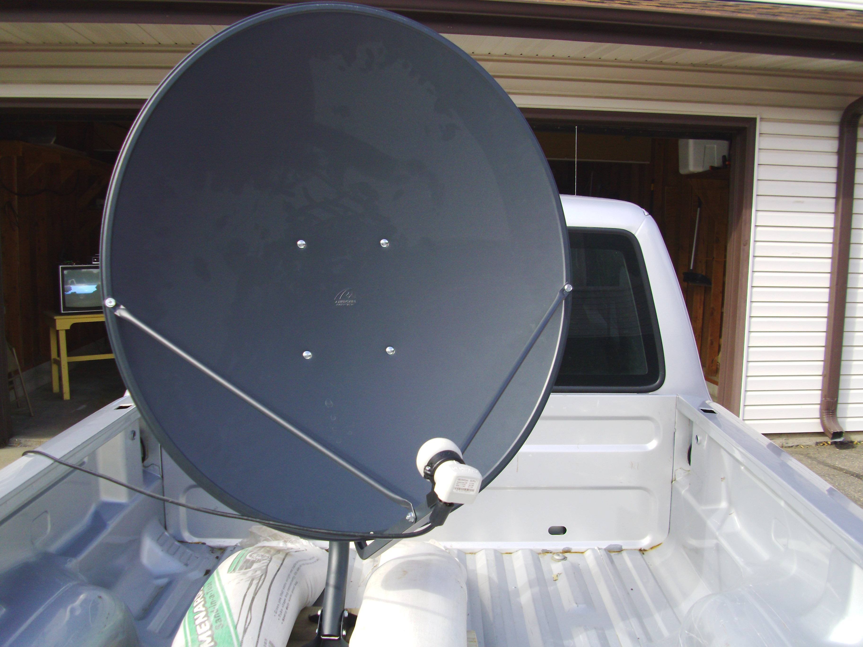

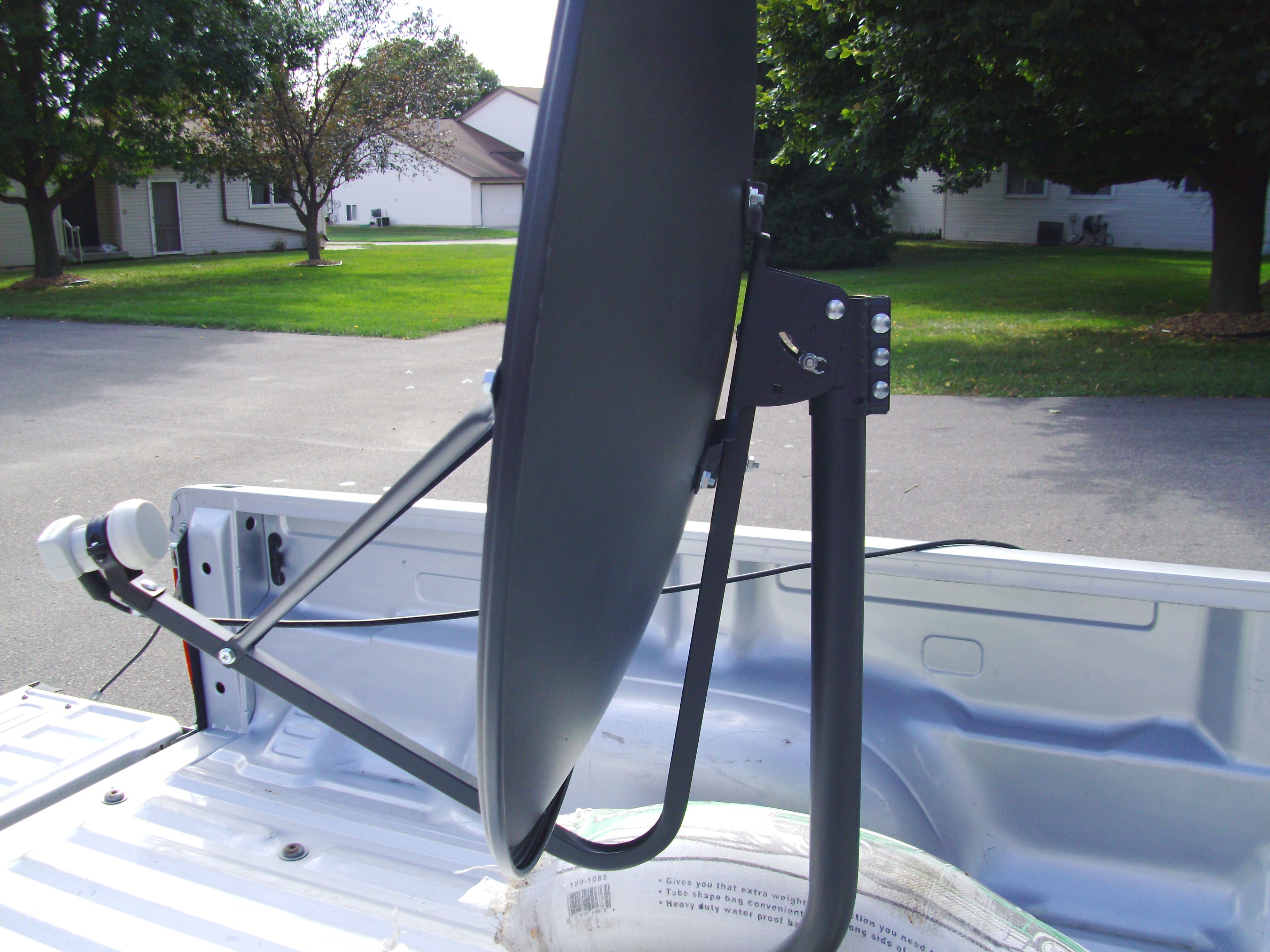

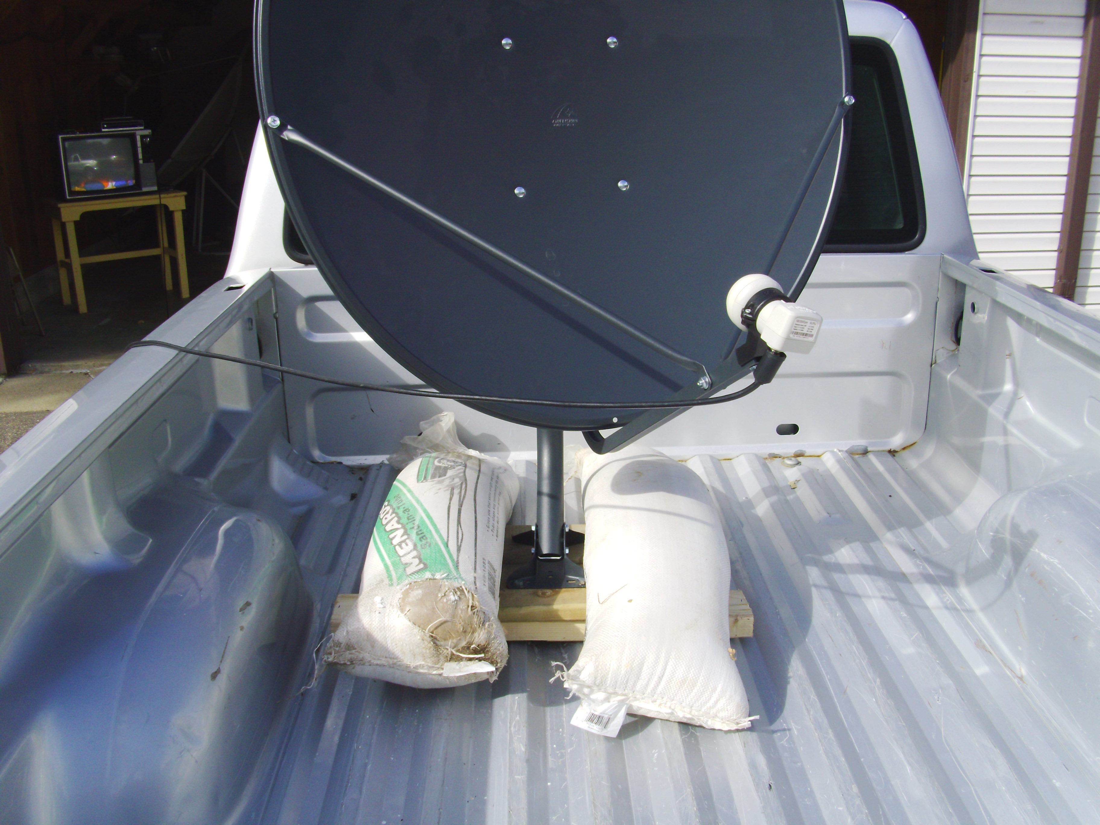

So I got the dilemma of 2 games tomorrow that I want to see...and they're on the same time (and probably not on same satellite). I thought of trying to get a 90cm installed again on the roof but that got to be a pain......and with that motor shot it wouldn't work.

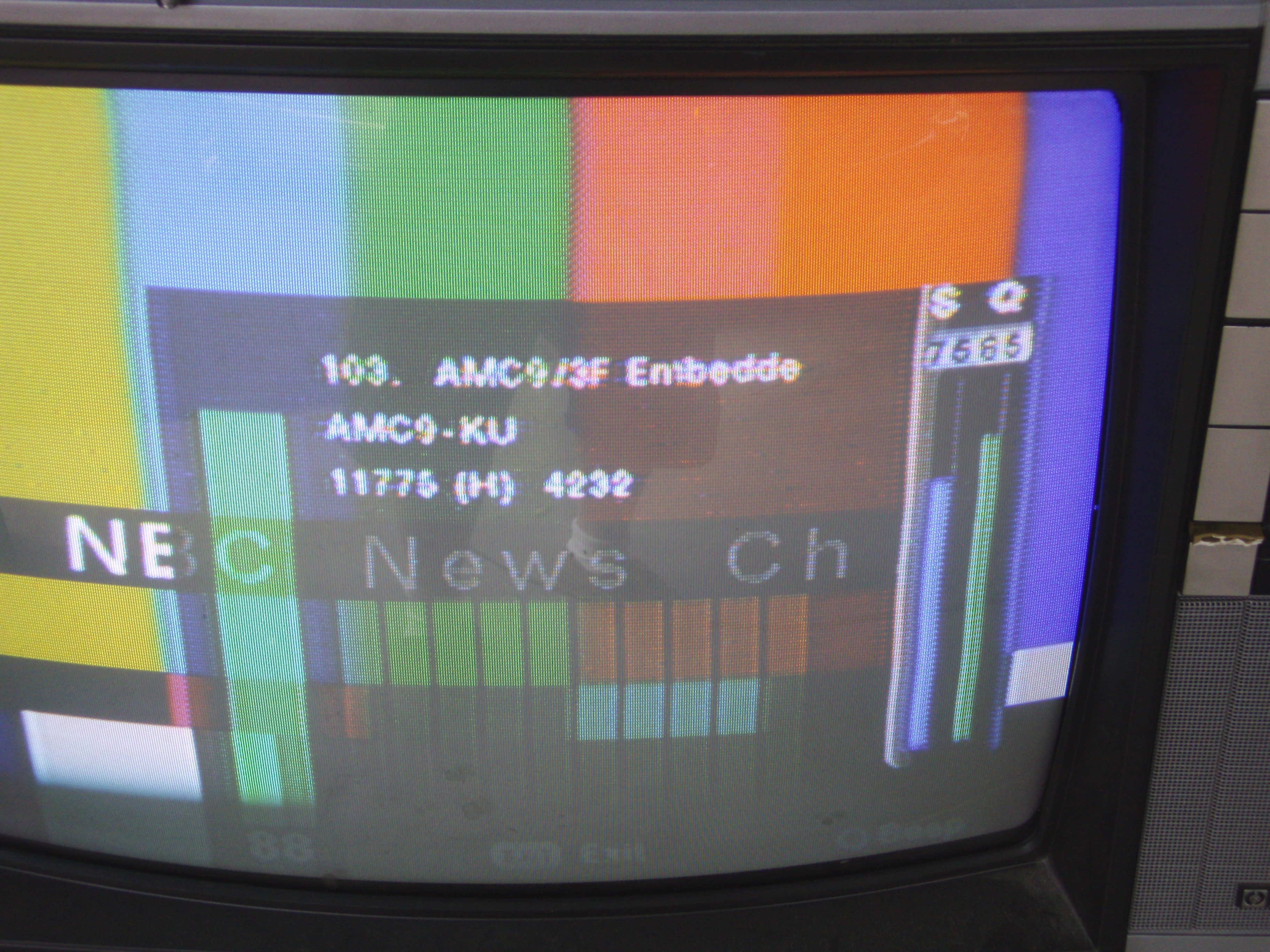

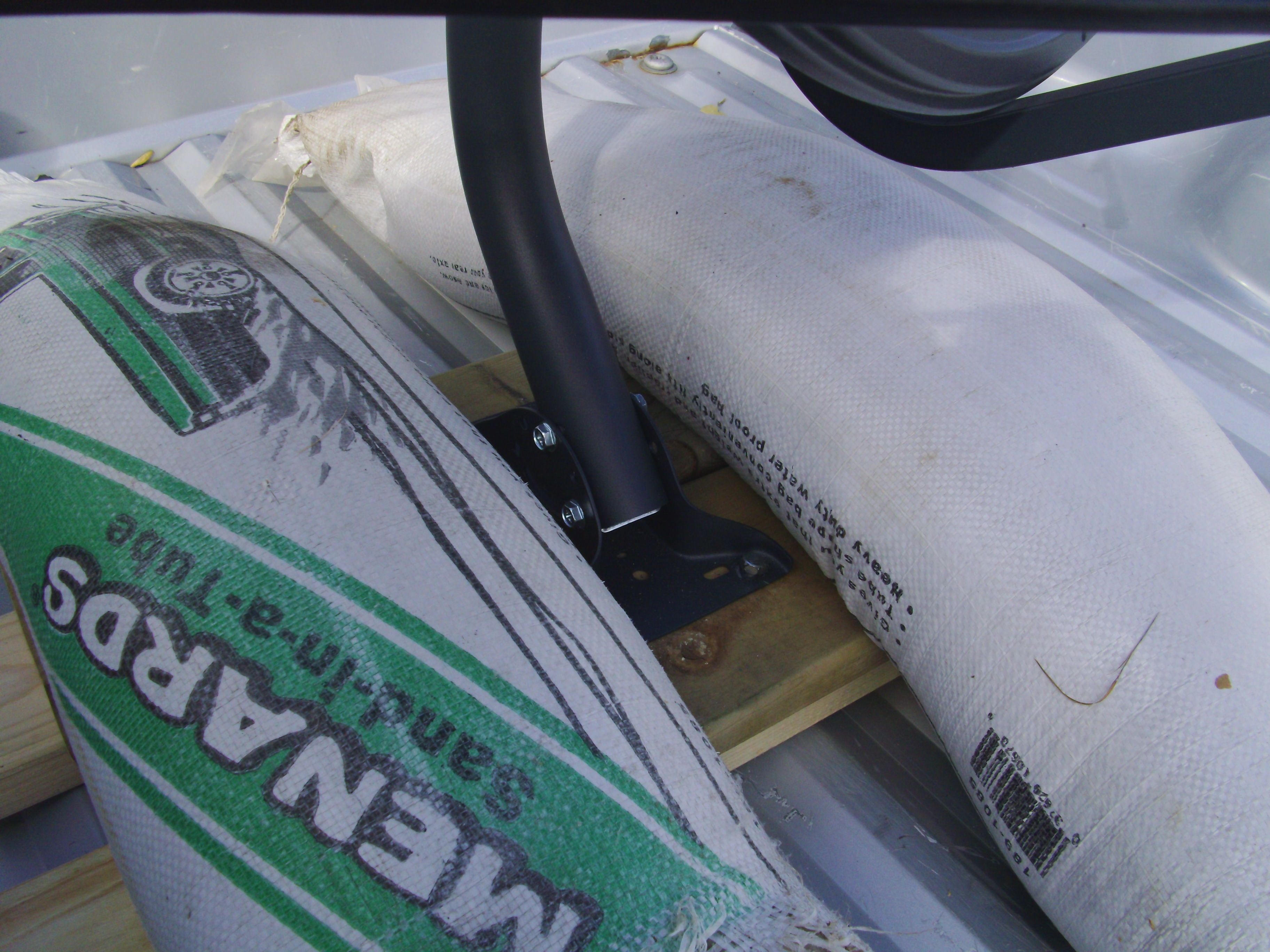

So started thinking.......hmmmm.....then it dawned on me. A portable dish. Took the mast and mounted it a couple 2x6's and put some 2x4 below it. Set it in the back of the truck, threw some sandbags on for support and leveled the mast. Since the Geosat mast can maneuver and level better than most it was very easy to get a level mast. Put the dish on and aimed it. Locked 91W just fine then slowly moved it until I locked 83W. I couldnt stand in the back of the truck to aim the dish because the truck moved then ;). I could have put it in the driveway but I think I had line of site issues. With the truck I didnt.
Took less than 1/2 hour :)
I did take the dish off so tomorrow all I have to do is put it back on and aim it....I know it looked funny to see a mast sticking up in the back of the truck when I ran some errands but I dont care :)

Dont forget about the dish and coax in the bed of your truck. I can just see the TV flying through the garage door and bouncing behind the truck as you head up to the convenience store at half time! :crowdbounce:
it wont be hooked up to that....there is a cable I have run through the basement out to the garage so I can hook it up directly to the MicroHD :)
In those thumbnails I thought the bed of the truck was full of snow already, HAAha....guess i was expecting it since you get so much of it up there. It's a good idea, I should put one in my truck permanently mounted.
Those Geosat J-poles work well, also the DirecTV J-poles with monopoles (used with Slimline) work well for motorized setups. Mount to a strong pallet, and you've got the perfect portable dish!
well since I ran all my errands this morning and dont plan on going anywhere the portadish is set up already :)
73 quality on the MicroHD
of course my neighbor came out about noon when I was walking back from getting the mail
he looked at the truck, then looked at me, then the truck and said "s**t I dont even wanna know" :D

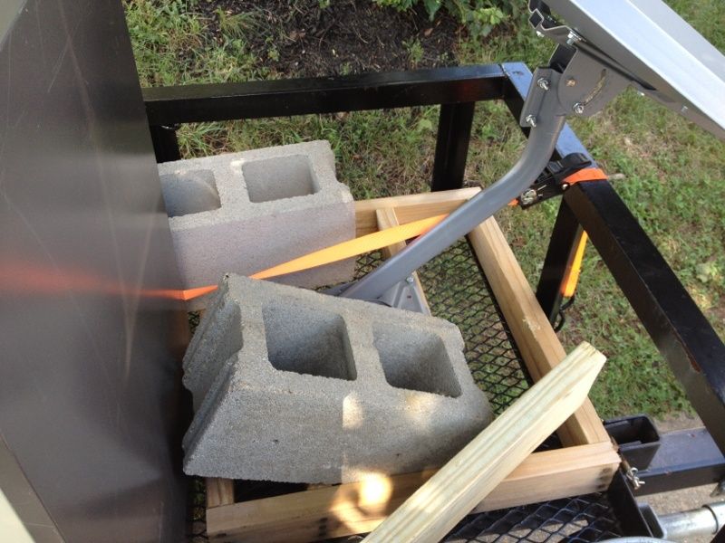

iPhone 4

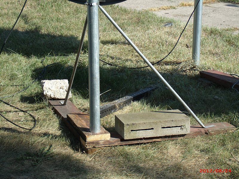

HD Exhaust pipe, SS hose clamp, some conduit, recycled decking, a couple of deck screws and some misc ballast.
