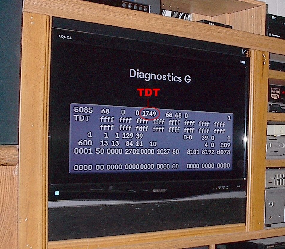

Whats your TDT count? Mine is 1749. My channels now after a soft reboot is 201 -954 Channel count is 4782. Your channel count probably has some corruption in it. if you have a high TDT 1920 you want to do a MR before Christmas Eve and get it straightened out or you will have problems next year.

It has to be or your receiver is toast. See picture attached. Options 6.0.5 > arrow to diagnostics G.
Receiver operation is nominal. All X4 Channels loaded but no Guide for X4. Guide is normal otherwise. DMX reception on 900 channels. Regarding TDT and your instructions this is correct of course. Area that should be TDT is blanked with ffff.
I am second owner on this rec. and it always is like that. Previous owner was supposed to be in communications development. If any changes were made receiver shows absolutely no sign of intrusion. As of today antenna will be aimed at no satellite.

This has happened several times already. I map X4 in , (just after) It's Tile sits immediately left of w5, again today, I notice the tile moved to the #3 position left of w5. I go back to w5/600 (sit for a few minutes) , check the sat tiles and it's moved back to, 1 left of w5.
hmmmm (haven't been on G1) only w3 & w5 this morn. Unit is set NOT to move on it's own and was not turned off last night. (hardly ever gets turned off). This is not the first time the x4 tile has moved.
Anybody know why and if it a concern.

You might check this and it's only a wild guess on my part as to your problem. If you haven't already.
Press options,6, 0 which will give you a screen with 5 options, select 5 and go to screen G by using the left arrow key. Top line and the 5th set of numbers should be lower than 1950 if not then you'll need to do a master reset. I checked all my 920's and there at 1714 count.
But big problem if you would have to do a reset at this time I'm not sure if G1 is still available, you would need to check on this.

When you are on W5 600, unplug the receiver for about 2 minutes and then plug it back in and wait on channel 600 for the new X4 map to download. You should then have 4782 channels from 4809 and the X4 channels starting from 201.
