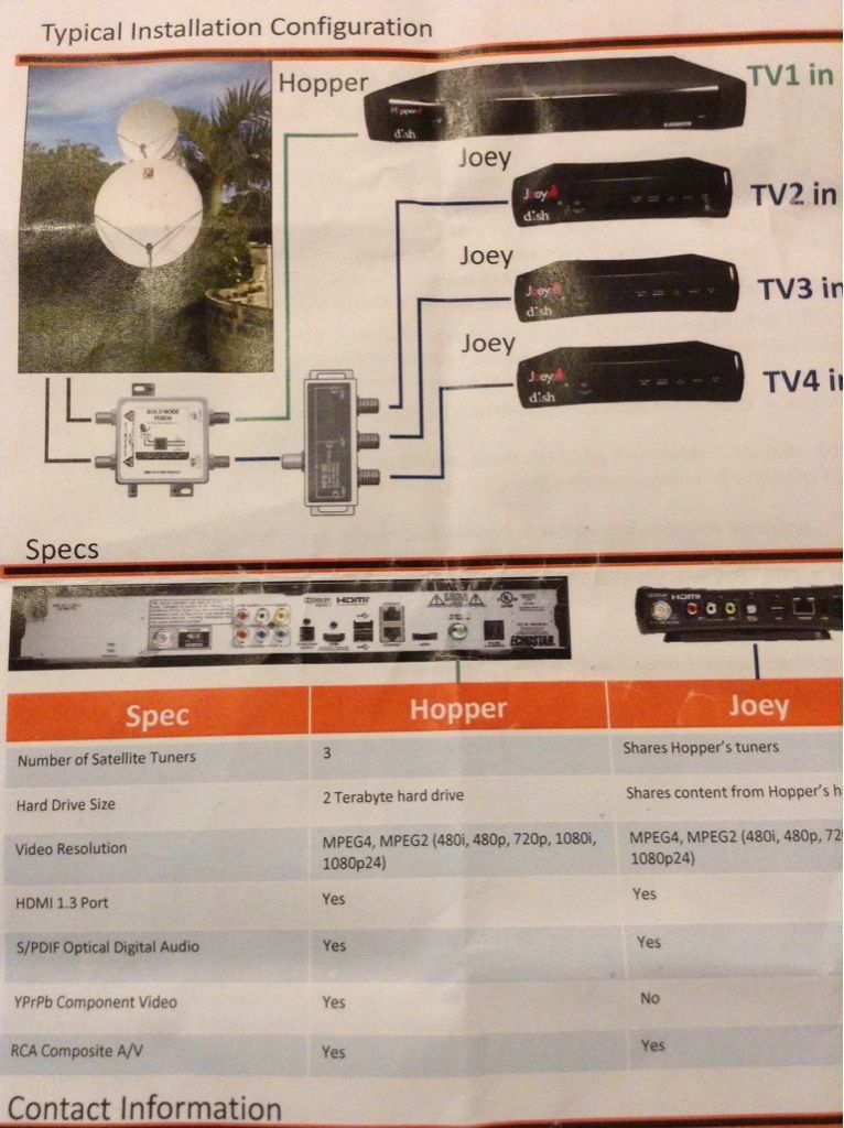

Hello guys, I am new to the forum.
I am in the process of hooking up my new home with Dish Net. I managed to buy a channel master 6ft dish.
I need info and help on selecting receivers for my system. I see that there are new Joey/ hopper receivers out now. I have no clue as to what their features are and how to choose a receiver.
I want to rig 5rooms with dishnet. It would probably be easier to call dishnet to setup but I do not live in the USA. I am in a close by Caribbean Island where I can get a signal.
I want to subscribe for the full package of channels when I am up and running.
I have also seen quad and triple LNB's. How beneficial would this be for me as I love sports and movies? How many receivers do I need in total?
Regards,
Toni
Welcome to the forum!
I'm not sure about the dish antenna you are using or what LNB you will need but if this is a new home then you want to make sure you have two coax cables run to each place you would want TV. One cable is fine but two just helps a lot.
I see you have 5 rooms but it would be helpful to know how many people will be watching TV in the house.
The Hopper system is the latest and the greatest but is also the most expensive. The DVR fee for the Hopper is $12 a month and each Joey is $7 a month. If you want to be able to watch something different in HD in each room then I would suggest 2 Hoppers and 3 Joeys. You could go with 1 Hopper, 1 Super Joey and 3 Joeys. I'm sure you have no idea what any of this is but once we get some more details from you we can explain better.

The Super Joey operates exactly like a Joey but it adds 2 more tuners to the Hopper. You can not add a Super Joey to a 2 Hopper account currently. So a Hopper with Super Joey would total 5 tuners and two Hoppers would total 6 tuners. The Super Joey has a fee of $10 per month and a second Hopper has a fee of $12 per month.
If you want to purchase the Super Joey you may be able to find them online or just find a retailer. I believe they sell for $149.
