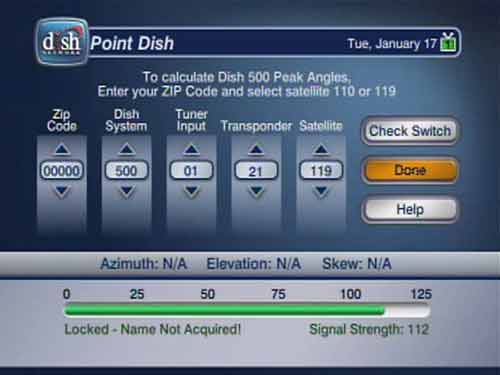

Press "Menu" Then "6" then "1" then "1" again. You should see a screen similar to this:
attachment.php
You need to highlight the "check switch" button and press "select" on the remote.

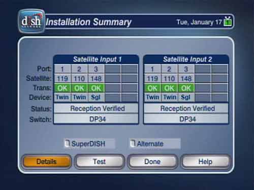

You should now see a screen like this:
attachment.php

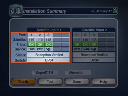

What we need to know is everything in the area highlighted below:
attachment.php
Just reply with the fields shown in that area so we know what equipment you're dealing with.
