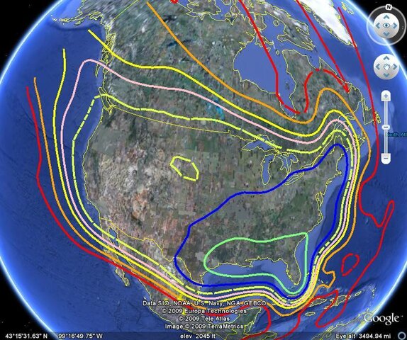

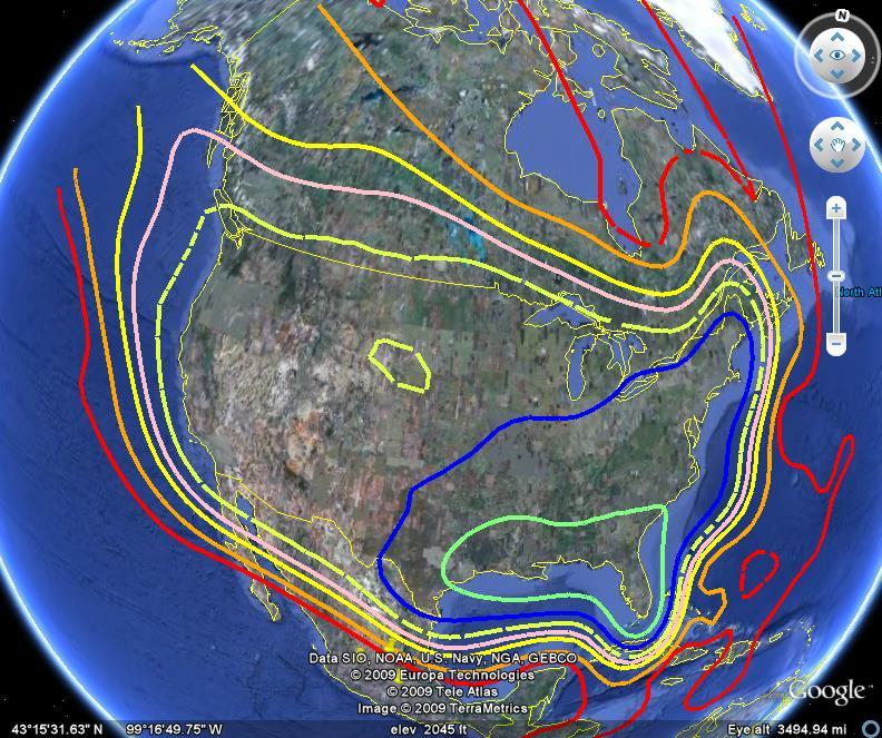

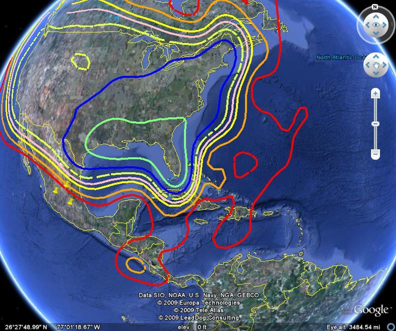

Nimiq 5 Footprint
Conus and Carribian Coverage for Nimiq 5.
Red is 35.5 dBw with probable reception with 1.8+ M Antenna)
