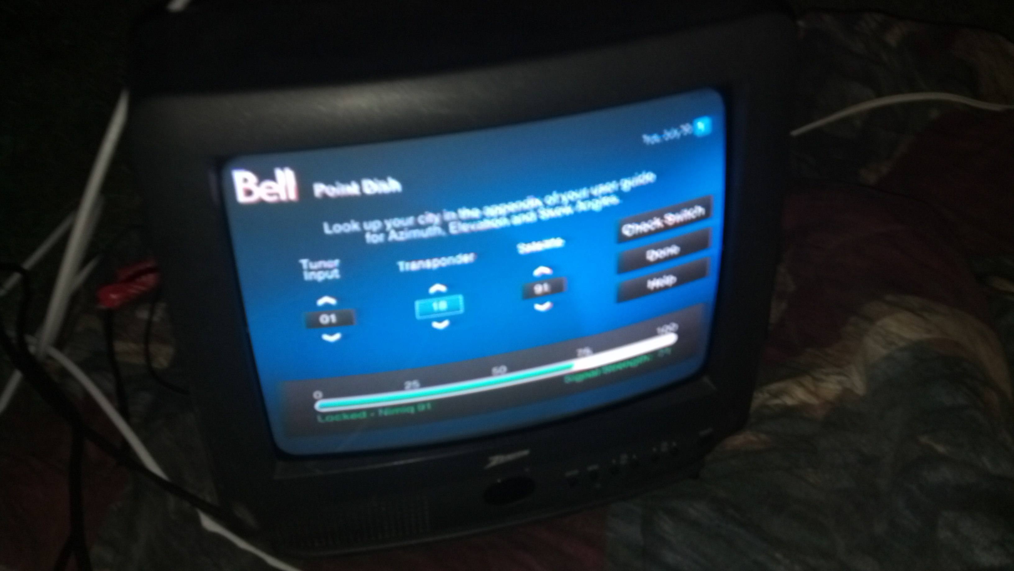

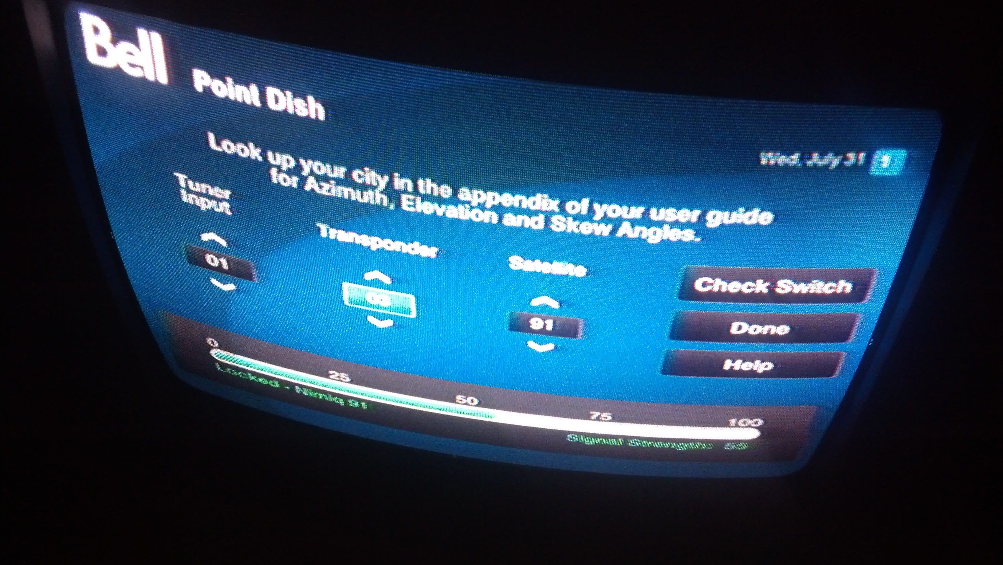

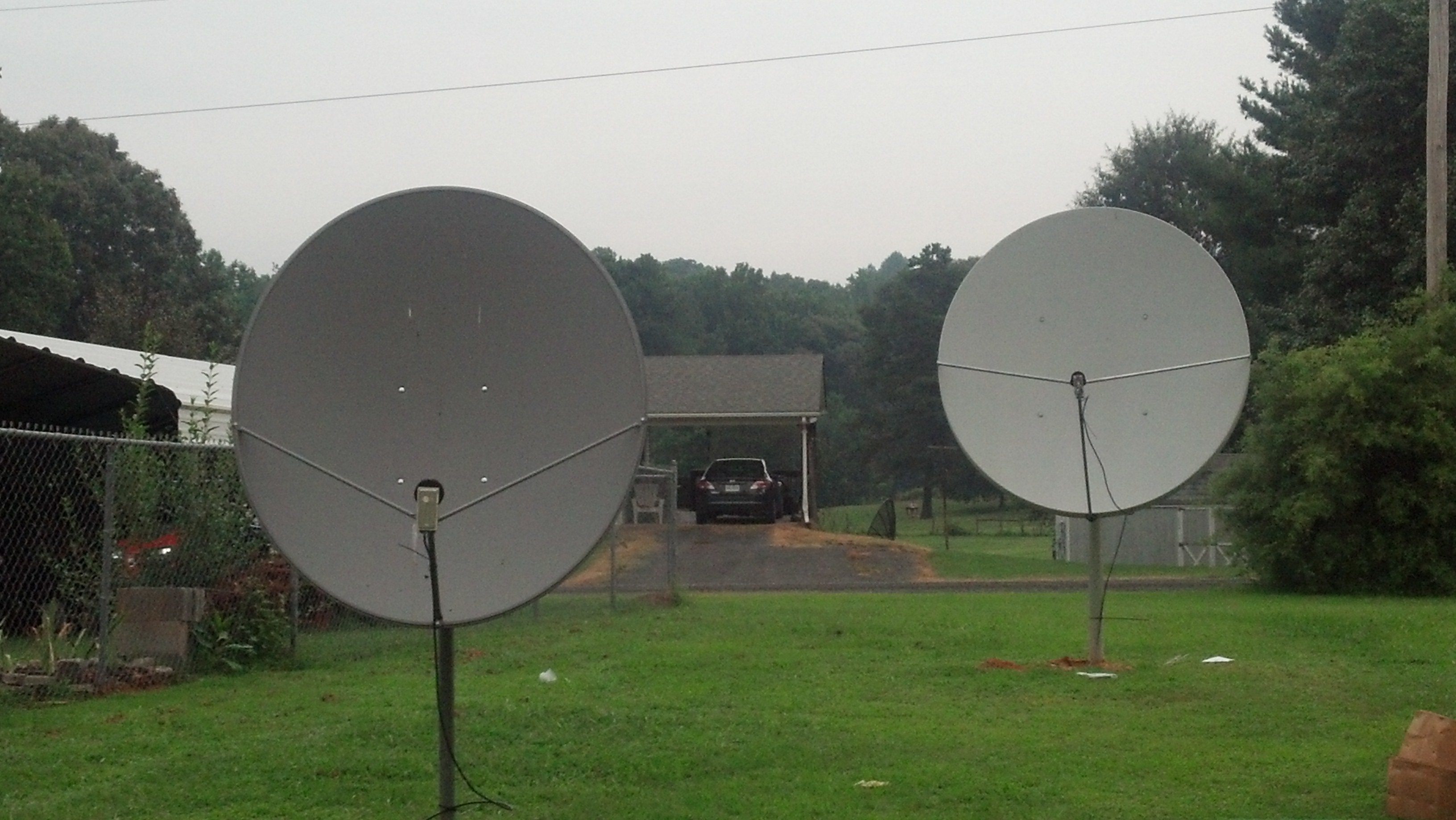

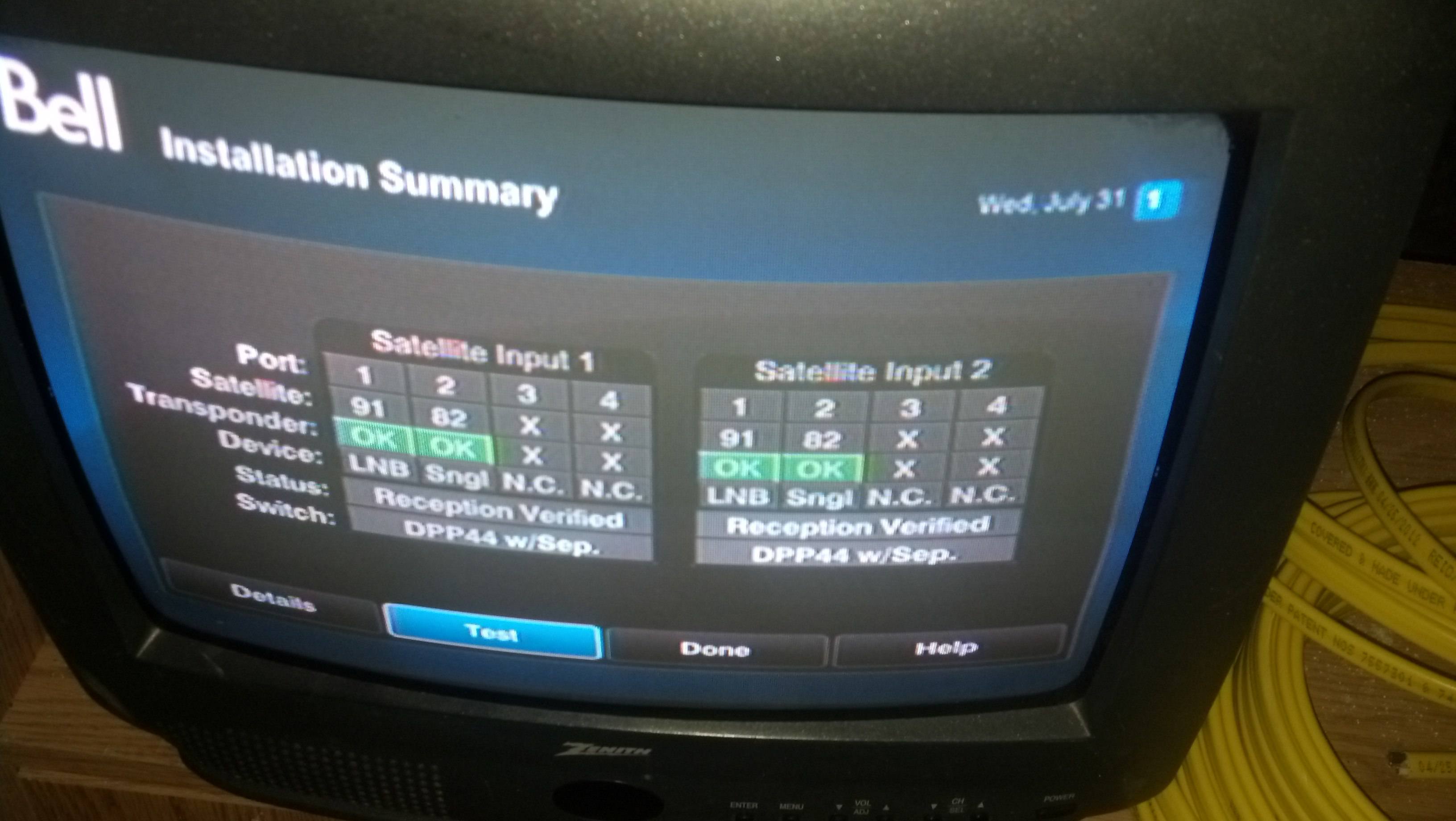

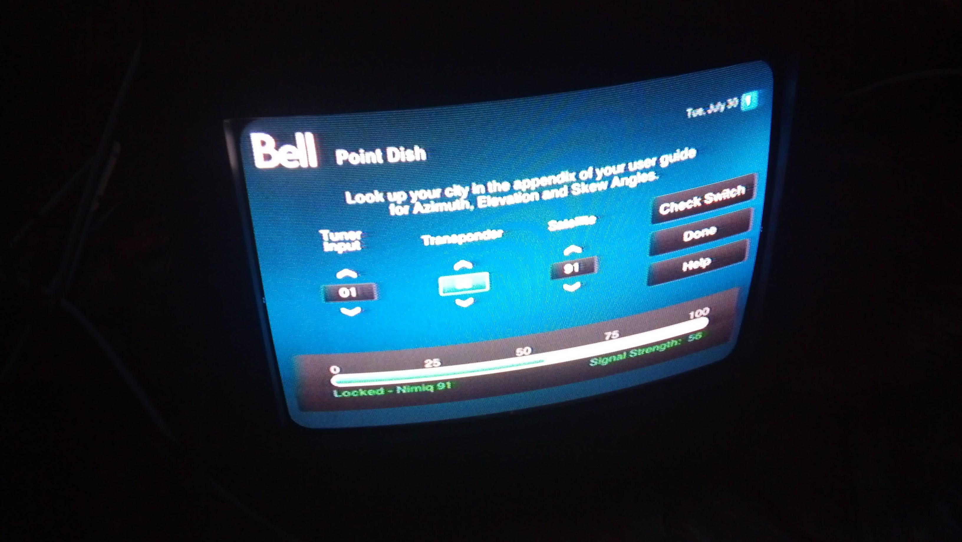

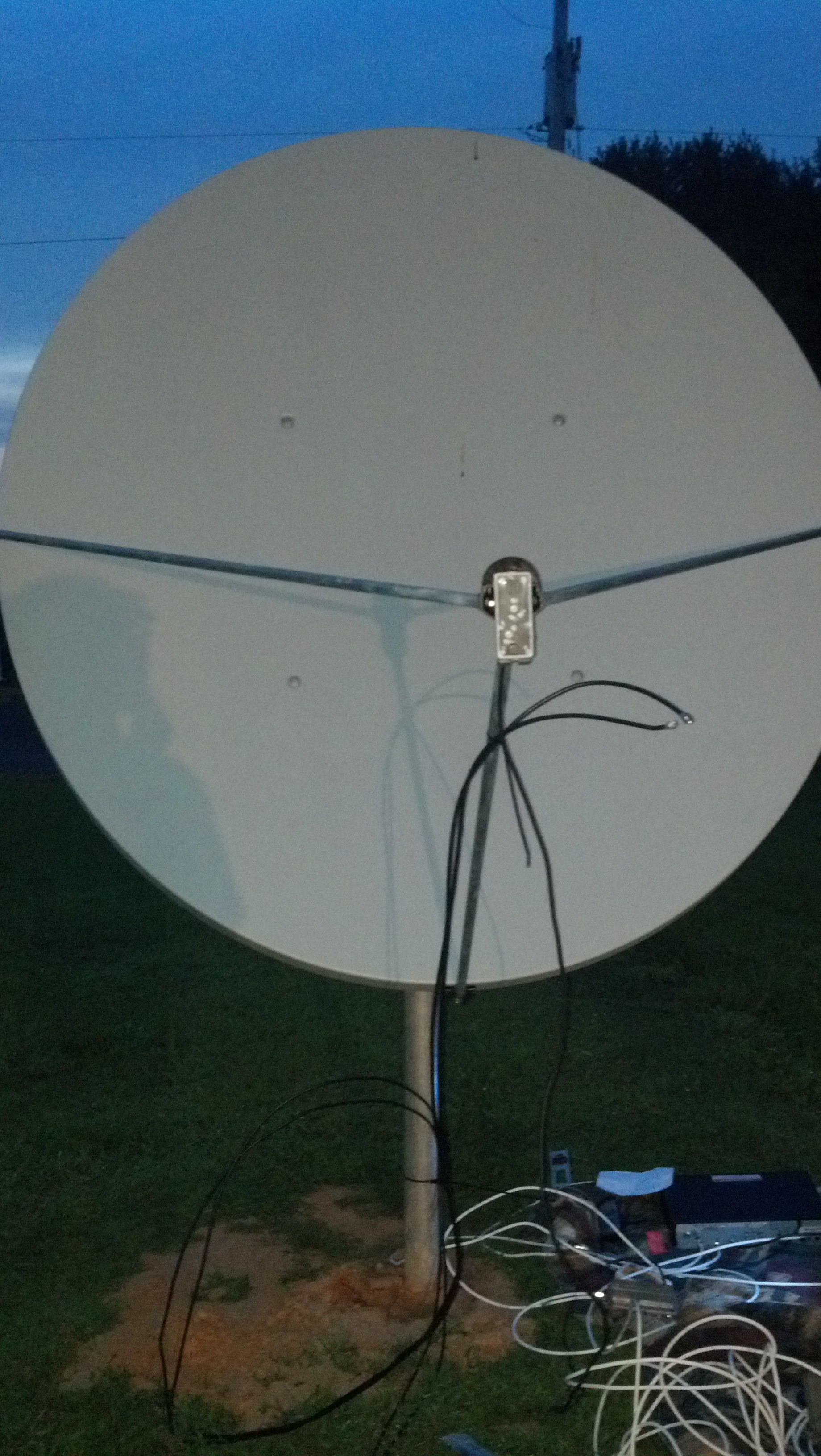

This makes no sense.. but there is cloud cover and my signal seems better! All transponders. Here are some pics of my test TV screen shots. I included a shot of 82 and a pic that includes both dishes. Just for the ones who said it was not possible! Just to clarify, I have 82 on the 4 footer.
In case someone would like to know how I got the DP LNBs to work...I broke the cases off 2 DP singles and wrapped the necks in duct tape before putting them into the LNB holder.
