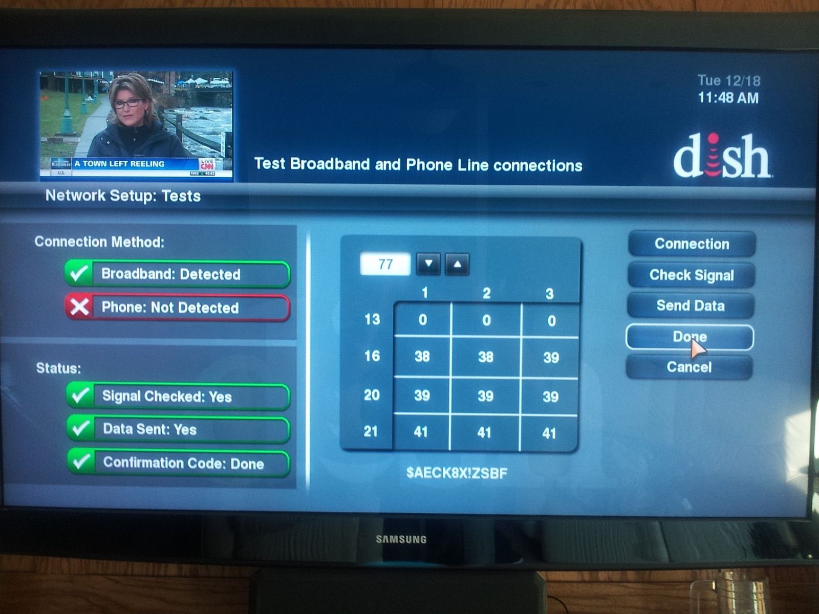

I hate to make assumptions, then run on to conclusions... But the Hopper has a connection to the Internet, this is known because MyDish account says I have a Broadband Connection on all devices, and the test screen shows a Broadband connection, and the receiver is able to successfully send test results data to someplace. I can access the receivers and delete recordings remotely via the android app.
It looks like DISH broke something along the way.
