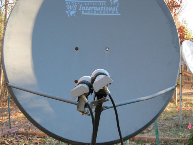

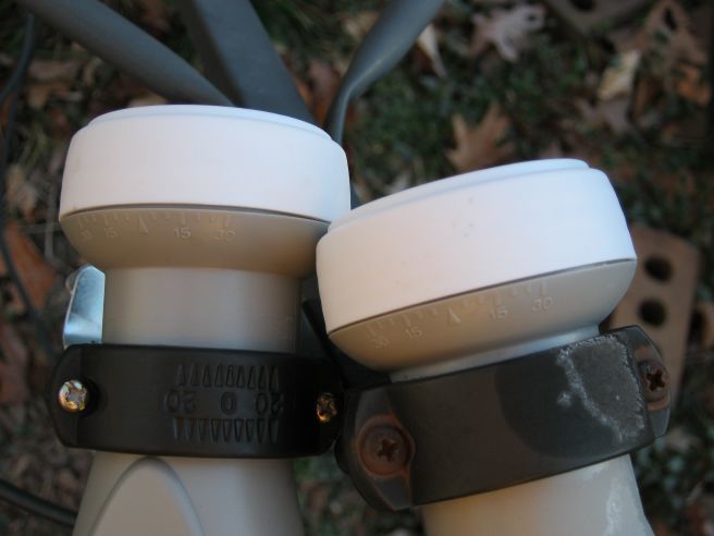

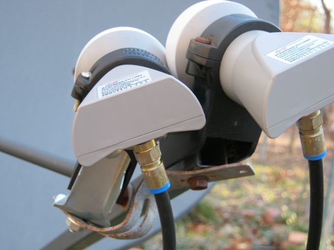

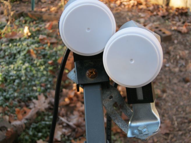

By the way, did you post a photo of your Dish / LNB configutation somewhere? It would be interesting to see how you put it together.
This is my first time to post images - hope they turn out ok.
(By the way, if you look closely at the support arms you will see that I bent them slightly to correct a minor error in the focal depth when I received the dish a couple of years ago. The focal depth for Anik F1R and F2 does not seem to be particularly sensitive, unlike most FTA satellites).
