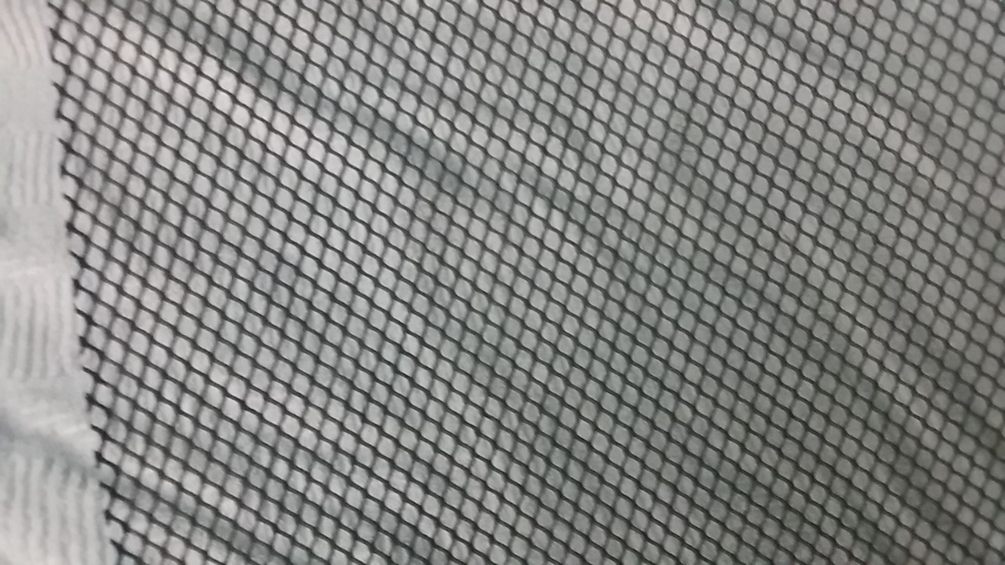

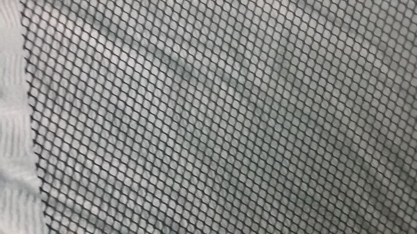

any other suggestions i have this dish gap panels
Be aware that Ku on a bud is not an easy task. Dish tuning and lnb quality is critical. Also an accurate positioner is a must. If you are just modifying a dish to receive Ku, you would be further ahead to get a decent Ku dish or replace the dish with one that is Ku capable.

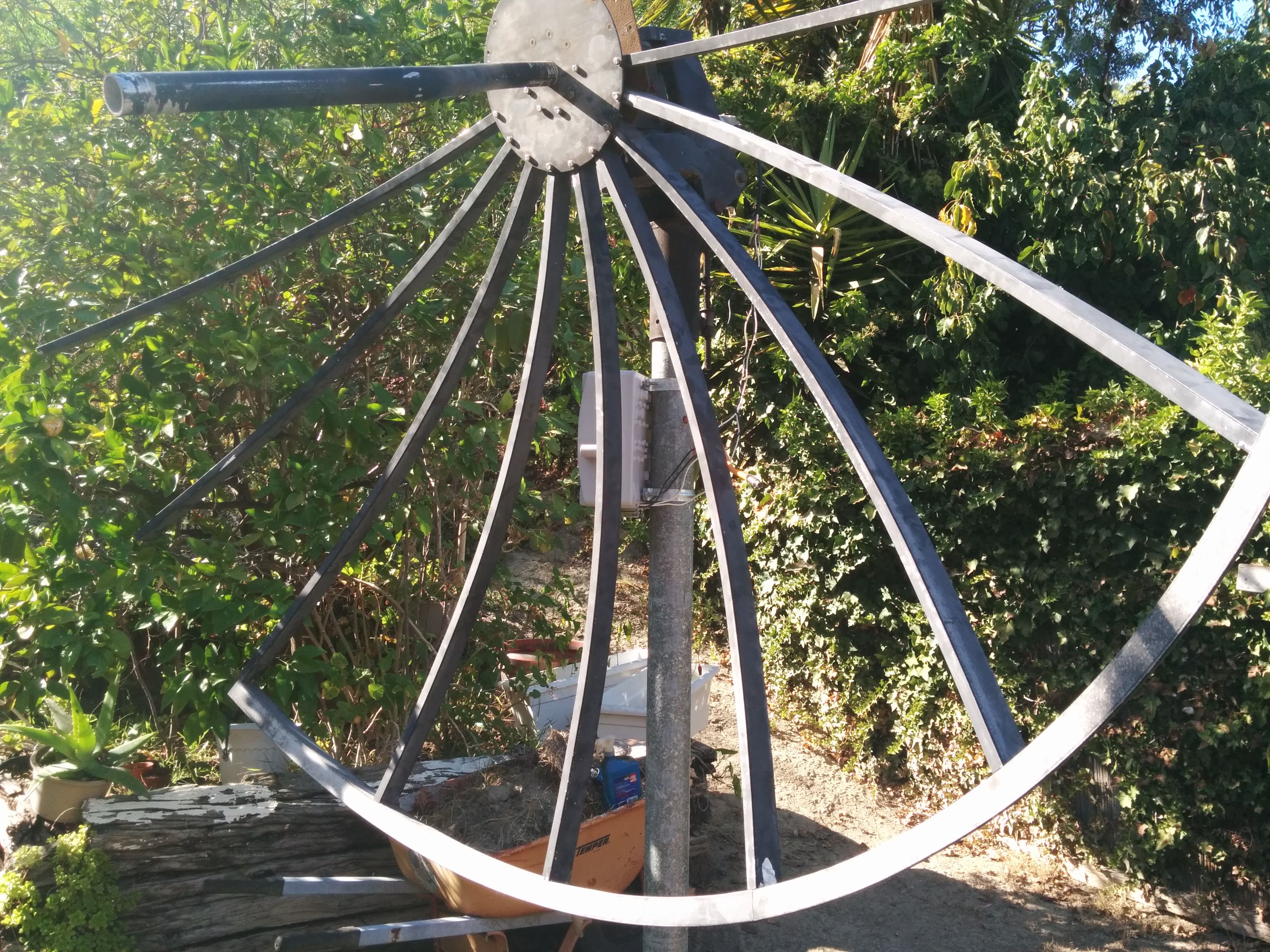

How old is your dish? Most dishes manufactured in the 1990's are Ku ready. Why Don't you post a pic of your dish. Lets see what you have. The pic you have posted shows a standard mesh that looks like it would work, though it is hard to tell from the pic. If it came with both a C and Ku lnb on the feedhorn, its most likely a tuning issue or a worn out Ku lnb.

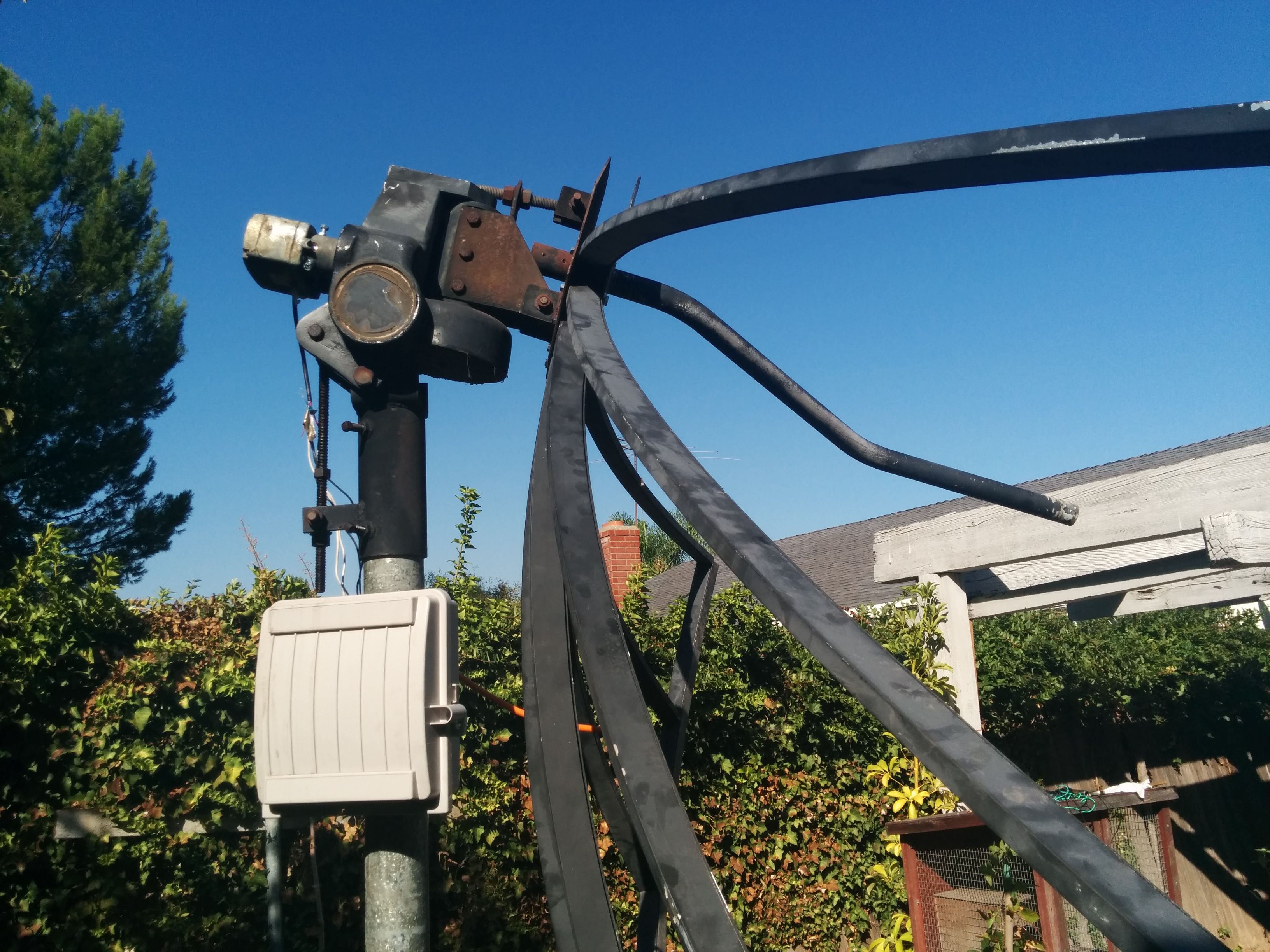

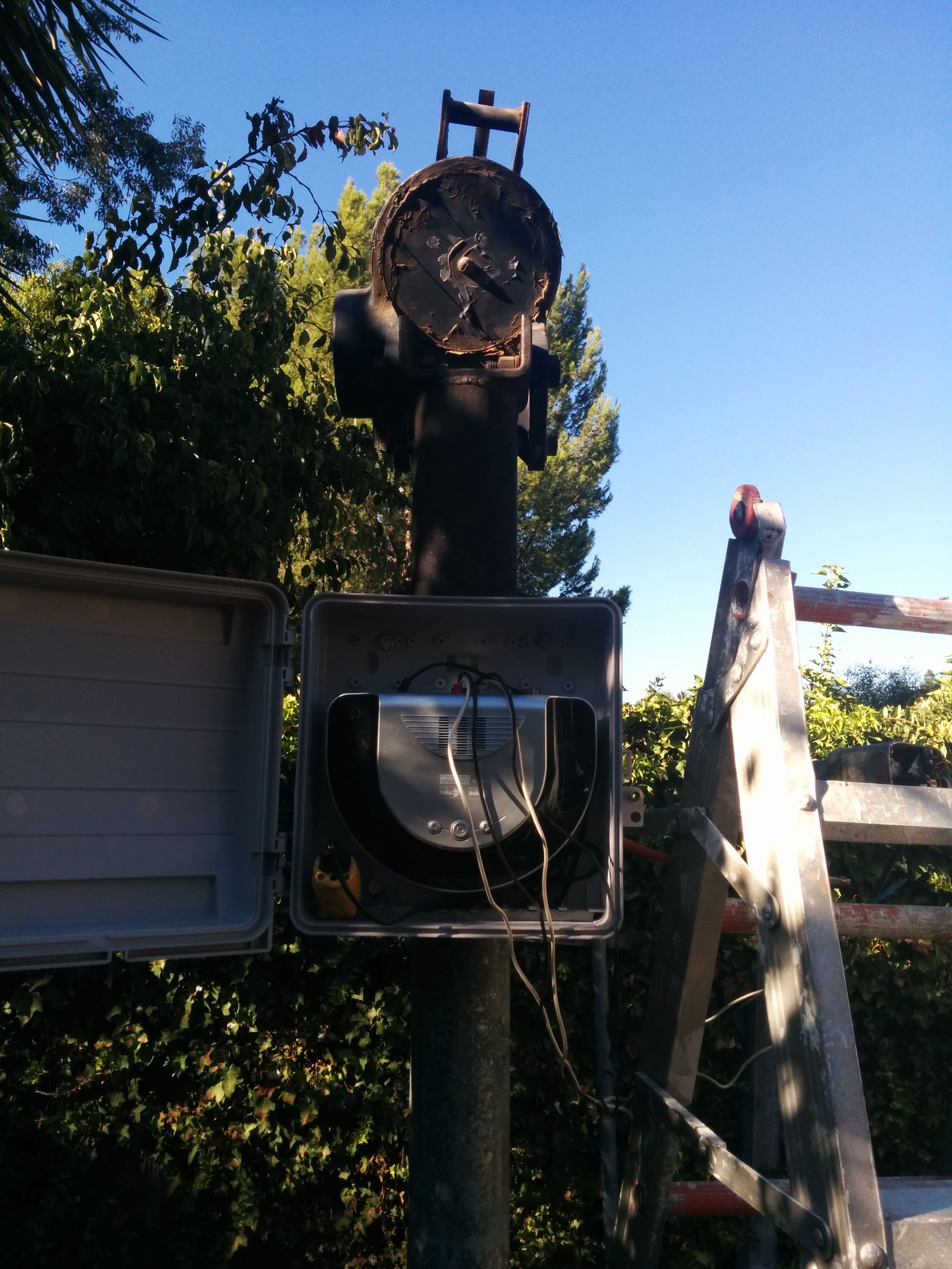

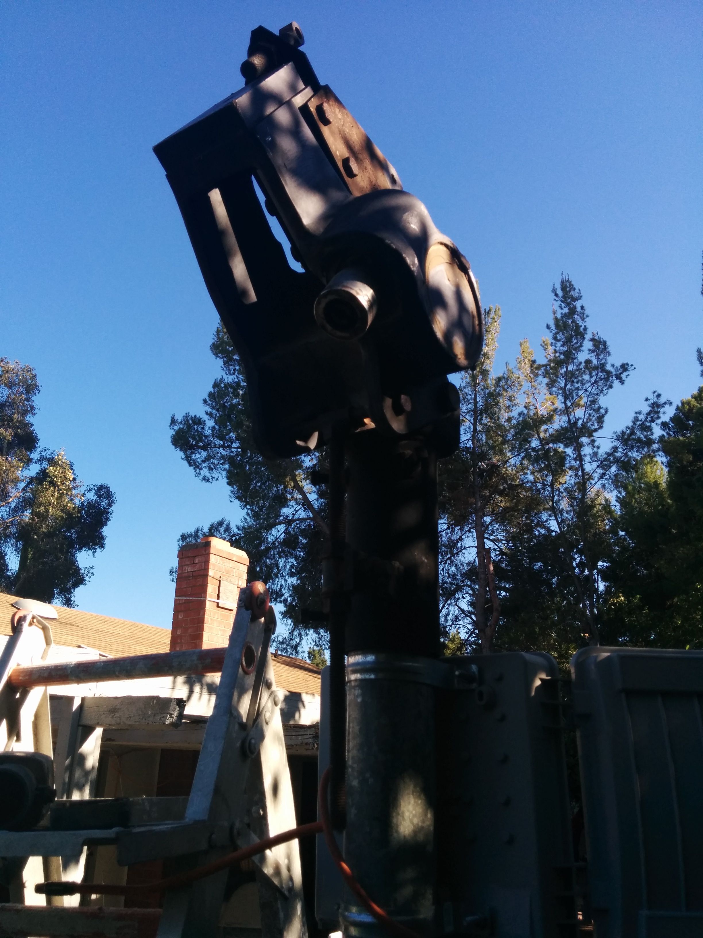

i only have three panels on right now when i decided i want to repaint it and do what i want
i stopped

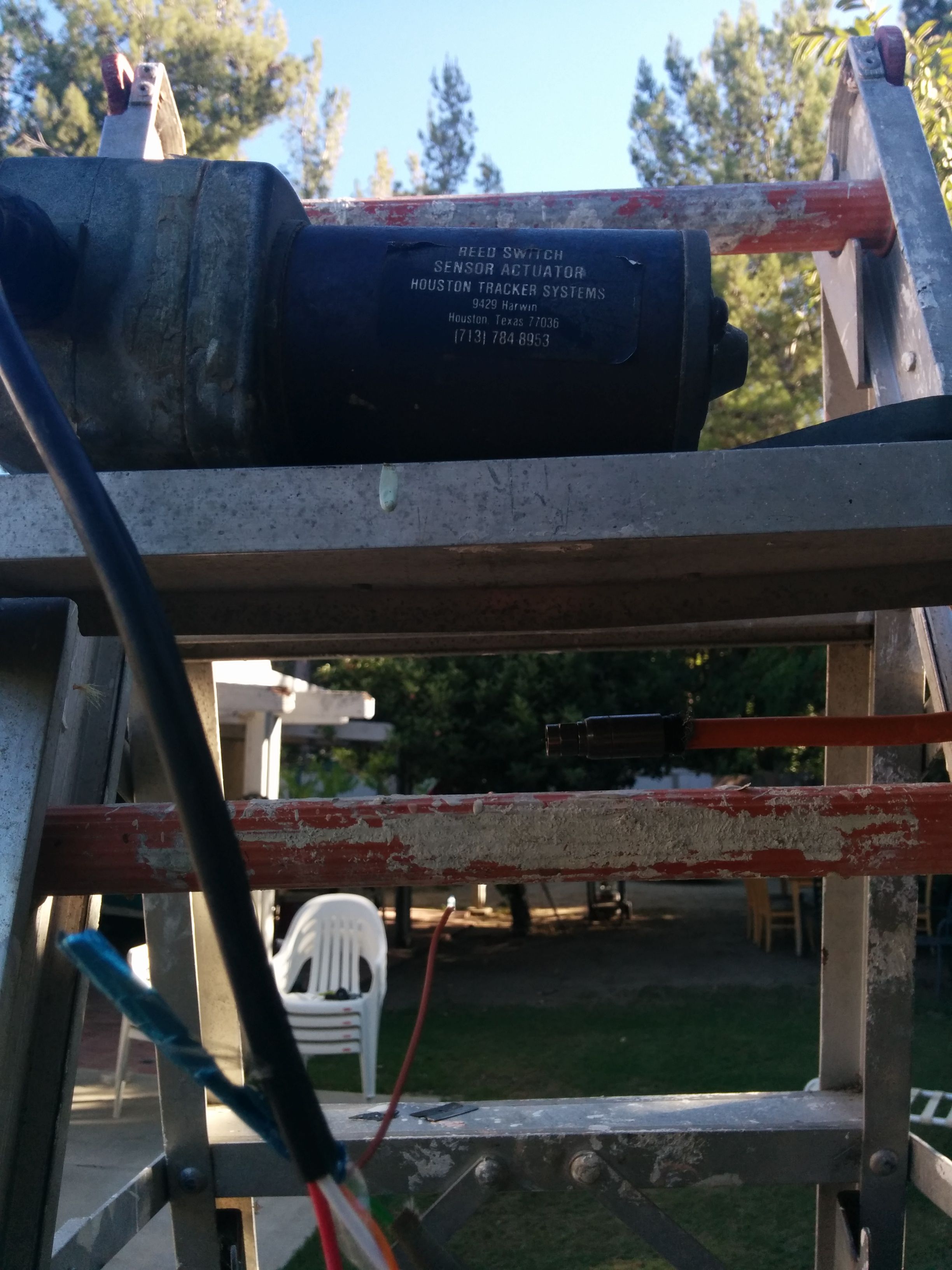

i also need a motor like this one where i can switch the gear inside better luck on that one i bet
i need it to be 38v
i will post up more pics tomorrow with three panels on wich was hard enough to get them on

The material that you show in your picture is called expanded metal, or expanded mesh. It should be available from metal retailers. It can be obtained in a variety of opening sizes and different materials. A note of caution; Make sure that you understand the dimensions of expanded metals. hey mention hol sizes and separation of the holes etc. In addition they also mention thickness of the material.
Reactions: Titanium
That is an old orbitron isn't it? Or raydex? Expanded qluminum is worth, what, 20.00? To me, i would use any material you want; and turn it into a solar hot water dispenser by aiming it at the sun; any steel will work, as well as aluminum, whatever (plastic with spray-on metal surface). When coated correctly! The item itself is already shaped to be used as a c band reflector; and as long as the shape stays with the dish, it can be used as a c band 10 foot satellite dish. ANY MATERIAL BETTER? YES! ALUMINUM of the same type will not interact with the existing aluminum's strength. It will not oxidize this way better; as the bolts should be aluminum welds!
