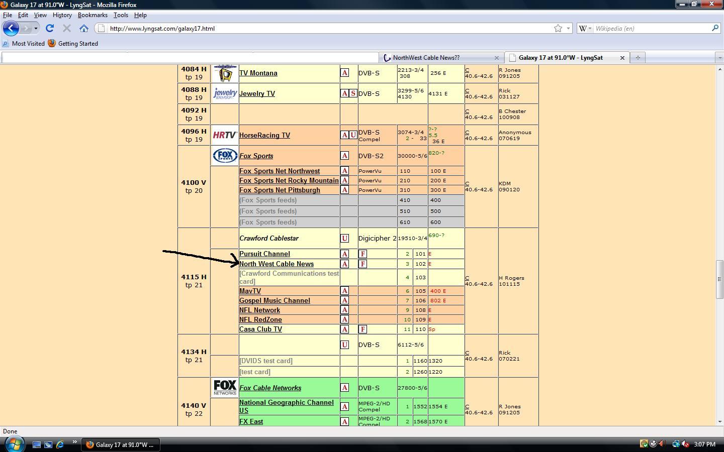

Its on 91W GB
http://www.lyngsat.com/galaxy17.html
4115 transponder.....I think you have to use generics to get it. I know its there as I picked it up with the Digitrans 7150. Volume is whacked (very distorted at normal volume)
4115 H 19510 or with generics CG 500-509

The version on GB is 19510 symbol rate. Its been there for a while. I dont know which channel # is is in the generic batch but on the 7150 its channel 3
