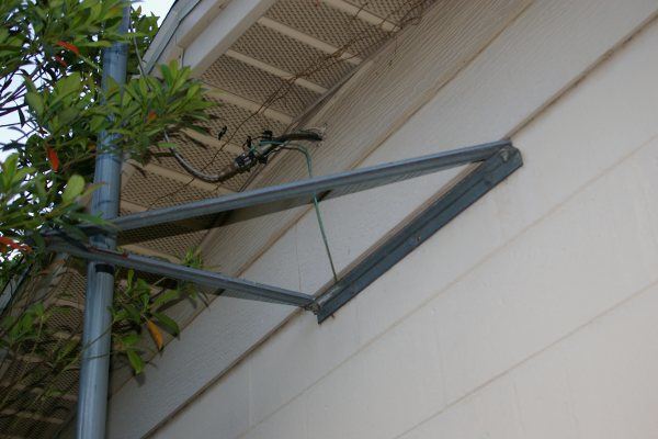

Hi, two of my FTA dishes are mounted on free standing masts and they can work quite well. Two more of my FTA dishes are mounted on masts that have a brace mounted to the wall and these work even better. See the picture for the brace details.
The only concerns with the free standing mast is it might move around a little with the hard freezes you get up in N.Y.

Thanks for the advice and forethought. It would be foolish not to wall-mount in this situation. I found this handsome piece of hardware on *Bay for $20. It's longer than the regular mast, is 1.66" and has braces. It should accommodate whatever dish comes my way.
