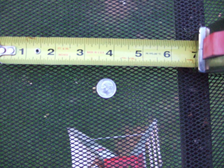

ok i have my old dish out in the yard its a 10 ft mesh odom
have the old 2410 and positioner ( switching out next week and retuning in the sat arc. now my questions . it has a lnbf don't know if its worth the effort or price to upgrade to receive ku.

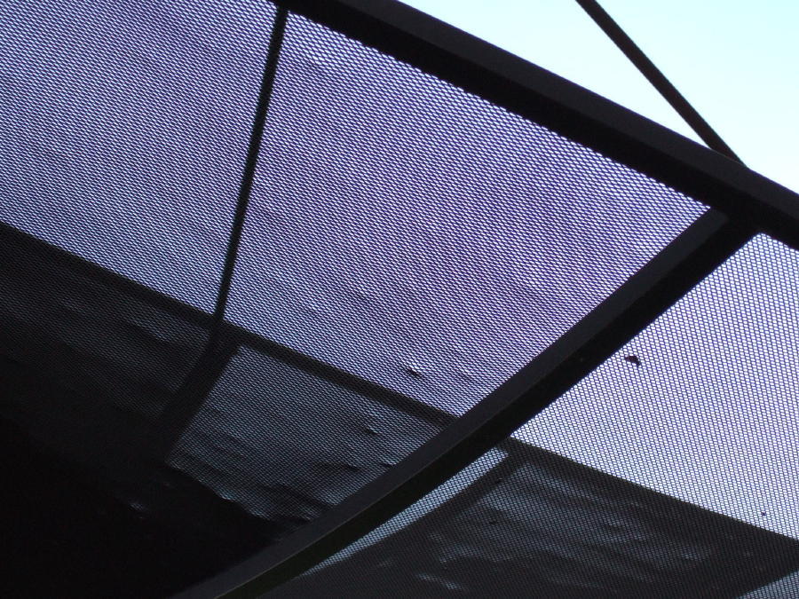

since this has never had ku (just the cal amp c31477 lnbf ) i'ld have to get a corotor or one of the new lnbf's with c & ku.
but my other concern is the dish has seen better days the mesh is probably diamond shaped about 1/8 in by 1/16 in hole, so its got a few hail dings and the mesh might not be tight enough for good ku reception.
here are a couple of pic one with a dime and other at angle so can see the dings
thanks for the input
