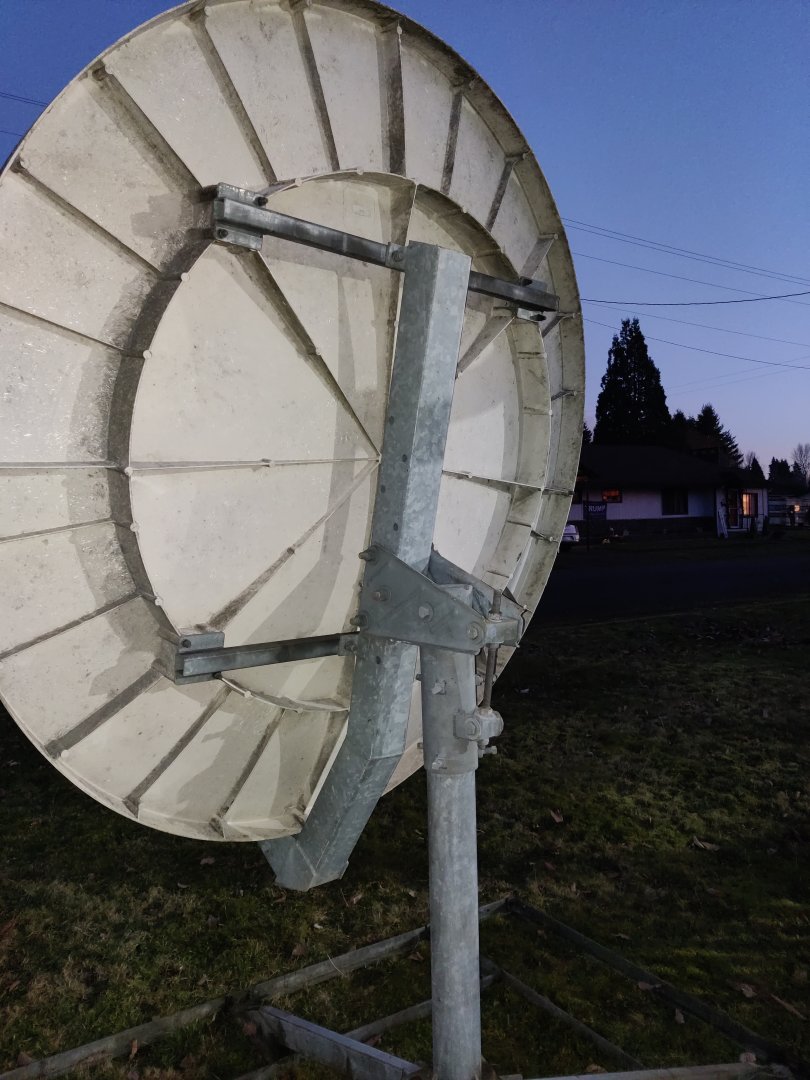

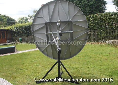

I just got a used fiberglass 8ft Offset dish. I had a 90CM Geosat KU dish with USALS Motor, which worked well till our most recent windstorm where it damaged the motor. I picked up this new to me dish and would like to motorize it. The LNB Mount is at a friends so that will be re-attached before end of month, I also have a C/KU LNB on order.
I got spoiled with the KU USALS, so I'm learning how to do it the more traditional way now. I am Washington State, USA so my arc is low in the West and peaks in the South East. I understand it's a DISEq 1.2 protocol for C Band Actuators. I assume I only need a singular Actuator, but this is where I am unsure. I read there's an Elevation Actuator or an Azimuth Actuator. Do I need both (which I would obviously need a different mount), and what's a recommended model?
That's a fixed Prodelin offset 8 foot dish for KU reception. There's NO motor beyond a old Ajak HH-180 drive that's capable of moving it. Those are REALLY rare motors to find, and you'll have to do some massive modification to adapt one, IF you could even find one. Also, you'll need a conical scalar to use that prime focus LNBF with an offset dish.
Good luck. I highly recommend you keep looking for a prime focus dish, and nothing smaller than 10 feet. You'll need it with the way everything is changing signalwise.
Does that mean that if I change out the arm/mount I'd still be stuck? I did notice it has holes for other LNB arms (my friend got the same model with a different LNB arm more similar to the Geosat Pro 90CM).
As for KU/C, my area recommends a 4-6 ft for most C Band according to Satbeams - World Of Satellites at your fingertips. I would prefer a 10ft+ prime focus, but there weren't any avail in my area for my price range at the moment, so I decided to start here.
The 8 ft dish might provide enough gain to receive the stronger DVB-S C-band signals, but not adequate to receive signals with higher FEC rates and modulations requiring a higher SIgnal to Noise Ratio (SNR). The minimum diameter for a 3 degree beamwidth is over 7 feet, any smaller diameter relector "sees" too much of the sky and unable to attenuate adjacent satellite signals from interferring. Larger reflectors will provide higher SNR agains't terrestrial interference such as 5G.
Agree with Primestar, it is a fantastic FIXED KU band dish. Not suitable for most C-band considering the labor and cost of materials to fabricate a motorized mount.

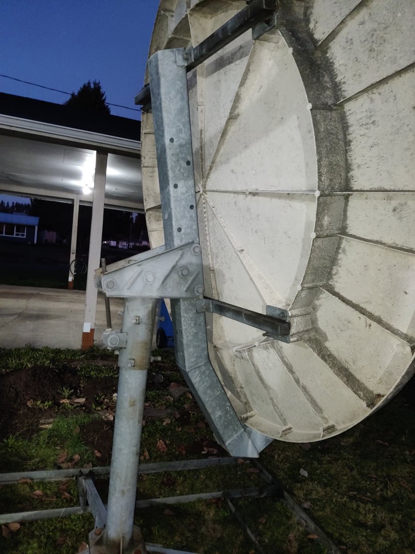

It'll likely work for the stronger stuff, IF you want to go to all the trouble to mount it as FIXED, on a single satellite. That's the easiest way to just get going. You'll never be able to mate it to a standard polar mount, as it's just too large and heavy. Also because it's offset, installing it on a polar mount meant for prime focus requires that the TOP of the dish to be tilted DOWN quite a bit. That puts a LOT of strain on a polar mount. I know for a fact that a Ajak HH-180 can be retrofitted, as there's a couple posters here that have done it. However, it takes a nice shop, and some real skills to do so.
I had one years ago that was the 6 foot version, and it was great for KU stuff. Just to give you an idea, that 6 foot Prodelin only gave 3dB more signal than a 39" Glorystar dish. Granted, that doubled the signal gain. So, I would assume that the 8 foot version would give another 3dB gain OVER the 6 foot version. Meaning, 6dB gain over a 39" ku dish.
My recommendation to find a prime focus dish stands. Check Craigslist, Facebook Marketplace, tell EVERYBODY you know that you are looking for one, etc. Try to find a MESH or metal spun dish, over an old fiberglass dish. Much easier to deal with in everyway. The early prime focus fiberglass dishes weren't meant for todays type of satellite signal reception, and it can be hard to tell if one is worth bothering with, unless you've been around at least 30-40 years of paying attention to the whole market.
I could be mistaken, but that sure looks like a 1.8 Prodelin which would be around 6 feet.
I agree, that one has the same model number as my Prodelin 1.8.

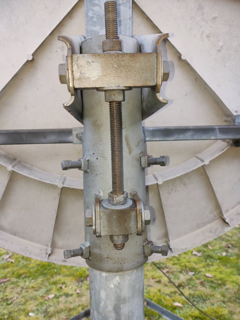

Seeing as for the time being this dish is my only option. phlatwound can you tell me how to work the elevation bolt? I noticed it has 4 nuts, one set per section. Do I need to loosen all 4 for the movement or just the top set (fun part of this whole dish is all the bolts are rusted or frozen in place so far)? It seems like the bottom set is for mast counterweight attachment.
Yes, I would just use the top set to adjust the elevation.
And those bolts may need a little penetrant, percussive maintenance or heat (in extreme cases) but they look to be in excellent condition, would be really surprised if they gave you much trouble.
Reactions: FTA4PA
Yeah using that bottom jam nut pair as an adjustment might make the all thread poke the pole mount. So top it is then.

It's a nice dish, definitely worth playing with, even on C-band, while understanding its limitations. I read earlier that you ordered a C/Ku LNBF. Just be aware that in most cases, those are ok on C-band but can be very mediocre on Ku. So you might want to also get a Ku-only LNBF (it's cheap) and try it to see the difference. I would suggets that before you spend time on trying to motorize the dish, you use it as is and try to find all the satellites. It's a great way of learning as you go and you will then also get an idea of what it's capable of on C-band.
I actually have a Channel Master 1.80m fiberglass offset and an AJAK H_H motor and am working on making them work together. Definitely a bit of a challenge!

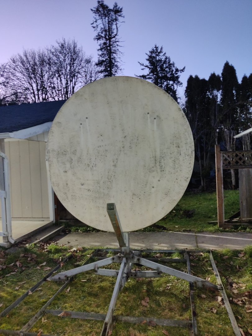

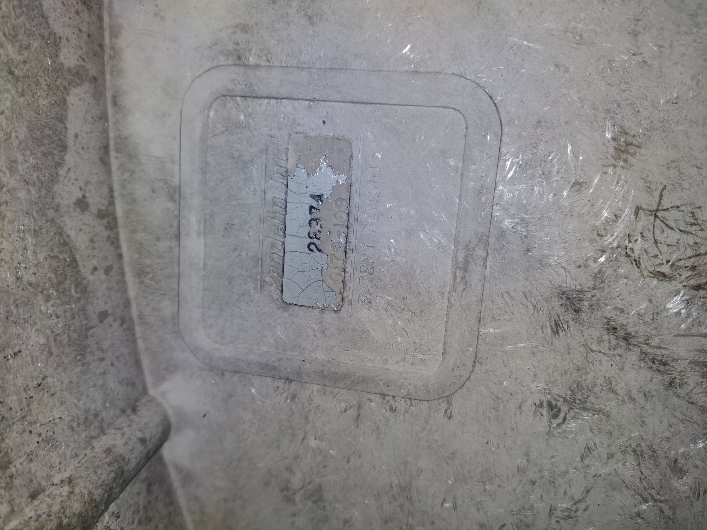

I finally decided to measure, yes it was a 1.8m (which tells me the seller couldn't measure and the mesh they have will prob be a 1.8m if lucky a 2.0m since they "guesstimated" 8' again). I'm curious, if I obtain a mount like this
And I drill my own holes then repair the porcelain with fiberglass mesh and whatnot, would that work? I'm just thinking of what I can do to make do with what I have and minor changes.
My 2 cents. Good thing I'm not in Canada or it would cost ya' almost 3.
A bit of confusion. I read 8 foot. And then 1.8 meters. An 8 footer would give a far better wow factor than a1.8 (close to 6 foot) dish.
Way way back in the satguys archives there is a manual for a 1.8m Prodelin.
"Ceramic"? What ceramic? Fiberglass repair kits were almost a must have when snowmobiles had 'glass bonnets. But that T-boned 'vette in the intersection in Tarpon Springs one day. Forget about it. Fiberglass repairs, if done right, are strong as factory. Invest in a little bit of CF mesh if you really want a strong fix.
The photo above shows a polar mount with motorized declination. You really don't need that. Really.
Your receiver will not power a trailer jack style linear actuator. So you'll need a way to run it. An old receiver like an old Digicipher, one of the cheapest old eBay dish movers with a counter and E-W buttons. And a ring binder to write down encoder counts for each satellite.
Or get one of the vbox movers. I'm taking it you want to get this going as cheap as possible. Probably the bare minimum.
Oh. And cable too. 2 conductor to run the motor. And 2 conductor with shield for the sensor. Probably some sched. 20-40 PVC pipe to run it in.

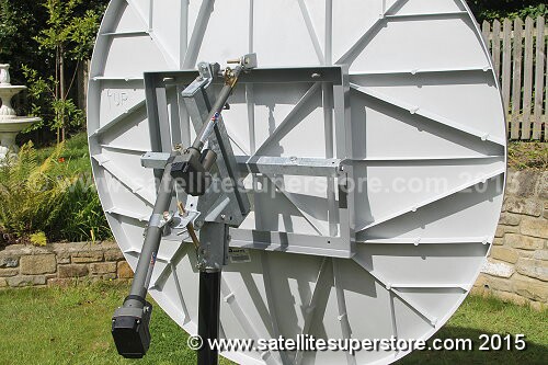

The mount in your picture looks pretty robust. As opposed to the attached pdf from here:
Far spaced azimuth pivots will minimize slop in the mount.
