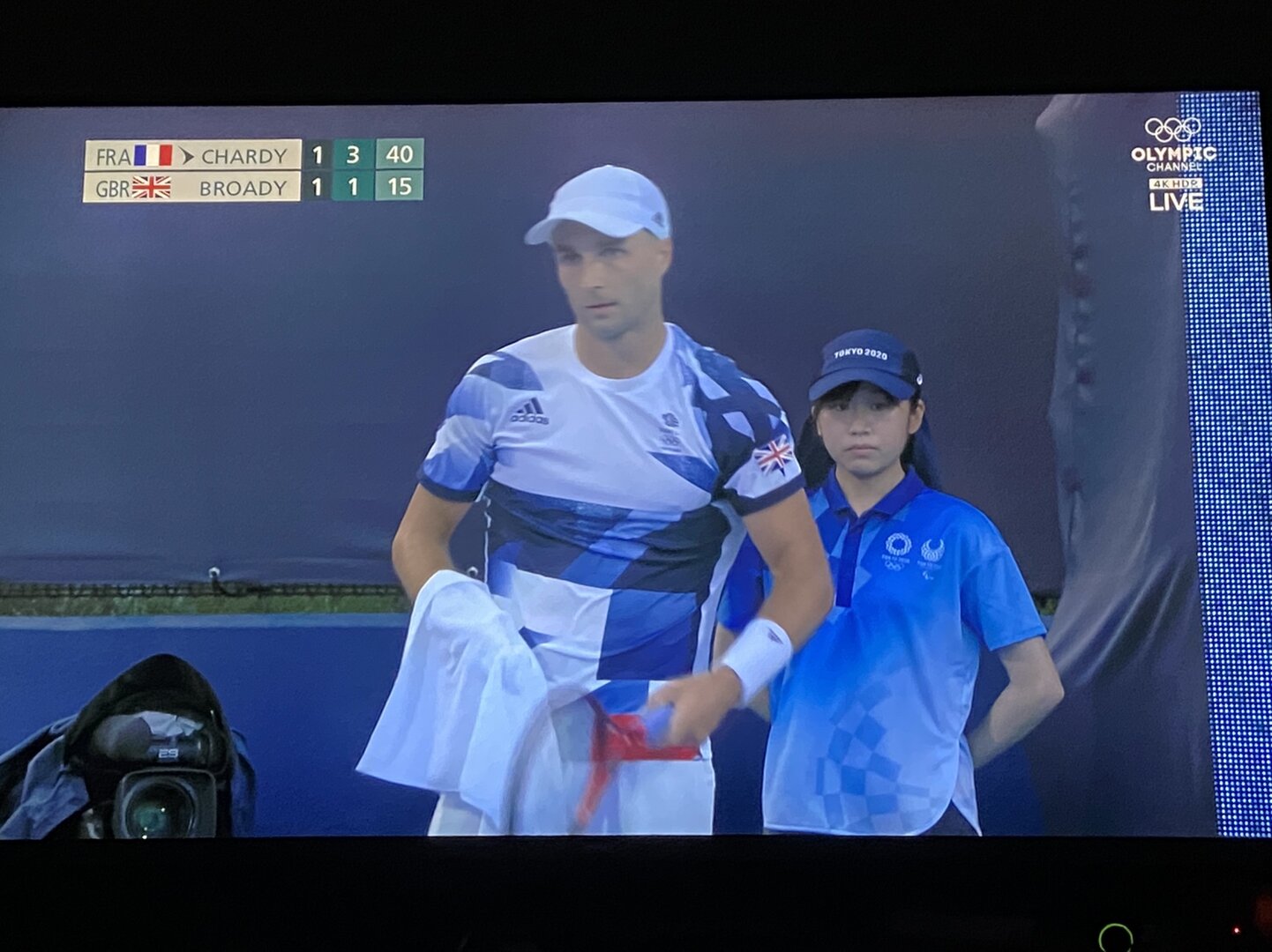

This is what the Tennis looked like this morning at 4 am on DISH in 4K HDR. View attachment 152840
While one picture does not tell the whole story, looks kind of murky, like the fine detail is washed out, what are your settings and what kind of TV?
Mine was a TCL 85" 7 Series.
TCL series 6 - 65 inch.

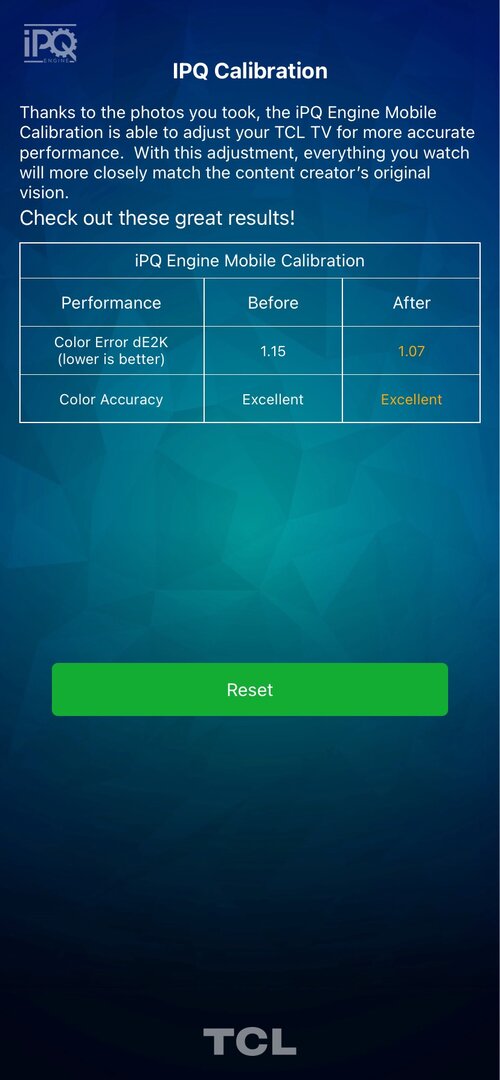

I even calibrated it with the IPQ app just to make sure my setting were good. Yup I did it at 4 in the morning lol!

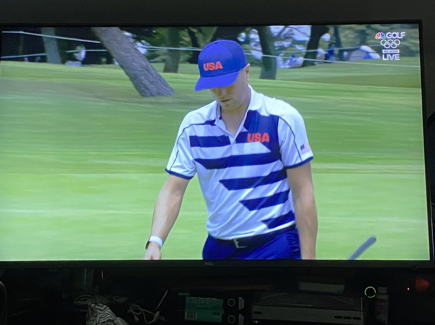

I figured out my 4K HDR picture issue on my TCL Series 6 TV.
I pressed * on my remote and it show I was set to HDR Dark. I changed it to HDR Normal, and the picture is a LOT better now.
Watching 4K Golf now and the grass is GREEN. :D. Not the best quality 4K I have seen, but considering its upscaled 1080p its not that bad.

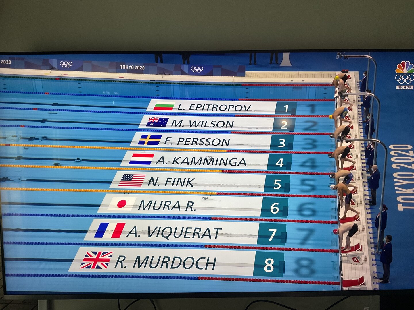

here is another, swimming is on right now-
I'm not in front of my Hopper 3, did the swimming show up in the Guide?
Where did you read it's upscaled 1080p?
That was on YTTV, they are showing a lot more content from the Olympics then Dish.
Yep-
